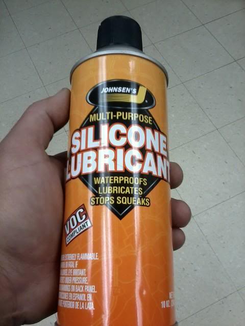

Im not familiar with the window circuit, but on the manual windows, the tracks can get really dry and make hard to roll up. Might try lubing them up with the Silicon Spray. It makes a world of difference. I am wondering if your motor is just having to work so hard to ru it up and down.

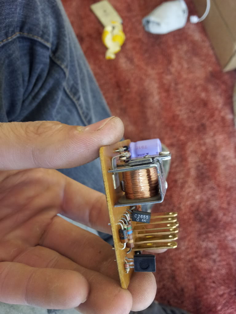

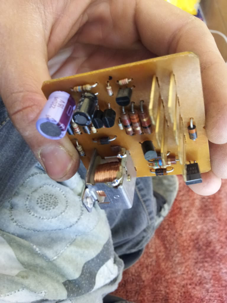

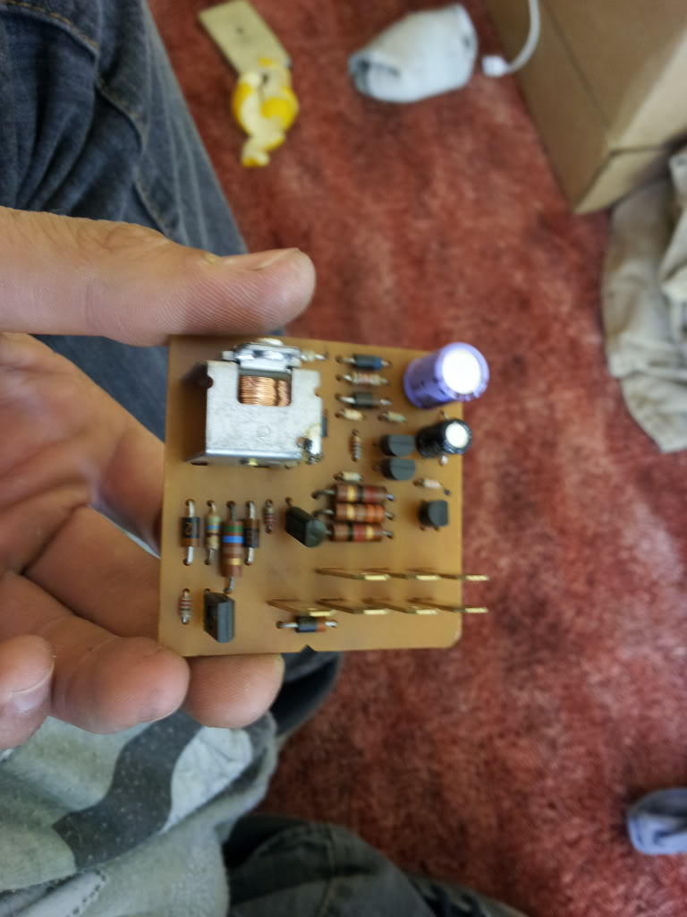

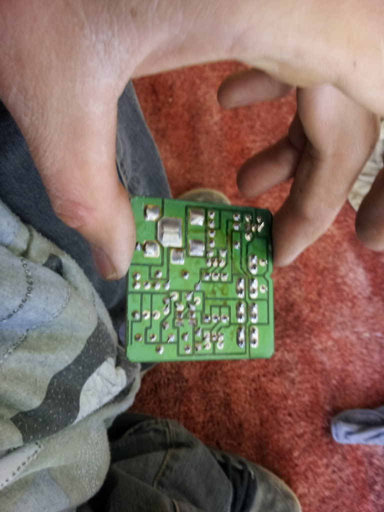

i think i found it. going to try and take it out right now. im assuming its bolted up
Old 09-20-2011, 02:21 PM
RHDskyline's Avatar
Join Date: Aug 2011
Posts: 11
Received 0 Likes on 0 Posts
everything looks clean and good inside. this was the only black box by the clutch petal. exactly as you described. is there some simple stuff i can check
like if the master switch on drivers side is shot. will the passenger one still work?

thats not what my door control module circuit board looks like. I wonder if they changed it. mine has a molex style connector that connects to one end of the board. you have spade connector terminals. interesting. also mine was not bolted in, it snaps onto a bracket.
