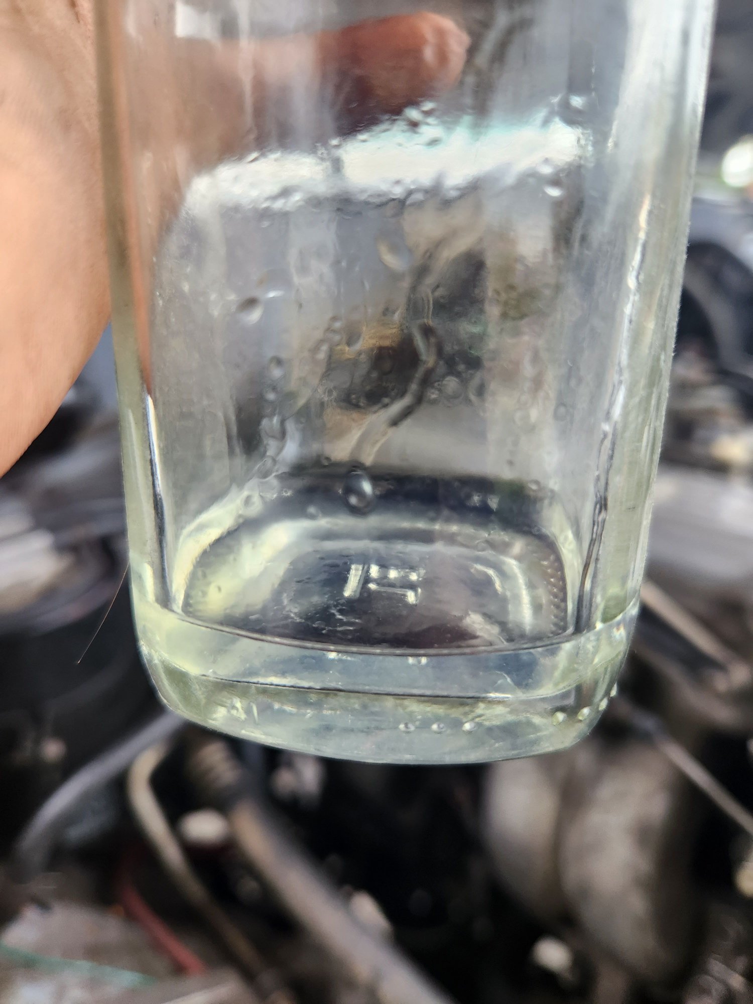

pull the low pressure fuel return hose, from the FPR, where the hose connects to the hard line on the firewall. stick the end in a suitable container (or just stick a longer hose on the outlet of the FPR) and crank the engine with the starter for 5 seconds. check for fuel in the container.
Performed this quick test. I have fuel coming though the return line. I'm open to all suggestions here
