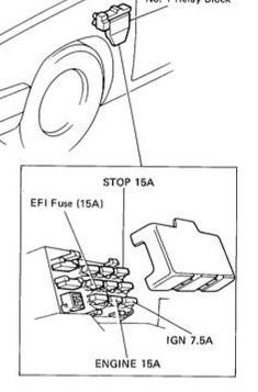

where is the EFi main located?

In the fuse block inside the cab, behind the driver's side kick panel. Middle fuse down, farthest rearward column. See picture below...
Does this help?
