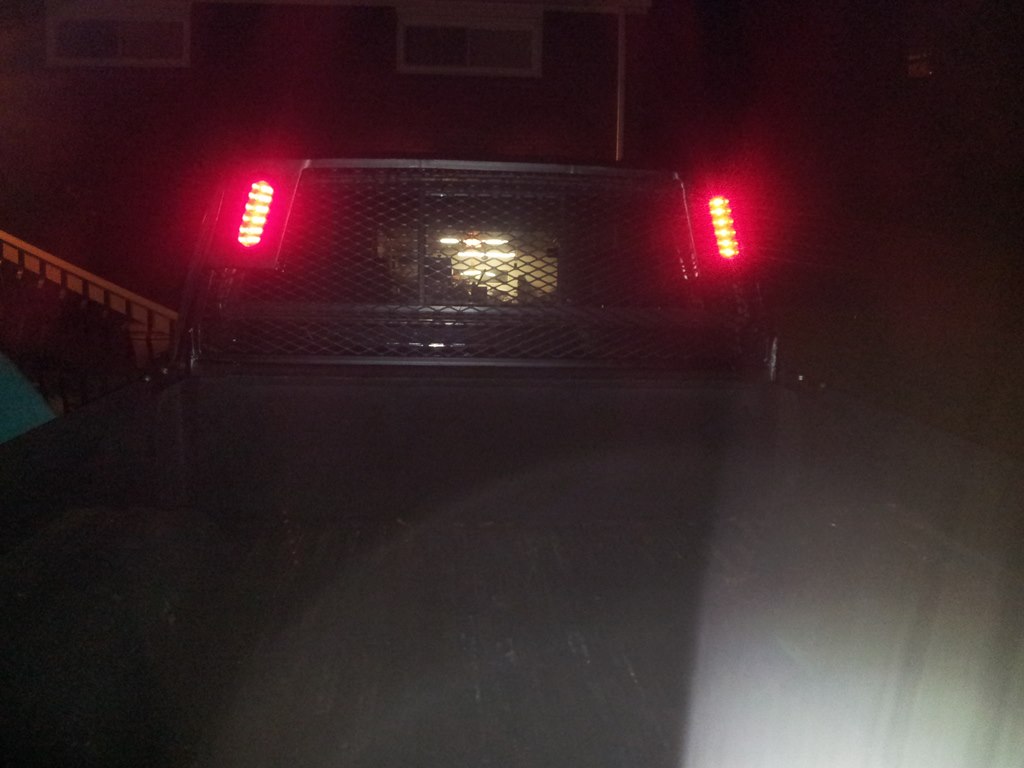

Response
Thanks for the comments. I finished it this past weekend and drove it for the first time yesterday. Does not obstruct vision too much - a little bit in the dark as my rear window is tinted and reflects the radio and dash light. I took a quick picture to show what the blanks were for - cut out 6" ovals for DOT LED tail / stop lights. Wired them in with trailer hitch connectors so it is removable after snipping a few wire ties. Used 8FT of heat shrink tubing after twisting the wires up so they will last a few years. Used JB Weld to clean up some of my ugly welds although I rushed through the paint job and had some runs - not sure yet of the durability of VHT chassis / rollbar paint. I'll post some better pictures soon.
