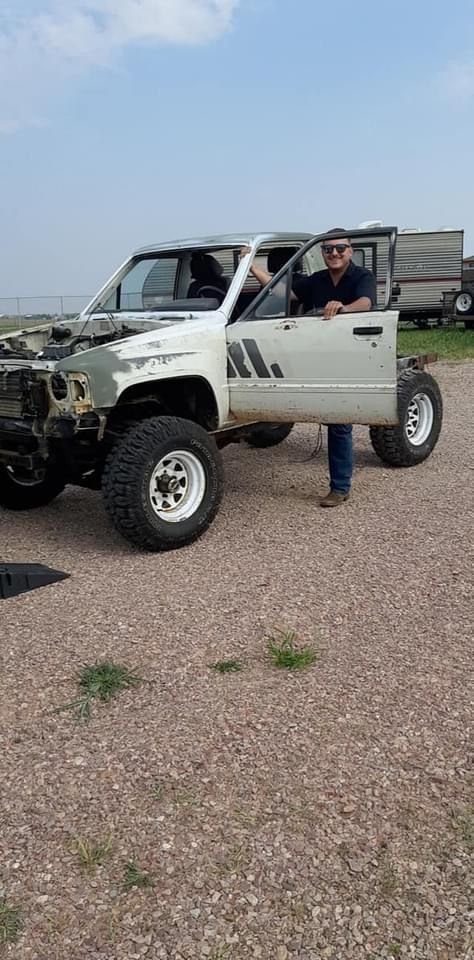

Alright guys so over a year ago I started my restomod for a 1986 Toyota pickup that I bought for $600. I have since posted a few threads about it but this will be my ACTUAL build thread.
I am going to throw up a lot of pictures from throughout the build along with a list of everything that's been done, and everything I still plan on doing. So far this is what has been done,
Engine fully rebuilt
Emissions delete from LCE
Weber carb install
new fuel tank installed
Inline pump installed since the original in tank puts out too much pressure
Aux fuse block wired in
BMW seats installed
Rust around windshield cleaned and metal replaced

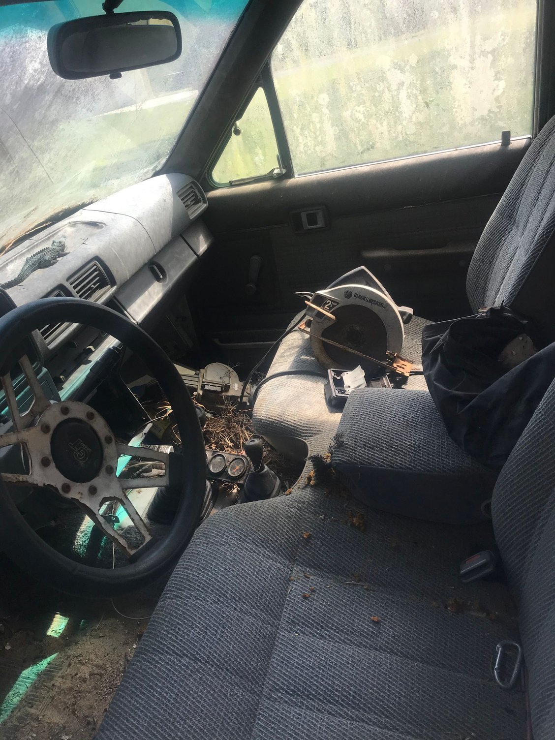

interior gutted for cleaning/ mouse removal
What still remains-
paint/ bedliner
building a flatbed for it
interior paint/center console build
aftermarket electric locks
fixing all of the gauges as they do not currently function

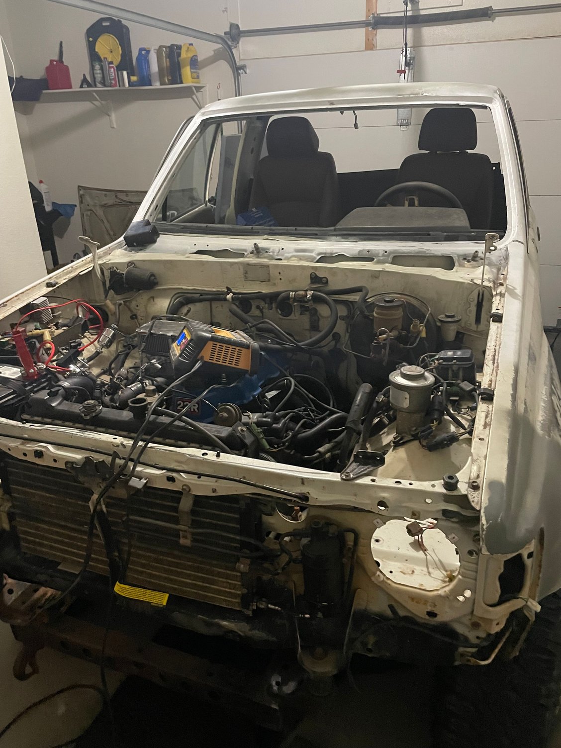

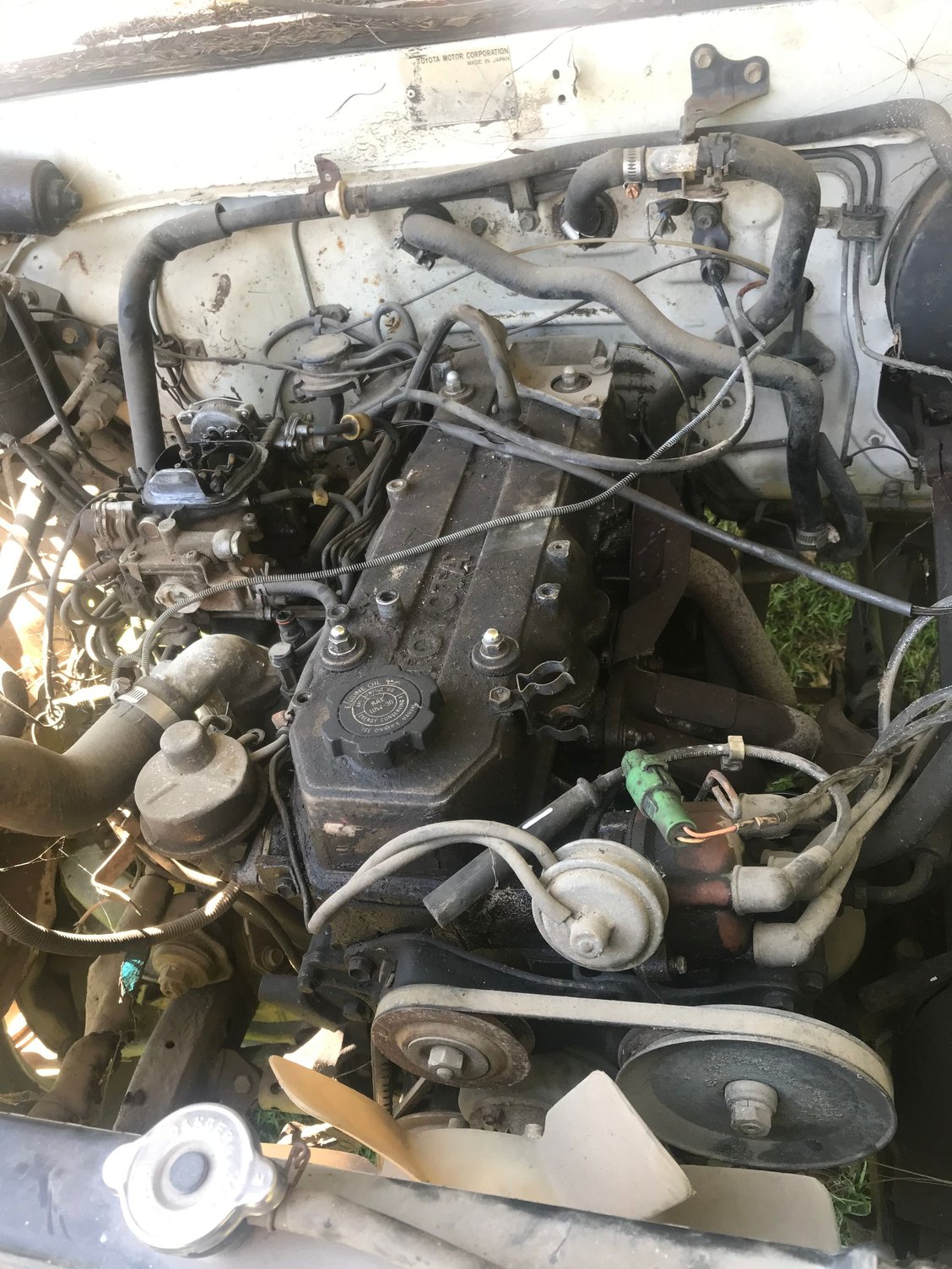

So, it has come to my realization that this truck was orginally a 22re that was swapped to a carb. Now I am running into the issue of cleaning up the wiring harness that is currently TRASHED and cannot find any good wiring diagrams. I have trimmed down most of it but there is still plenty to go. if anyone has accurate wiring diagrams or maybe a 22re to 22r write up I would love a link to it.
in the meantime heres beginning to now pictures.

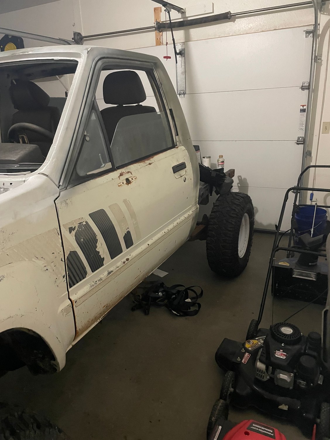

Updating from the work I finshed up today. Had to weld on a muffler (cheapy 21 bucks from fleetfarm) and wired up the BMW seats. Thats 3 spots filled up on my AUX fuse box now so I am debating putting in a larger one in the future. Hopefully by the end of this week weather permitting ill be able to paint all of the interior pieces i removed black to cover up the years of dog hunting this truck has seen. Will post pictures when thats all put in!
