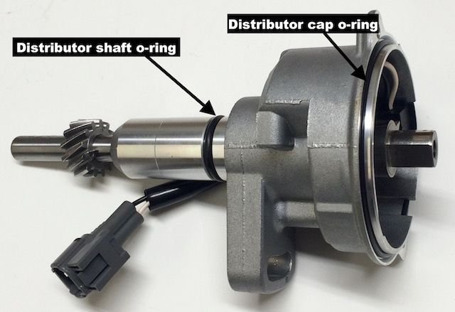

Distributor getting wet. If it is original distributor, the cap o-ring is probably rotten.

[=snippits;52419038]Distributor getting wet. If it is original distributor, the cap o-ring is probably rotten.
I replaced the distributor 4 months back but I will definitely check it when this rain slacks off , it didn’t even cross my mind since it still has the rubber guard around it , I’m also pretty certain I put dielectric grease on all the plug ends on both sides

It doesn't have to be wet it's amazing how little moisture can make it Miss... great advice from above

dist cap o-ring 90099-14090
dist shaft o-ring 19127-15021
for a '92, but prob same as 86?
