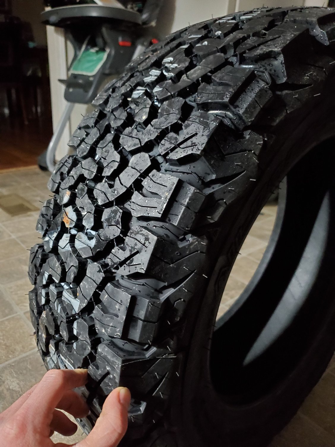

I have an 80 model 2wd with 16x8 20mm+ offset mst mt-01 bronze rims and 1 inch wheel spacers with bfgoodrich k02 tires sized at 215/65/16 and they only rub if i'm turning hard and hit a bump or flex the front suspension. But for every day driving on the road it looks great and rides great and has almost no road noise !!​​​​​​​

Doing the same setup with 215/70/16 hopefully it fits

Needed a bit of help with my setup! I’m running the same rims with the 73.1 bore on my 89 pickup and it doesn’t fit over in the front. Is the 1 inch spacer necessary to push it off the hub?
