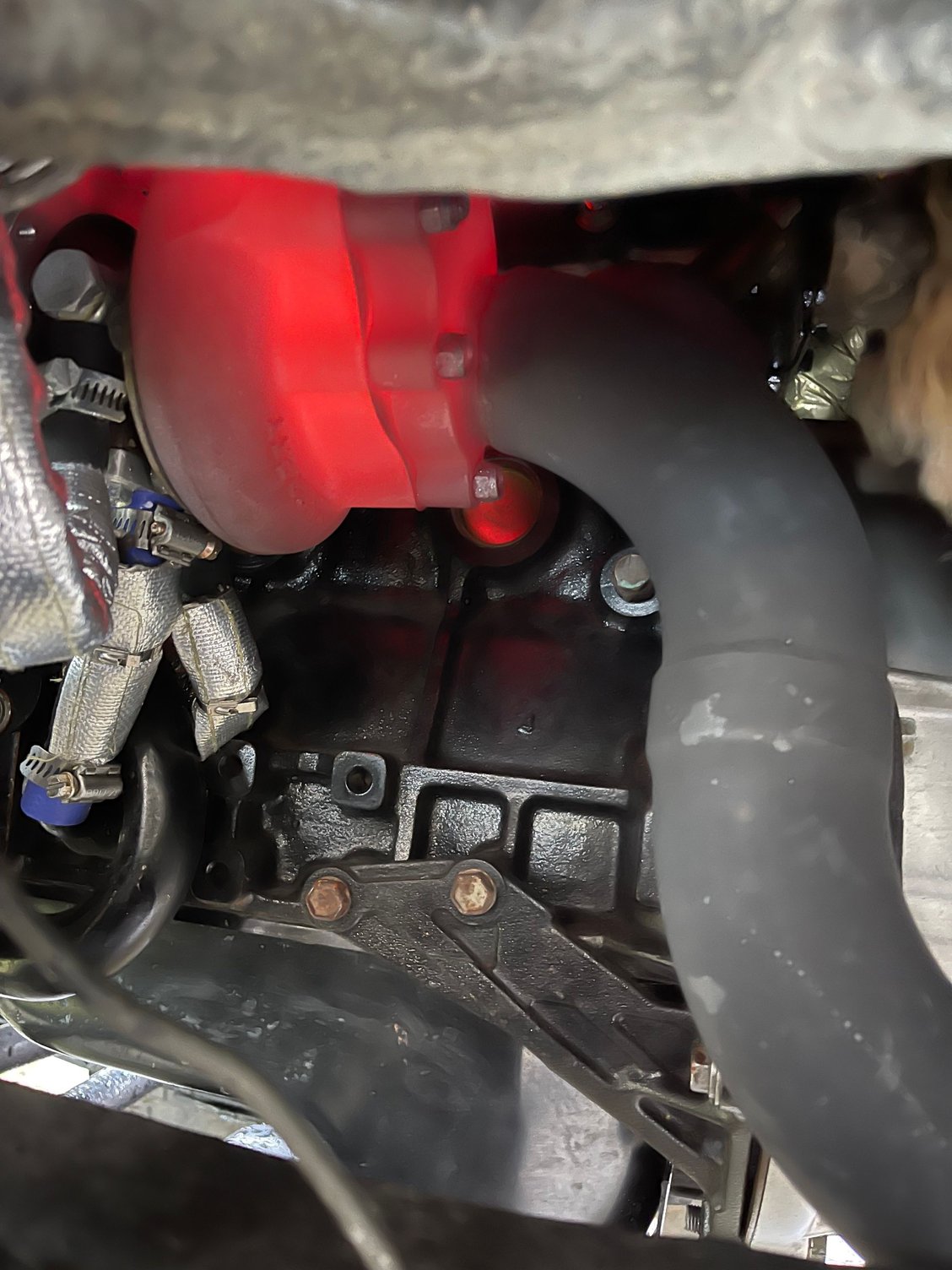

hello I’m having the same issue with my 20 over rte truck same a rebuilt engine damn near everything new also have a lce turbo kit with a gt25r turbo my turbo is red hot on a regular drive down the road every one is saying it’s lean any way you fixed your issue I’m buying a wide band so I can get a reading just curious if you figured it out
