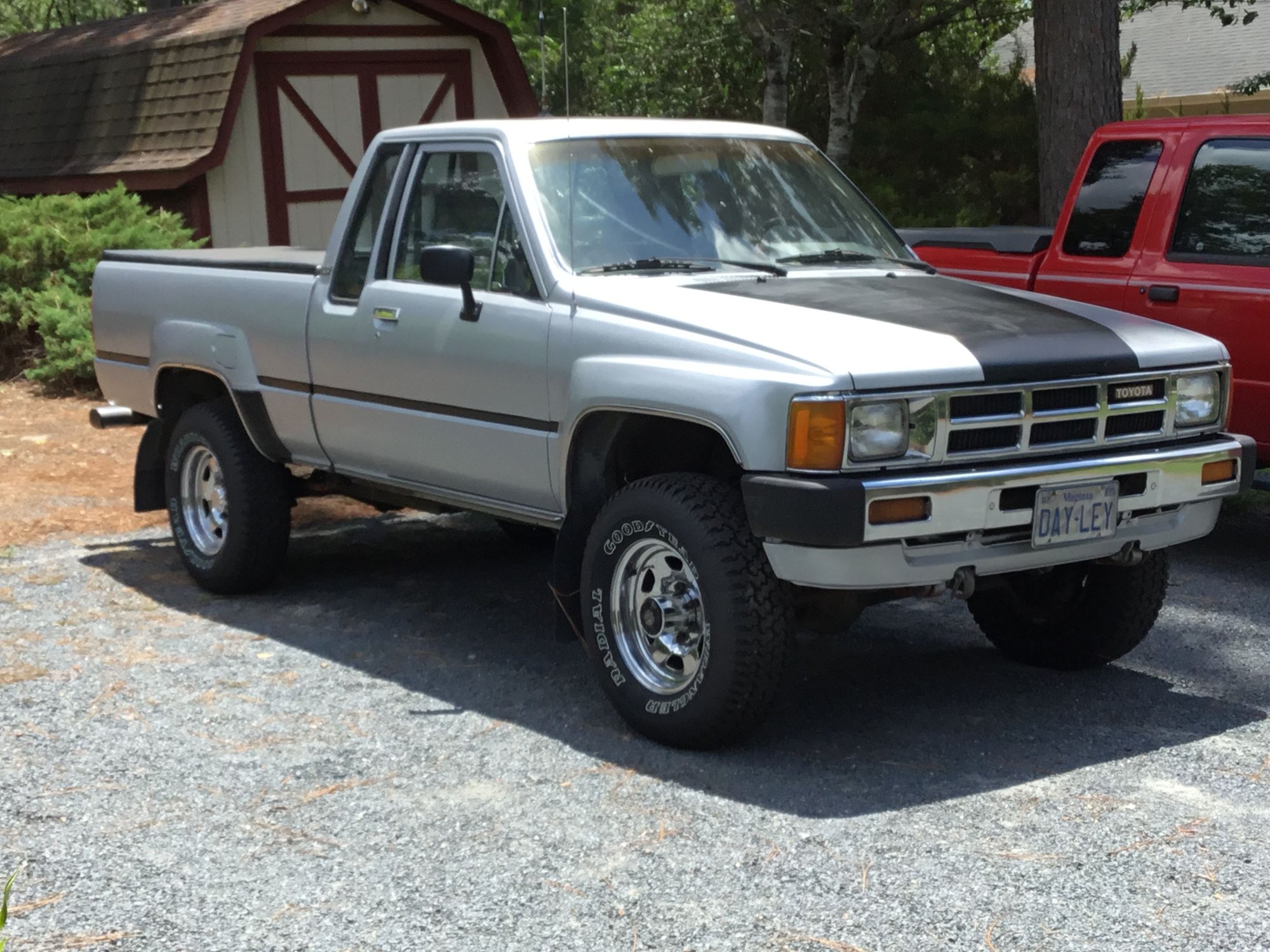

You never told us what truck it is.
Pics

Wow, Nice looking truck
Anytime you want to call it quits just let me know and I'll send a tow truck there to pick it up
I could always get another brother for my 84..............
Hump

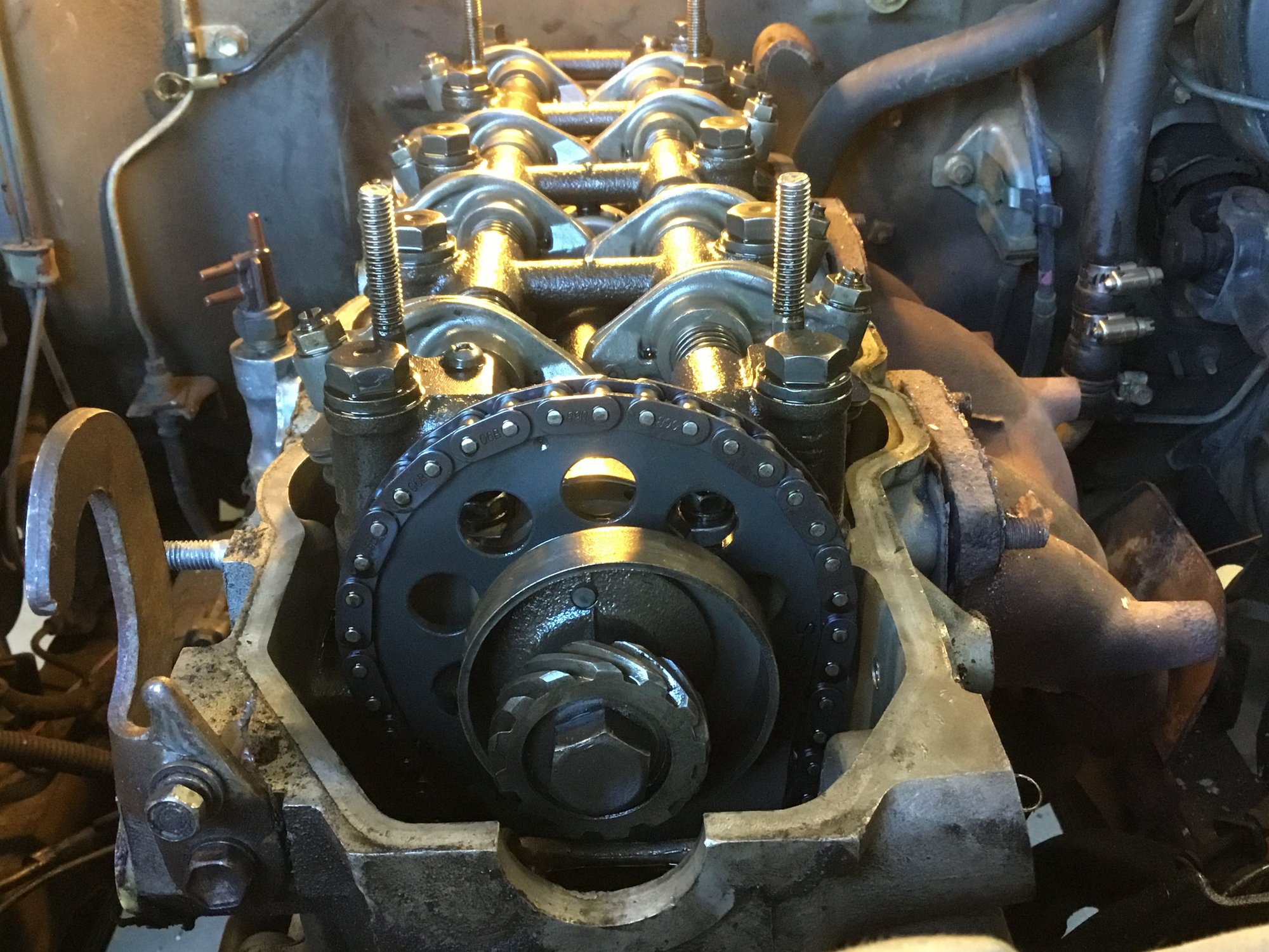

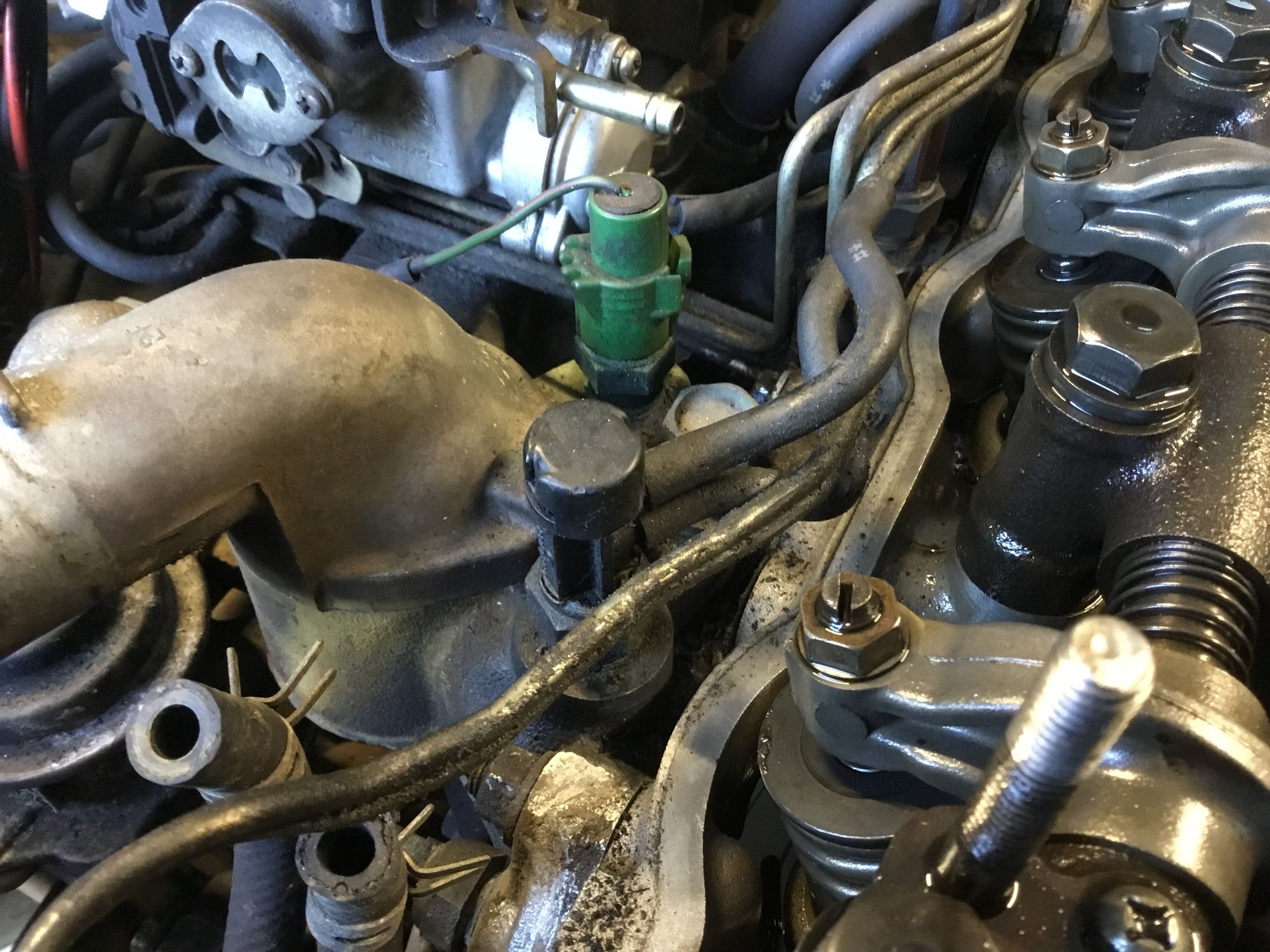

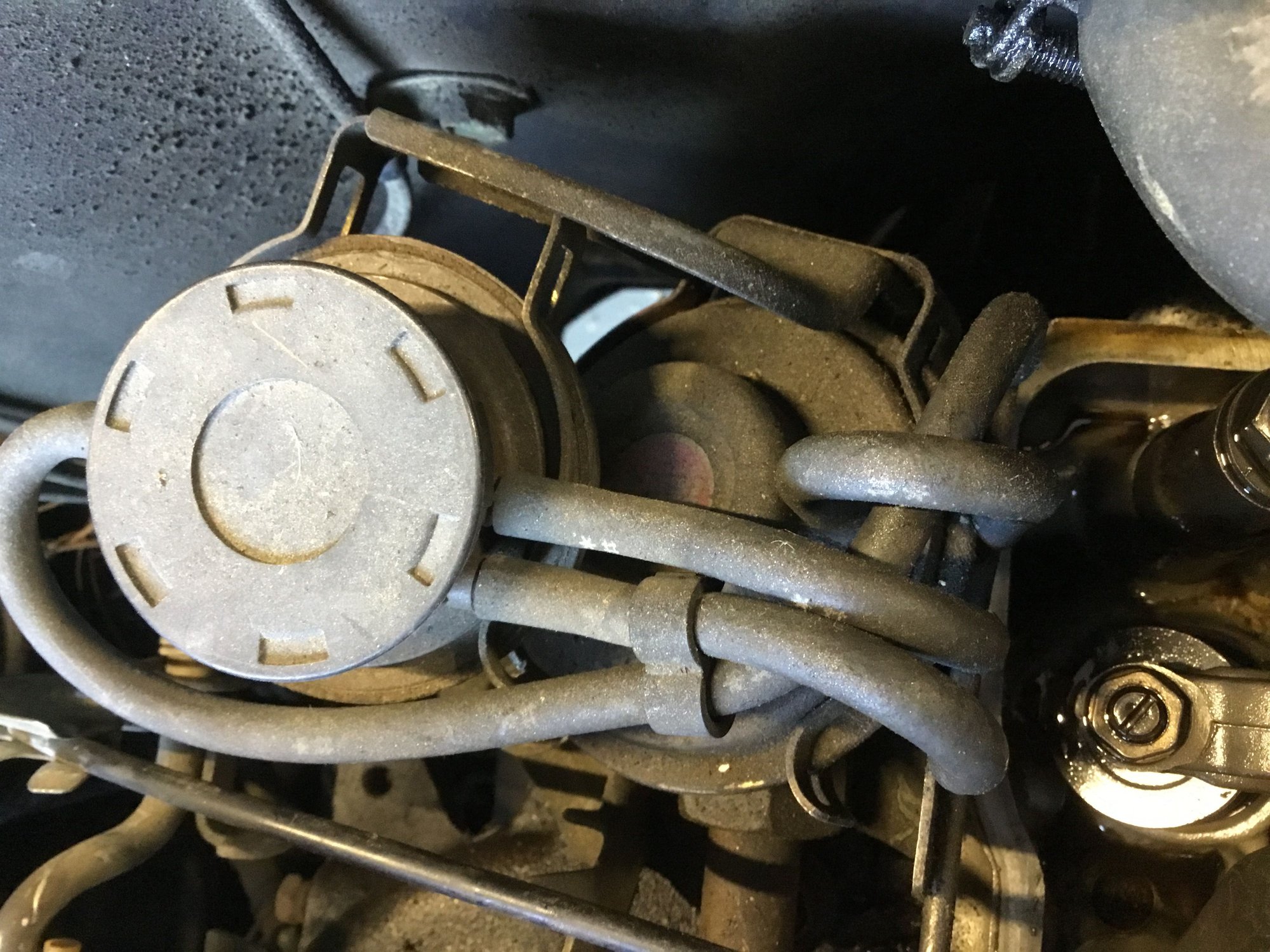

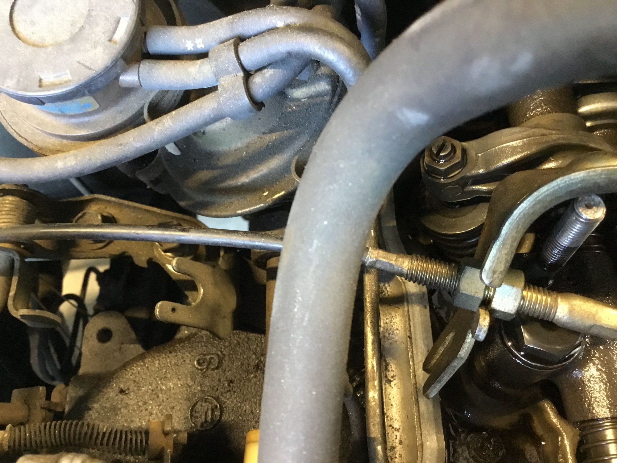

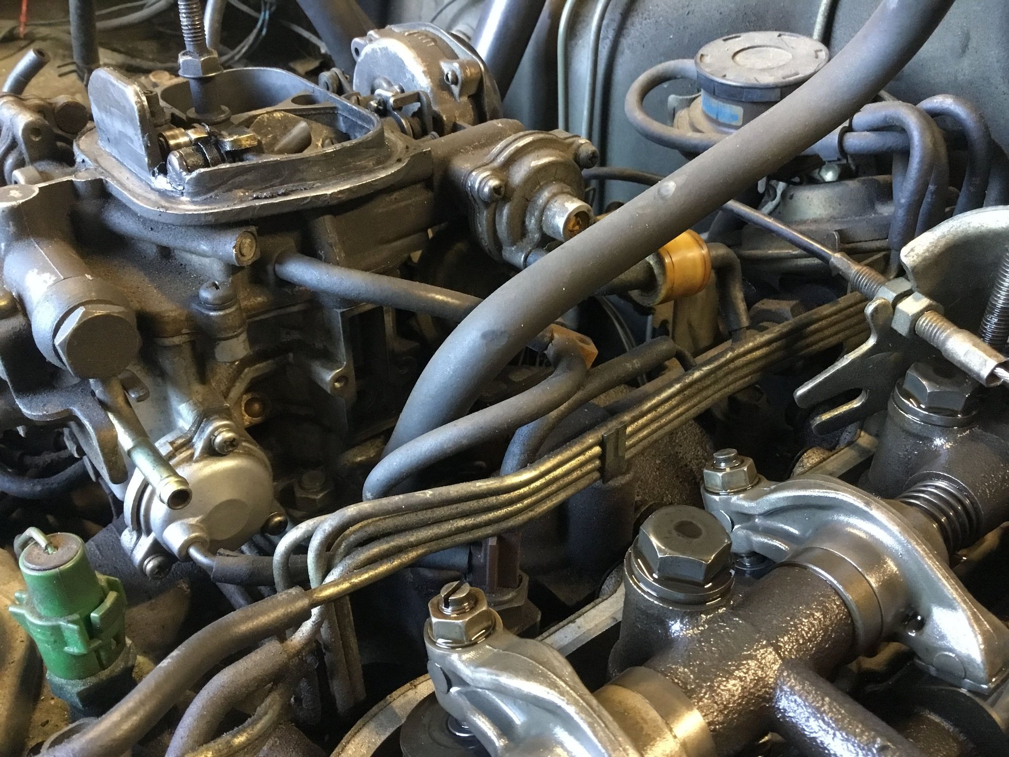

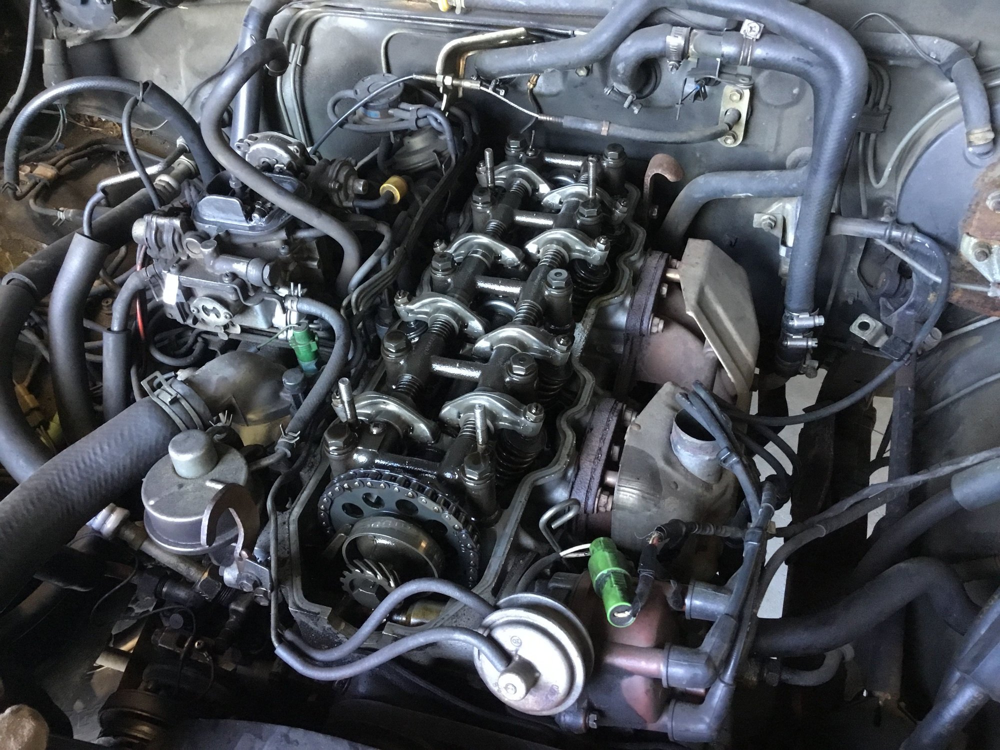

Well, haven’t been pushing the repair so just getting into it. There sure are a lot of vacuum lines on this thing. Making pics as I go to see if I can put her back together properly.

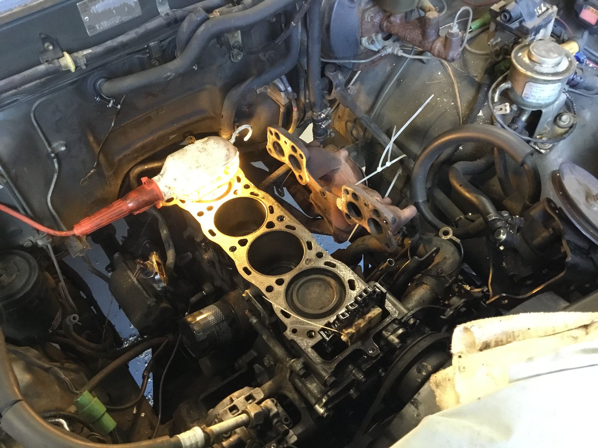

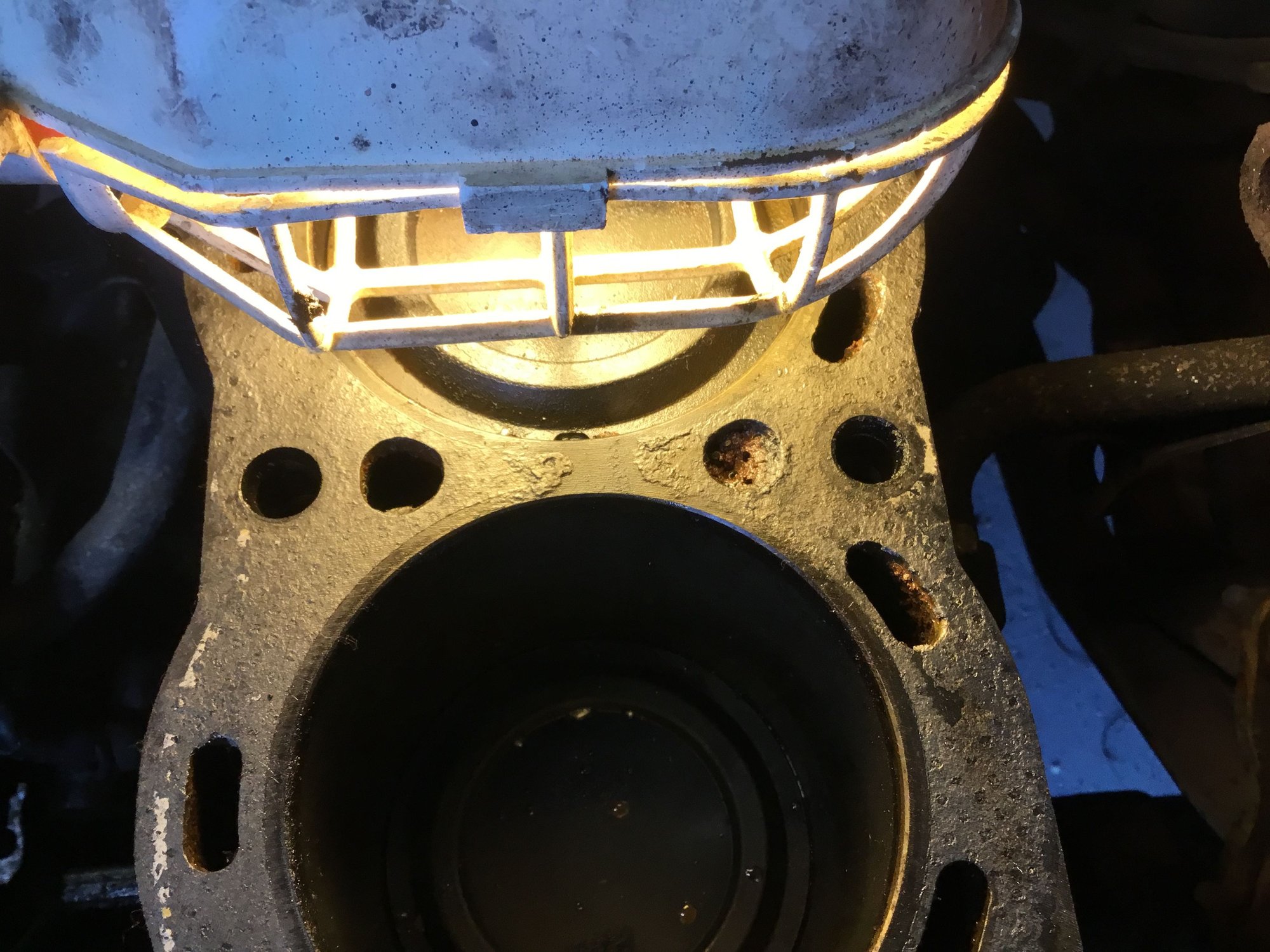

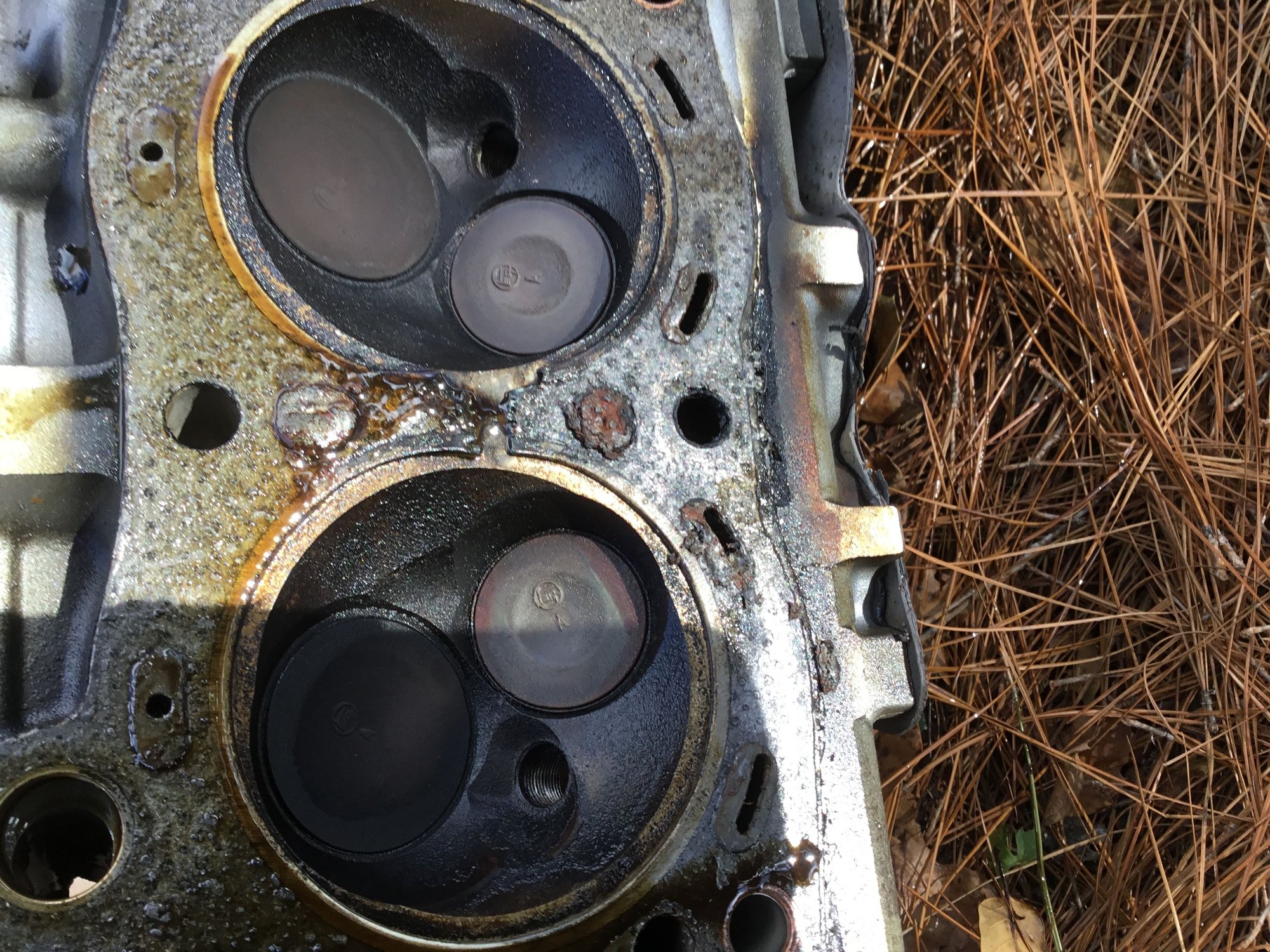

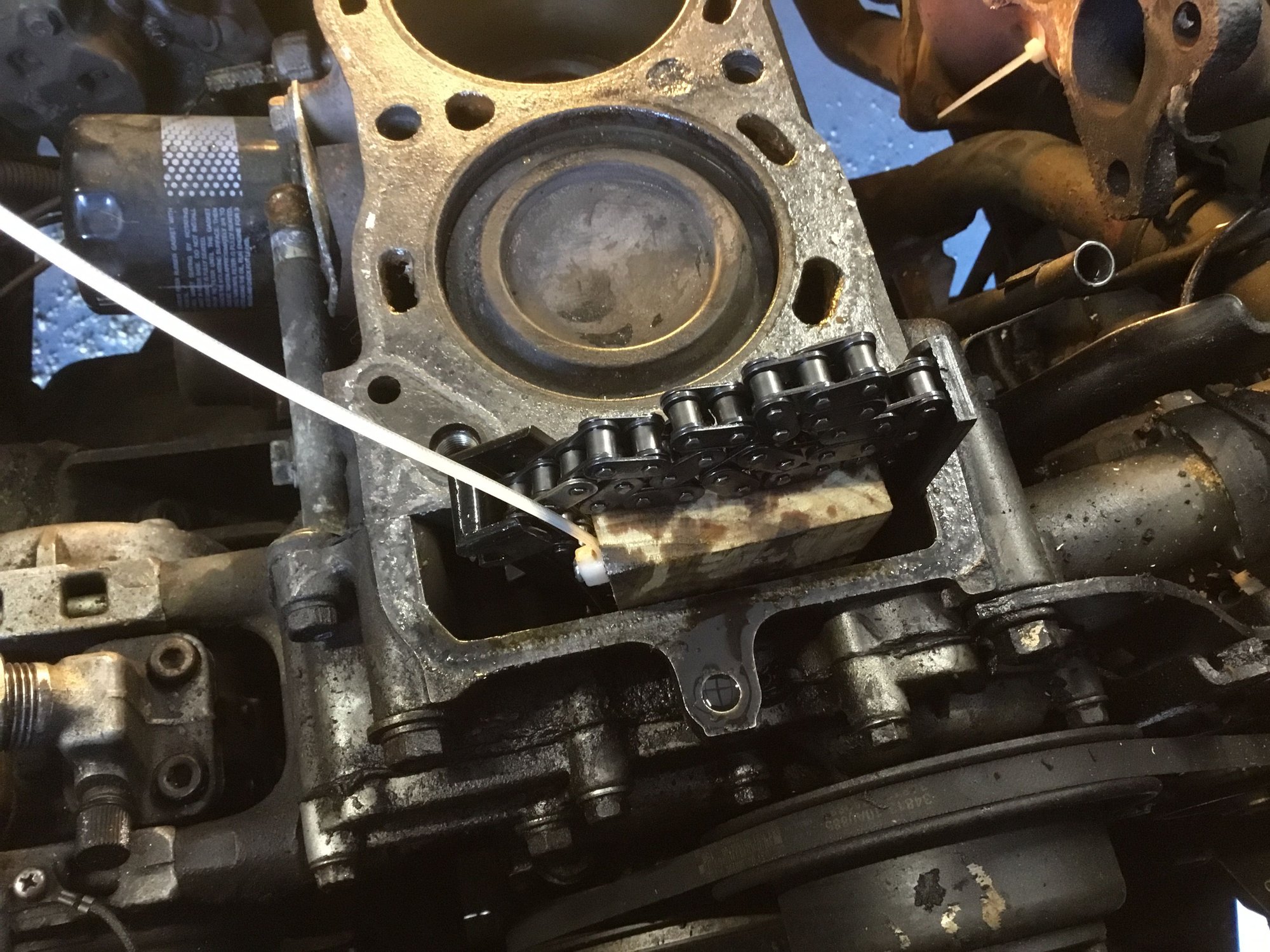

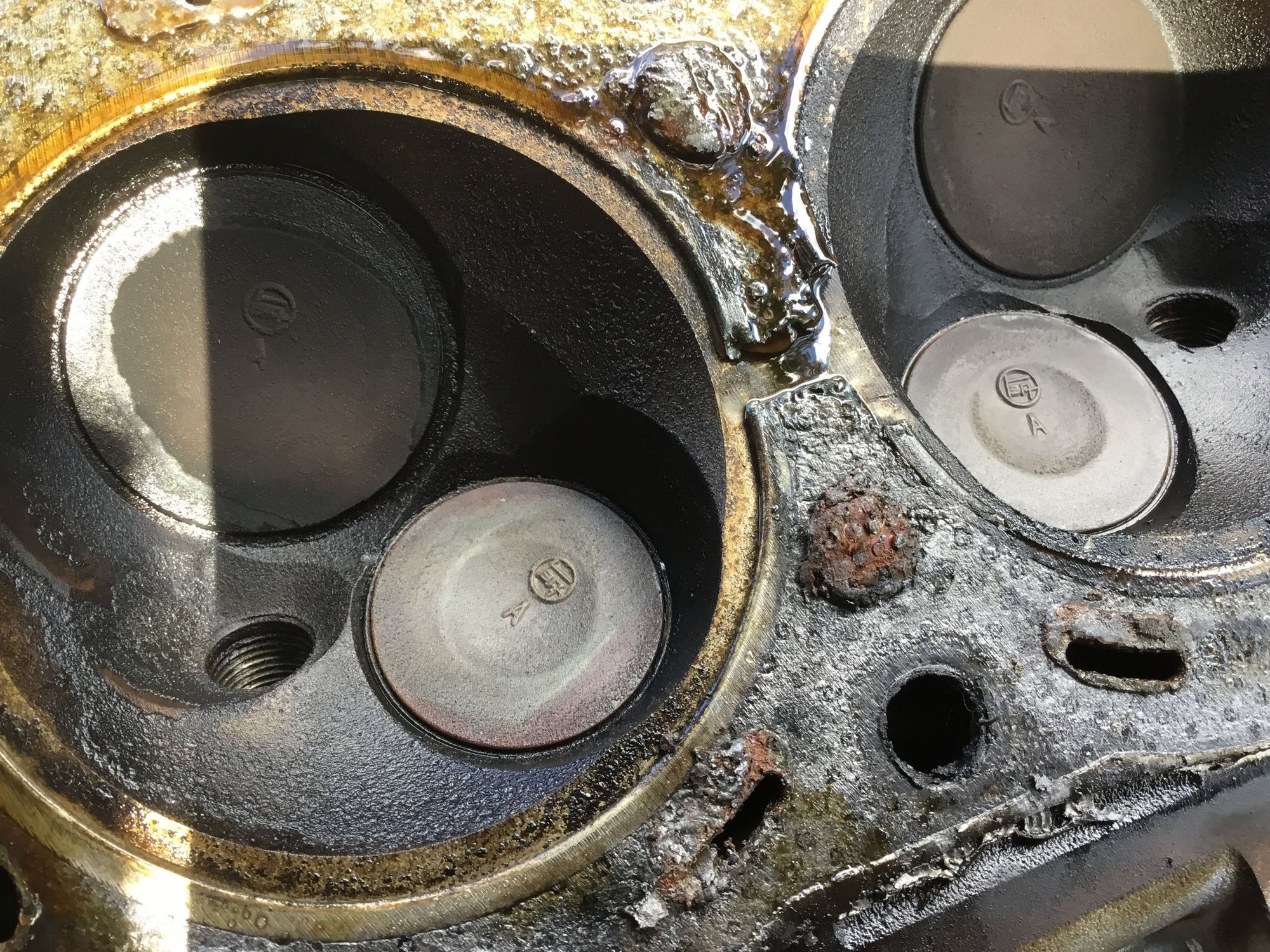

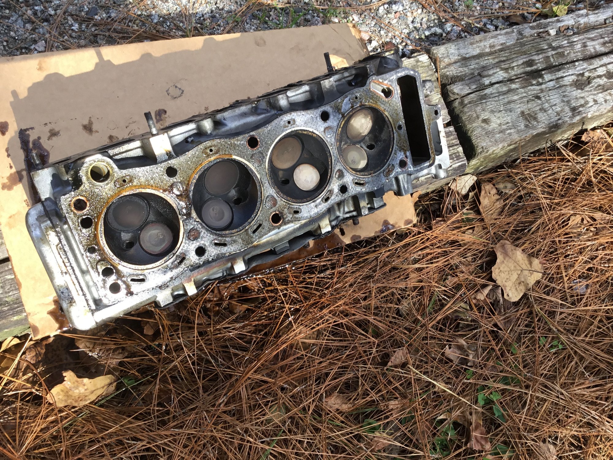

Well, got down to it. Between 3 & 4....Surprising how such a small gap creates such havoc! Now, to get a gasket set and reassemble.

Guess I should have put up a pic of the gasket itself!

Was that a Toyota head gasket?

The emissions systems on these engines really aren't as scary as they look.
While there are many vacuum lines, I found that looking at each emissions system separately in the Factory Repair Manual makes things easier to understand, plus you can see where each vacuum hose goes.
For the record, all of my original emissions equipment is still functioning properly.

The engine was rebuilt at 288,000 miles. I do not know if it was another original gasket reinstalled. Seems to me that there were holes stopped up that should have been left open. ???? There re right at 300,000 miles now. ;

Howdy yotatech brother. If you have or can put your hands on a good straightedge, (I use a machined piece of steel bar I scrounged a couple of years ago), you might want to start checking that the block is not warped or cupped. It happens a lot and the low spot is usually in the center between the cylinders, right where your gasket failed. If the block is flat, the problem might be that the head is warped. If everything is flat, maybe the head bolt holes weren't cleaned out properly and the bolt torque was too low. Head gaskets should last longer than 12,000 miles though. There is a reason that thing failed so fast.
