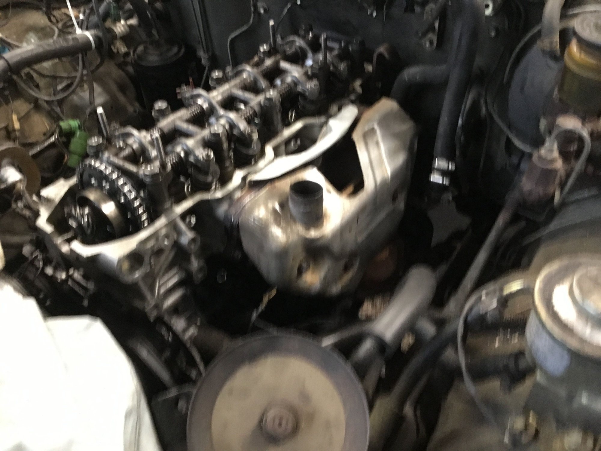

You removed the cam sprocket. Please explain how you plan to.get it back in the right orientation?
Old Nov 9, 2020 | 08:37 AM
  #22
DAYLEY/CHALLENGER's Avatar
5 Year Member
Joined: Apr 2017
Posts: 81
Likes: 20
From: Rockingham, NC.

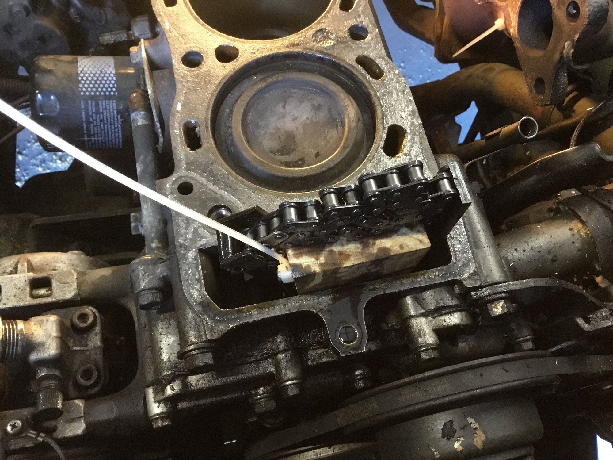

Ok. I guess you are talking about the drive for the dist and offset for the fuel pump. And the top sprocket for the camshaft. To prevent the tensioner from popping out on the bottom end and having to remove a lot of front covers and such. , I put a wedge down in the chain cavity. It can’t drop off the lower sprocket and when I put the top sprocket back on,there is a dot on the sprocket and I made a pic of where that goes. Also the dist rotor will be facing towards the 10 o’clock direction. At least I hope this is how it will work out.

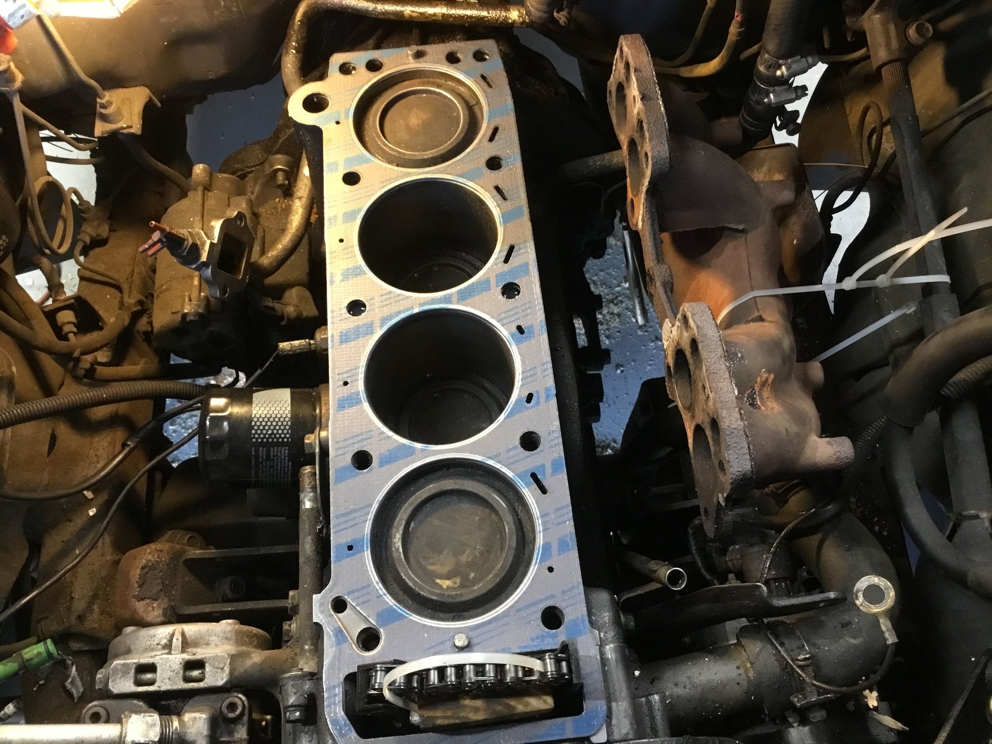

Gasket set got here about 8:30 last night. Worked til 10:30 this morning, Didn’t start on the truck until about 12.. Head back on, torqued, timing sprocket worked out good. Exhaust back on too. I did find what looks like a coin, but says warranty void if removed! Interesting. Was stuck on the back of the head..

Making great progress! Which gasket set did you go with?
Old Nov 15, 2020 | 09:21 AM
  #27
5 Year Member
Joined: Apr 2017
Posts: 81
Likes: 20
Fel-Pro
Fel-Pro HEAD GASKET SET FEL HS26185PT1

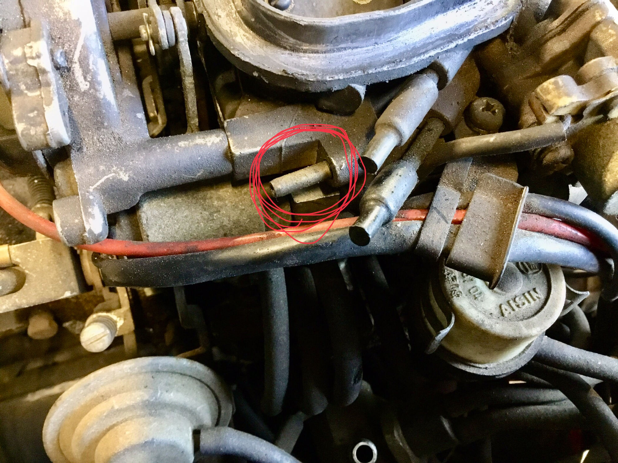

Ok. Putting back the vacuum hoses. Got most hooked back up, but there was one port on top of the carb that did not have anything hooked up, which is why o am asking if anything is supposed to be connected there. Please look at the pic and comment, thanks.

Well, in looking at several pics last night on line, there was one pic of a carb that had that tube blocked. So I did the same. Will send more info tomorrow. But.....SHE IS ALIVE!
