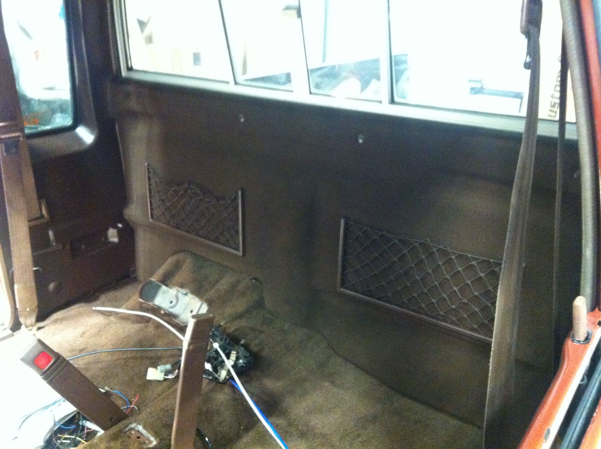

Anybody know how to pop the cargo nets off the back of the cab? I want to replace the elastic band on top so I can use them again.

you need to remove the panel .
on the back side of the panel you see the posts and the metal retainer clips .
I used a small die grinder to cut the metal clips off , then the nets come off as an assembly . you can repair or replace them from there , and re install them . I found the replacement clips from a local car parts store .

Awesome! Thanks! Looks like the previous owner had taken that off so it has the push pin things now. I will be rebuilding my carb tomorrow. May tackle that as well. Thank you!
