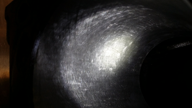

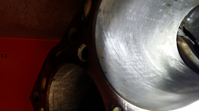

Hey all,
Rebuilding my 22re and was honing the cylinders and noticed in the 3rd cylinder it had 2 pretty gnarly scores in it. They're deep enough to slightly catch my fingernail on. This is a first time rebuild for me so I was wondering If I should try honing a lil more or just take it to a shop and go all out and just bore it .30 over. I was thinking of going .10 over but I can't find any pistons that are .10 over...or would I get away with using over size rings on my stock pistons? Appreciate any input.. I'd like to keep it stock as possible. And I'm also using OEM Toyota internals..and would like to keep it that way lol. Thanks.

Can you show us pics of the scoring??

I will upload some tomorrow I left the block at work. But will do!

I'm not there to put my fingernail on those scorings, in order to get a perfect picture of what they are, but from your images,
I'm thinking I would leave them alone if the bore and taper measure good.

Your building a low horsepower engine so to speak .
I also say don`t mess with it unless you just want to do it because!!
Now if you were building a 1000 Hp different story.

I haven't taken it to the machine shop yet..next week I will.
And yeah exactly it's just a motor for my daily but I'd like to make sure it's good to last another 29 years...haha if possible
