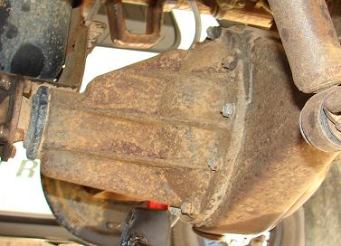

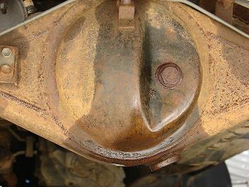

The first indication that my rear end wasn't stock was last month when I was taking the truck for a test spin in a gravel lot. The inside rear wheel would slip in tight circles, I'm a newbie but it seemed obvious that the rear differential was welded or had a locker installed. I asked the previous owner about it, he bought the truck when it was about 5 years old, says he thought it was all stock. How do you drive a truck for 20 years and not know this?
Anyway, today I go to put some fresh pads on the rear. Nothing telling me it was necessary but the truck had 126,xxx miles, so I figured it might be a good time. I beat the drums off and the guts looked nothing like what's in my manual. So I accept this as my lot in life, nothing is ever easy or goes the way it should.
While waiting for a buddy to arrive I go to change the rear diff. oil. and my shiny new 30mm socket is far too big. I measure the nuts on the rear diff., they're 15/16", I guess about 23/24mm. wth?
So, I take pics and post here, can anyone tell me if this is a stock rear on my '85?

Looks stock to me.

I obviously have the 4cyl/8" housing but I read everywhere that the nuts should be 30mm.

where did you see it's supposed to be 30mm? that sounds more like the size the axle nut is supposed to me not the drain and fill plugs on the diff housing. What your describing is not an axle nut they are the diff drain and fill plugs.

Drain/fill plugs are typically 24/25mm.
Pinion nuts are 30mm.
That's a stock rear axle by those pictures.

Ok, thanks guys, I can calm down from panic mode....I still haven't settled down from all the excite of the game...
