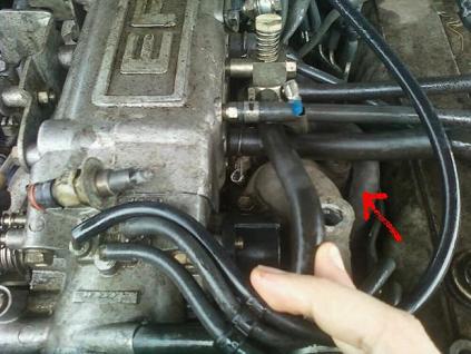

Can anyone tell me what coolant hose this is? I have a small pinhole in mine and its leaking coolant. Cant find a part number or name for it, dont have a FSM yet. Its on my "new" 1985 4Runner, EFI, and I am starting my preventative maintenance. Somewhat new to the 1st gen 4Runners, I have an FZJ80 that I am a little more familiar with. I found these pics on the web, not from my truck, my camera is crap. Thanks for any help!!!

I would just pull the hose and take it in.

Looks like the return line for the Idle Air Control Valve.

Thermostat by-pass hose. I have no idea what the part number is, but the dealer should know. I would think it would be a dealer only part due to the odd size of the hose and the need to wrap around (pre-bent) the thermostat housing. However, the hose in the pic looks to be like a standard parts house coolant hose. So who knows.
If you do find a part number, post it up here for others to know. I can't tell you how many threads I've seen where people are looking for what part number that is for.
Edit: In that pic it looks like they used Fuel line hose, I still think you will want to go to the dealer. That is obvisiouly not a fuel line.

"CruiserDan" from American Toyota/IH8MUD, gave me these parts numbers for that hose:
16264-35011 up to 2-85
16264-35012 after 2-85

using the VIN for my 92 I came up with this pic....the hose in question is 22210D

i think its the coolant return hose

Got a leak from this area too. What does this hose do? Do you have to take off the thermo inlet to get to it? or what?

It provides coolant though the throttle body to keep it warm. Shouldn't have to take the thermo housing out to get off. As long as you can get tools in there to get the fitting off. The hose itself should just thread out from underneath it.

Hi, I was searching online about this same hose. I have a 1st gen 4runner (1985) and this hose is connected to the thermostat housing, however, I can't find a home for it. I've looked all over the intake manifold and don't see an inlet. I found a diagram that is showing an inlet on a part that is on the bottom of the throttle body, however mine doesn't have that part because it's a 1st gen. Anyone got a good pic? Thanks.

Its kind of a tough one to get a good bottom pic of. If I have time tomorrow I will work on mine and take a pic for you.

Awesome, thanks. ANYTHING showing where it goes would be greatly helpful. I think if you just disconnect your air intake into the throttle body and get it out of the way, should be able to see/get good pic from there? I have the toyota diagram that shows the hose (22210D) but no dashed line to the inlet.. thanks Toyota

I got mine from rockauto ,I believe it was. The part numbers were same as diagram 92 toy posted. They were gates hoses and reasonably priced.
