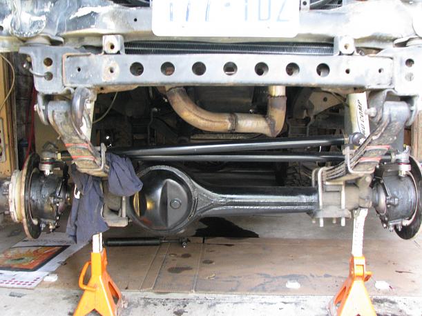

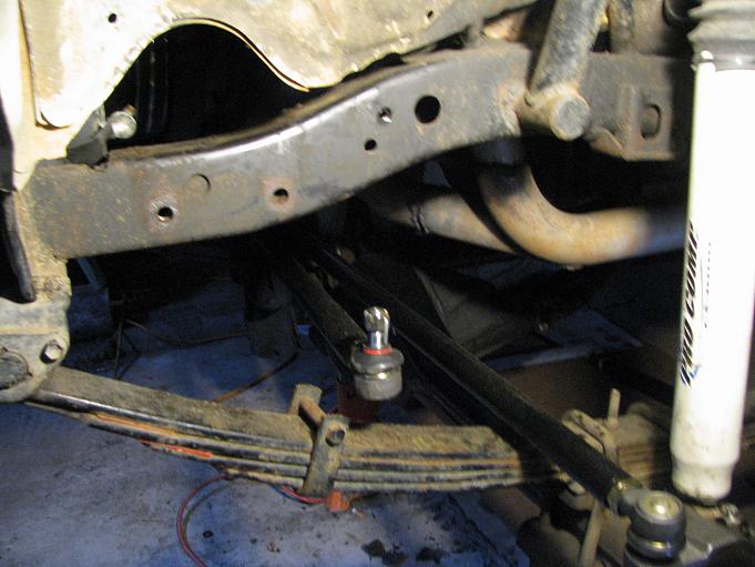

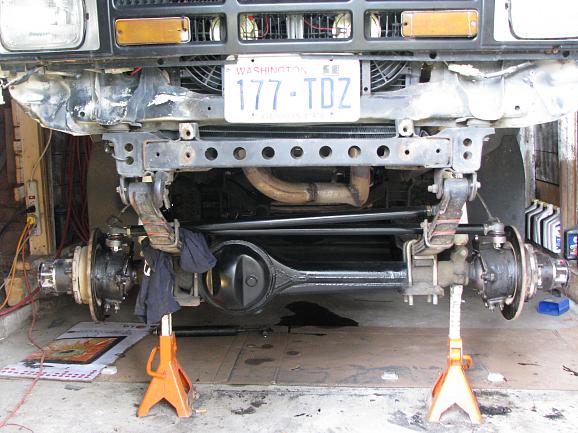

thanks for the advise. the highsteer projects is going well. the marlin knuckle kit went smooth and the trail gears arms went on good. the tie rods are stellar looking!!!!! funny thing is, i had to cut a 4inch hole in my garage wall to pull the axle out!!!!! ha ha!!!! other than that napa wants 425 bucks for an ifs box and the junkyard is empty!!!! im in limbo. need a box bad, i live in bham wa. let me know if you can help!!!!

i kinda like how the axle looks without it personally. I NEED TO FIND A BOX!!!!! is that a winch mount bumper from trail gear??? if so how much did you pay for it??
