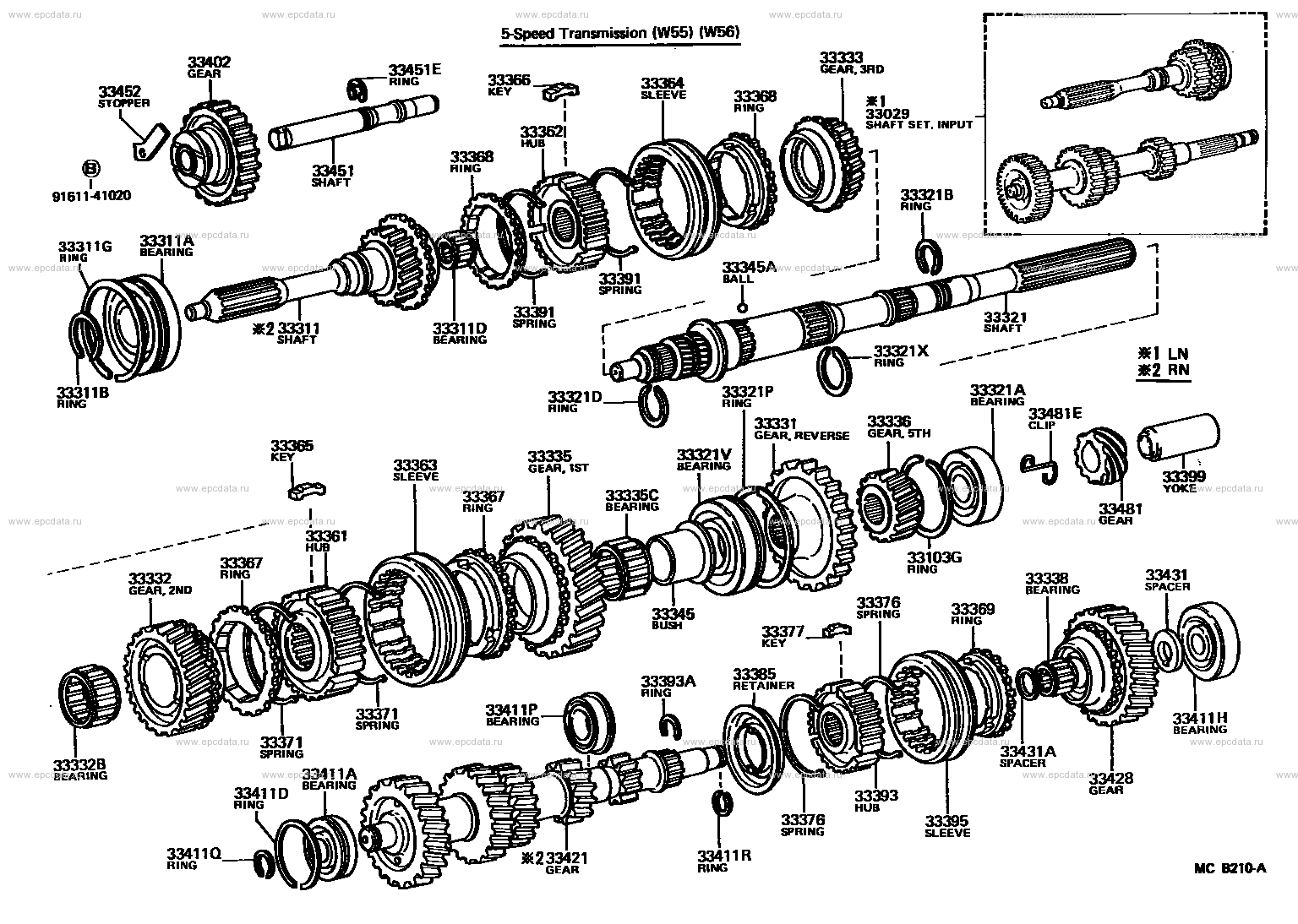

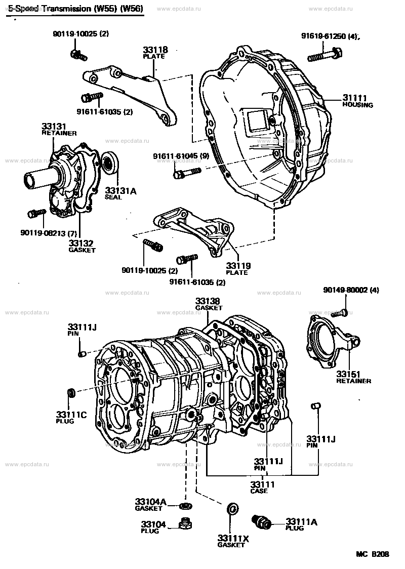

Here’s an exploded view of the gears, bearings, rings etc
I aso included one of the case showing the gaskets.
this is for a 87-88 w56

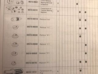

I do have this Toyota Tool set. 90316-60010. I'd be willing to send to a member I trust, just have to cover shipping both ways. But in all honesty, it's not really needed.
