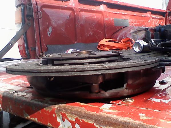

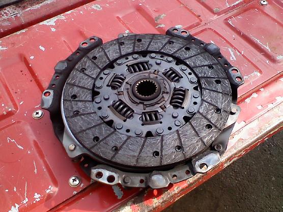

clutch is out!!! thank you 83. the trick worked. i use a pice of wood.couldent have went eney better. now for some pics. i belive this thing is tost but i rather u guys take a look too to let me no how yall feel.my flywheel dosent look to bad. there are some little purple burn marks not many tho. i have another one im not sure if its in eney better shape tho.i really dont no what a bad wheel looks like.help on that would be nice too. thanks alot

that clutch doesnt look to be bad enough to not engage like you were saying, unless the pressure plate or flywheel was really really bad. my guess is that your hydrolic clutch system was leaking and because it sat for so long it got air in it like my buddies.
