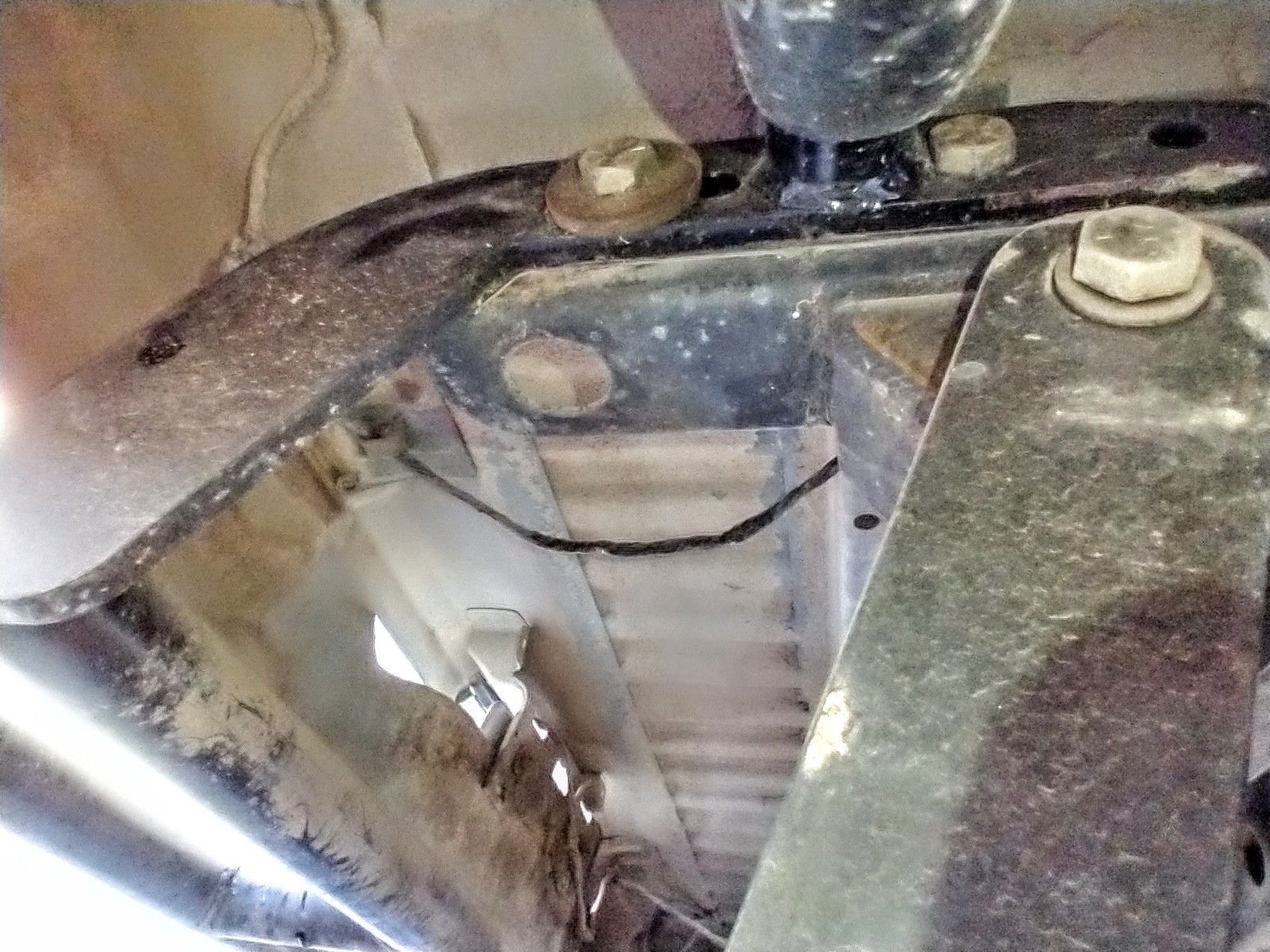

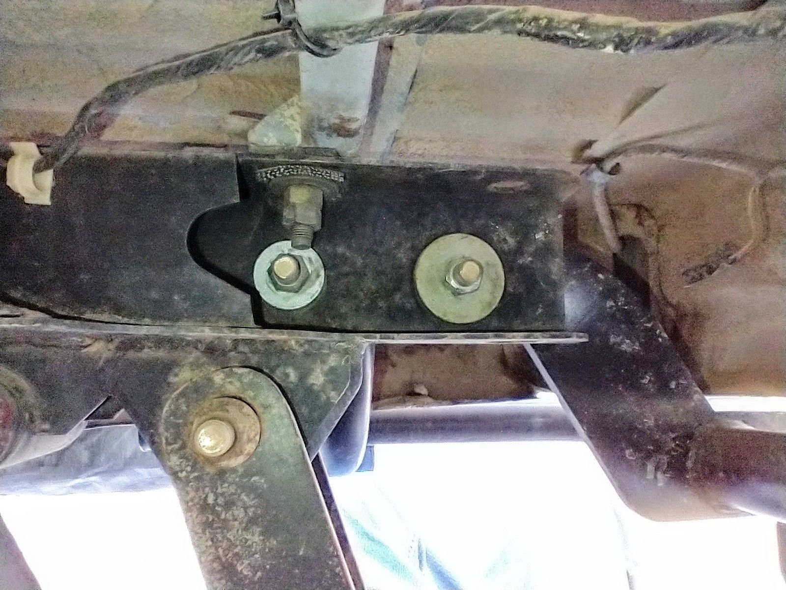

If you have a chance, can you snap a pic of the hole placement on your rear bumper? If the holes were drilled maybe like an inch back I think everything would be groovy

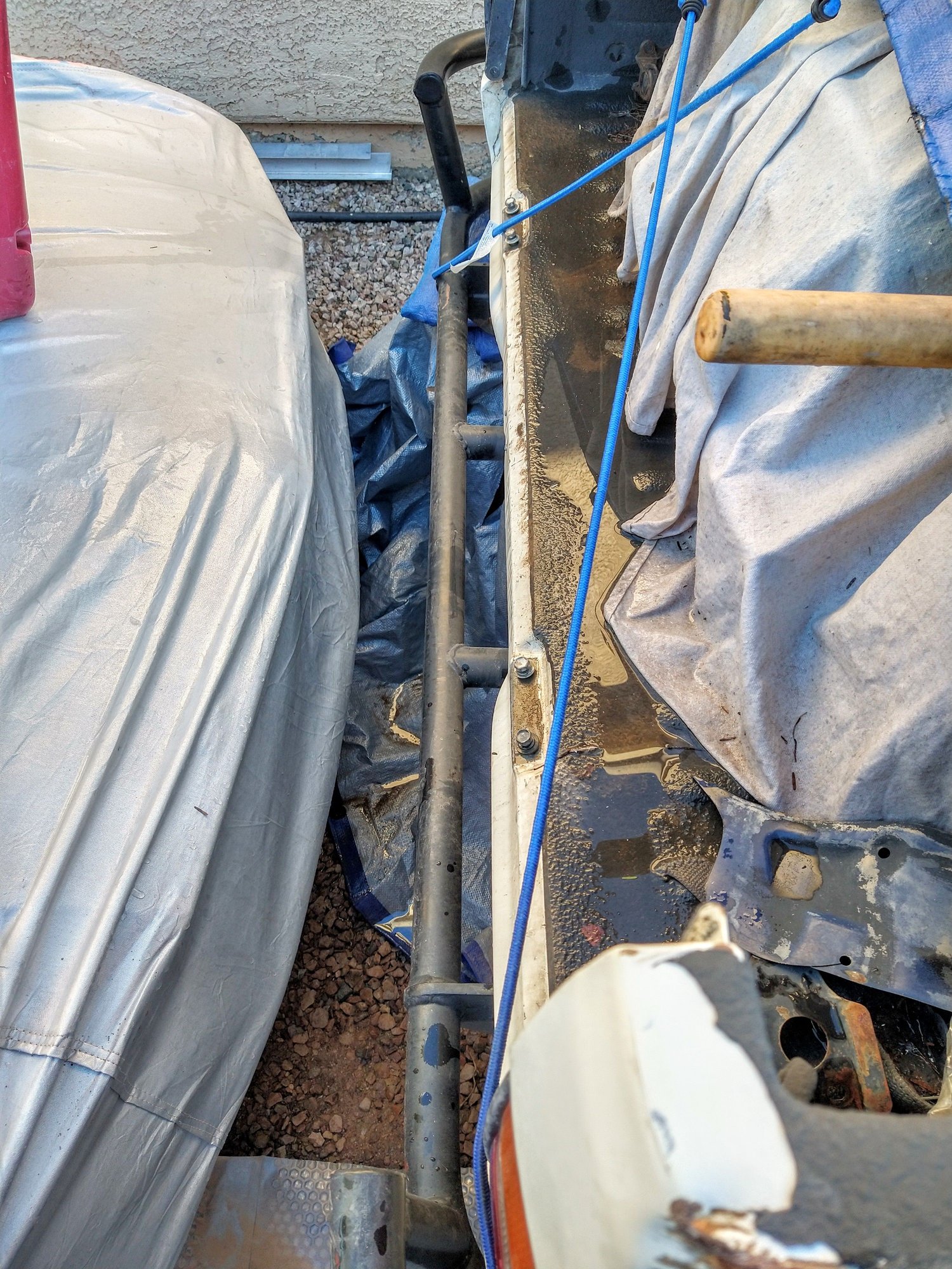

It's pouring here. My 88 is now a parts truck for my 86 build so it's under tarps outside.
It's been many years since I installed this bumper so I don't remember if I drilled new holes. Looks like it's the rear holes regardless.
I also got tired of dragging it on extreme trails so it's been modified as seen in the one pic.

Thanks for taking those photos
It looks like my bumper holes are in the same position as yours as much as I can tell... wonder wtf I am doing wrong.
