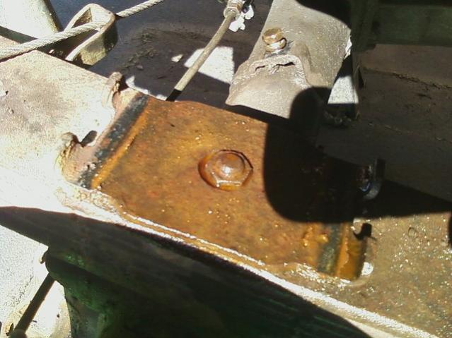

Here it is.
It seems a bit recessed, so I can only get to maybe the top 1/4 of the nut to fit a socket onto it. I've got it soaking in pb blaster right now. Any other suggestions would be great.
i've got the ubolts and everything else removed on both sides, this seems to be the last thing holding the axle on each side.

You could grind away some of the leaf spring, to get to the nut there.

not sure what your doing but take that plate off and you can get a socket on there or grind the nut off but make sure you put c clamps on your leaf springs to keep them from flying apart

crank some c-clamps on to hold the pack together .. makes things a little easier and safer , might even "suck" up the sunk nut

Yea Yea that plate looks removable aye?
Old Jun 19, 2010 | 08:20 PM
live4soccer7's Avatar
Joined: Nov 2008
Posts: 1,319
yep... I was just out there. For some reason I was thinking that there was a lip on the bottom side of the plate that the bolt was catching on, but I looked at it closer about an hour ago and took a hammer to the plate (rusted on). Sure enough it came off, so I went ahead and went for removing the nut. It seems the bolt it's on is just spinning b/c it's rusted on. It's dark out now and can't really see much, but it's soaking in pb still and will get back to work on it tomorrow.
Old Jun 19, 2010 | 09:02 PM
Etype R's Avatar
Joined: Oct 2005
Posts: 496
That nut does not hold your leaf springs to your axles at all. That is what keeps your leaf spring pack together. If the springs are stuck on the axle, hit them from underneath with a hammer.

Thats the center pin that holds the springs together, it is not bolted to the rear axle. If you have the u bolts, the shocks, and the brake lines removed then the axle should be loose. There is no need to remove that nut and bolt what so ever to remove the rear axle from your truck.
