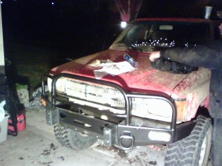

I got my bumper from here: http://www.kenmtn.com/html/wincher.asp
They took a long time and it was spendy but its hand built and i'm very satisfied with the product that was delivered
Here it is on my rig.
