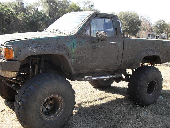

it wont mess it up if i dont reshim it...here are a couple of pics of what im workin with.
Attached Thumbnails spider gears???-truck-017.jpg   spider gears???-truck-019.jpg
Old Feb 19, 2009 | 02:52 PM
NeverSatisfied's Avatar
Joined: Dec 2008
Posts: 19
Quit worrying and get it done. by the picture, your ring gears going to have to come off the carrier to remove cross pin. Mark ring gear orientation and put it back together.
