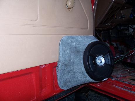

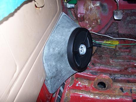

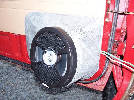

Well here is the question, now that I have three days into our project...
Where and how is the best place to mount front speakers in a 85 4Runner, other then the factory dash location?

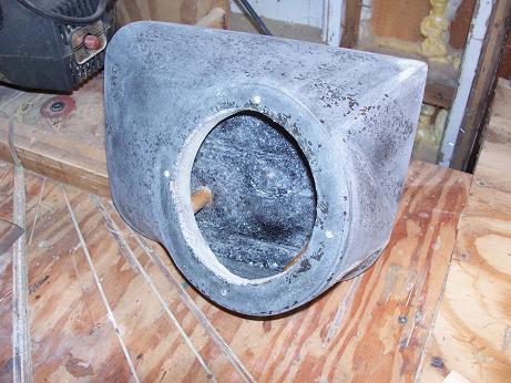

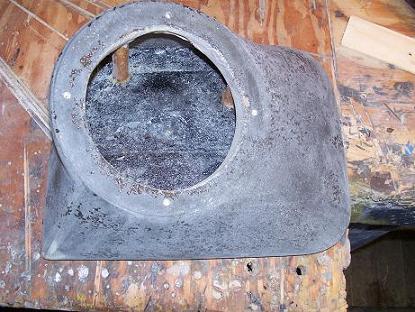

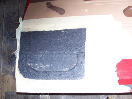

We have started on a set of 'bolt on' front speaker pods to eleminate cutting into the door. And in true fashon of putting the cart in front of the horse I figured I would ask for options. Below are a few pics of the project and the initial fitting on the door. That is a 6 1/2 in speaker and if you look in the pic with the door closed you can see that there is minimal obstruction into the floor. The box/pod has a long way to go, another coat of epoxy resin then 'bondo' and sand. repeate till smooth; and the other one is barley started.
I welcome comments or options others have used.I have added the link to all the pics if interested.
Thanks Bob and Rob

Attached Thumbnails Speaker mounting, pod or other, PICS-100_1062a.jpg   Speaker mounting, pod or other, PICS-100_1066a.jpg   Speaker mounting, pod or other, PICS-100_1067a.jpg

More pics here...
Attached Thumbnails Speaker mounting, pod or other, PICS-100_1069a.jpg   Speaker mounting, pod or other, PICS-100_1070a.jpg   Speaker mounting, pod or other, PICS-100_1071a.jpg

Are you just building up the box, or are you pulling a mold off of it when yer done?

For now we are just building it up, might pull a mold and make a second set, with gel coat from mold if we like them. They do not seam to be in the way when sitting but we have not driven it so that will be the real test. So far the one sounds good but it is with ony an old cd head unit so once my son gets his amp and new headunit we will know how well they realy work. I figure if he (or should I say we) gen get better at making molds and glass work then it is worth the time to do it. Besides if they work well then the molds could be used to make several if wanted.

if you have winged windows, just cut into the panel, there'll already be an opening under the wing window and will suit a 6 1/2 speaker perfectly. if the speaker itself is too deep, you can always add a spacer. this would be more practial than building pod molds.
it seems to me that those pods are sticking out pretty far! short drives shouldnt be an issue but once you get on the road and drive 50+ miles, ur gonna want to move your legs around, and that pod'll jus get in the way. looks cool though!

I think it might look ok once finished but am unsure if they will be. We are already working on set two. Yes vent windows would make life easier, much easier.
There has to be a better way...

THe universal looks like it would stick out as much as the ones we made, maybe not though. The idea of placing a speaker magnet and the vibration of the speaker just fractions of an inch away from the ECM do not sound like they would do it much good (maybe a cushioned mount and a 1/2in lead and nickle titanium liner ;-) ) or our first set would have been kick panels. Besides we are learning with every attempt, he will be a master at glass fabrication and what NOT TO DO (LOL) once we are done. ...and if we get it right he will be a master at what to do. :-)
Still open for sugestions as we are looking for a decent result on his system, sound quality and staging, not just a loud and poor sounding system.
