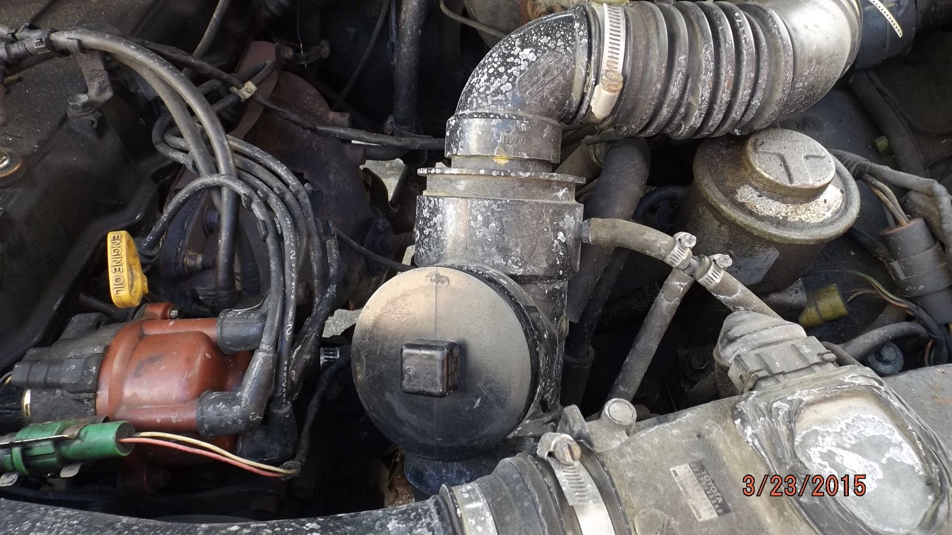

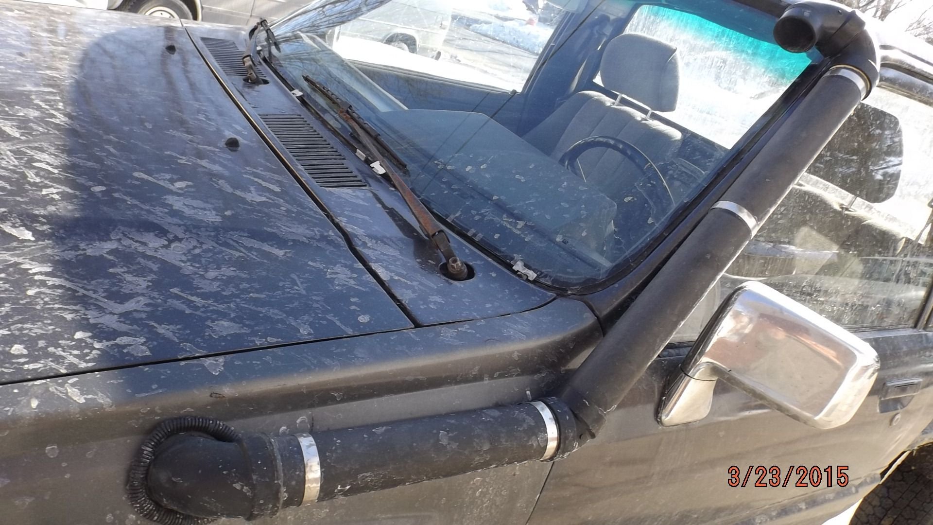

This is my home built snorkel. I run though pretty tight bush and didn't want a big snorkel that would get ripped off so I built my own. I used 2' ABS pipe and fittings that I attached to the body using four hose clamps held on with 3/16 rivets. Under the hood I attached a large sewer pipe with a removable cap to my airbox using windhield urethane (much better than silicone) then plumbed it up to the snorkel. For every day driving I leave the cap off but install it for off-roading and water crossings.
