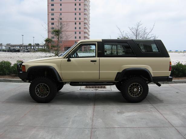

I think you're right about the 4" and that's about what I got when I put the OME kit on. I am sure it is quite a bit more than their advertised 2.5". In fact, I had to install a Procomp drop draglink in order to make my draglink clear the ubolts (even though I used OME "special" flattened Ubolts).
It's possible that I could have rubbing issues with 33's but you can see from this photo that it doesn't look like an additional 1" on the diameter would be a major problem. I installed heavy springs up front with mediums in the rear, firm shocks all around. That's an ARB bull bar with Warn 8000 on the front. Unloaded in the rear.
