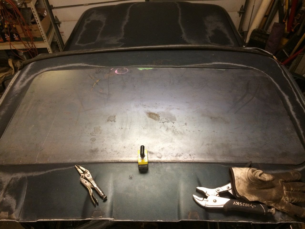

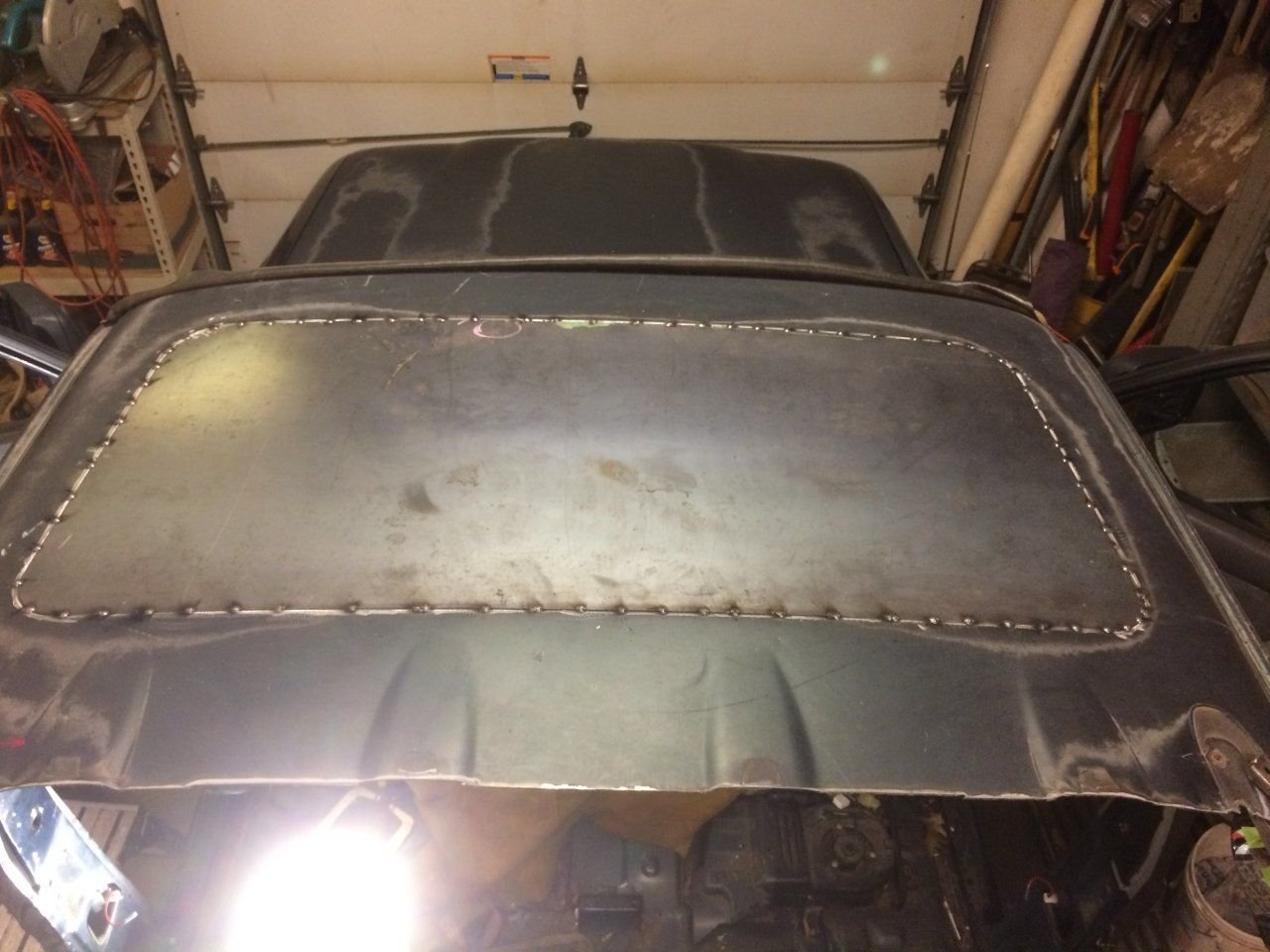

I see, a sheet panel as they did here:

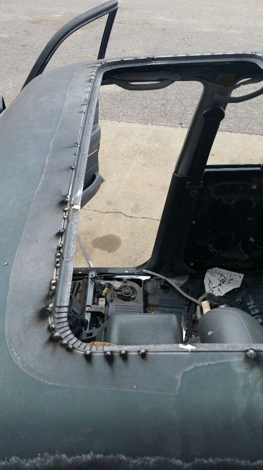

I believe it depends of the body man. There are several ways to do it, search for sunroof delete.
This guy installed a L shape metal trim around the hole for a stronger support.
