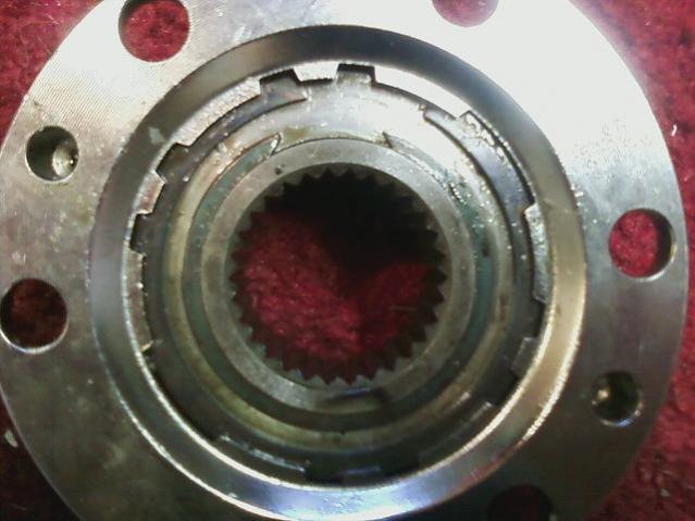

I've been trying to remove these clips and not damage anything at the same time. Is there a specific method for removing them? I was trying with a couple flat head screw drivers (smaller clip, haven't tried the larger outer one yet). I'm going to clean them all up and grease them before assembly again and I'm also cleaning the outer part for painting, so it need disassembled.

Get a small screw driver that will fit in between the little slots and pry it out of there. It's really not that difficult. Just use a screw driver to pry it out.

It looks to me that you should be able to get the larger ring off with 2 small screwdrivers or small picks. The smaller one would be easier with external snap ring pliers but could also be done with screwdrivers. Be ready to catch them as they might come off and go flying across the room.

Dude just took mine apart tonight, use a small screwdriver and pry out in the pointed end of the clip. If is snaps back on you, pry out again, and take another screwdriver farther down and pry some more. It will pop out.

ha, have fun with that, i ran into this same problem i went out and bought some snap ring plyers.. they ended up working great in taking them off and putting them back on.. best of luck to you man.

them clips are easy to remove. I purchase some clip plies that when you squeege the handles they move out instead of in, they work perfect for this

I got some snap ring pliers and they worked perfect.
