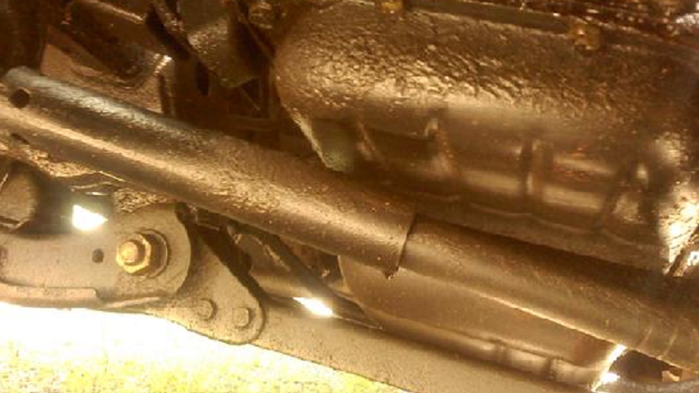

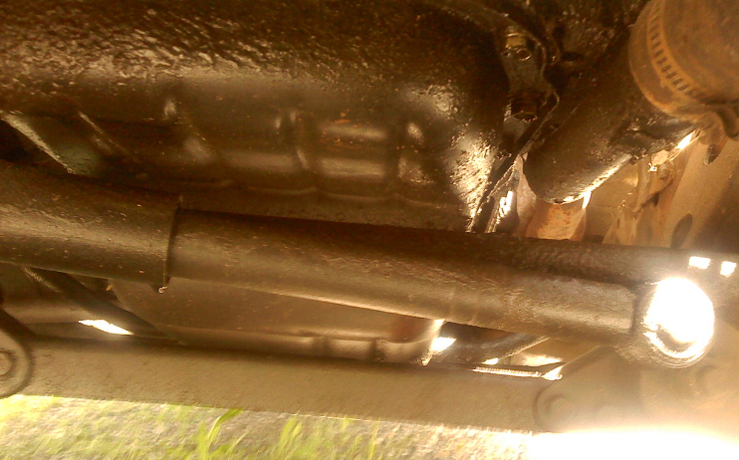

Dirty pictures as promised.
Attached Thumbnails Relay rod rubbing oil pan 2wd-under-dr.jpg   Relay rod rubbing oil pan 2wd-under-pass.jpg

Hmmm interesting... from a side view does yours look like this? Thanks for the pics!
This is the only pic I can find that mine looks like...

Awesome. That first picture looks like the most common for our trucks. But mine is different. It doesn't have the 3 levels. Just two

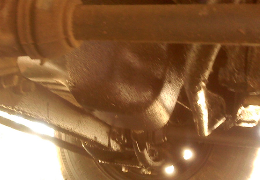

Here are the pics of the pan on my 84
Attached Thumbnails Relay rod rubbing oil pan 2wd-pan-rear.jpg   Relay rod rubbing oil pan 2wd-pan-rear2.jpg

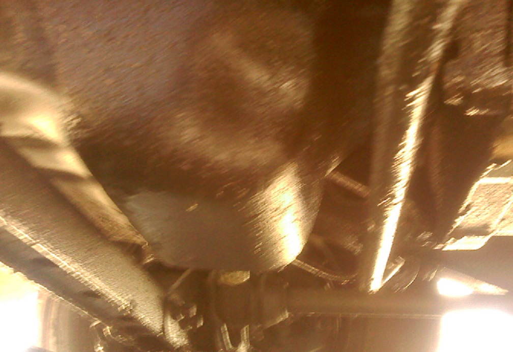

Alright this is definitely the wrong oil pan. I pulled it out again and I was wrong about how I said it looked lol. Here's some more pics. This thing is tiny. My sump and oil plug are directly above the crossmember. L5wolvesf sits further back behind crossmember.. it has to be out of a car application. But I still have never seen one like mine anywhere online.
Notice the gap between sump and sway bar on mine vs L5wolvesf. My sump is further forward and causing relay rod to hit it.
Notice how much deeper L5wolvesf sump is than mine. In reference to crossmember. My crossmember is removed but you can see where it bolts across.

It kinda looks like yours would have slightly less capacity too. Time to find yourself the correct pan.
