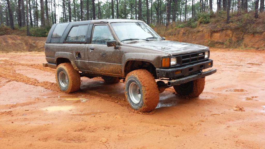

and of course a customary pic of the rig

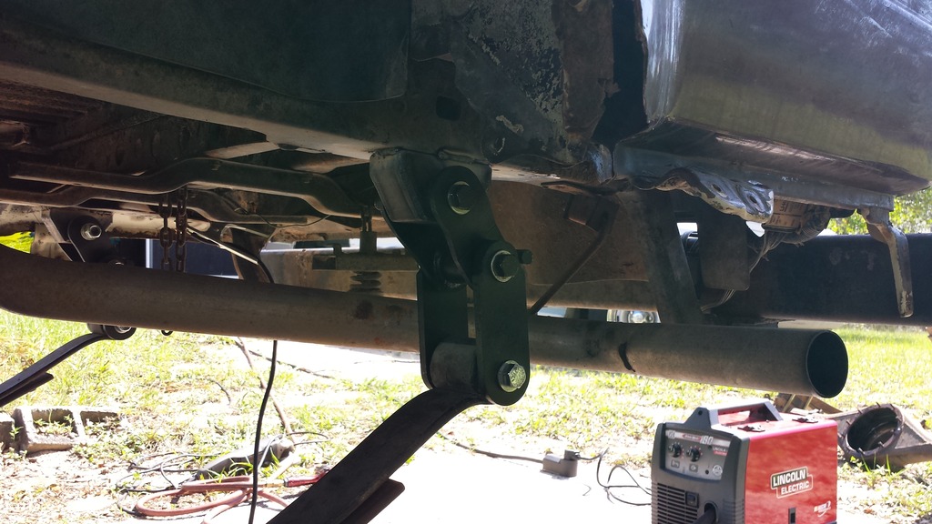

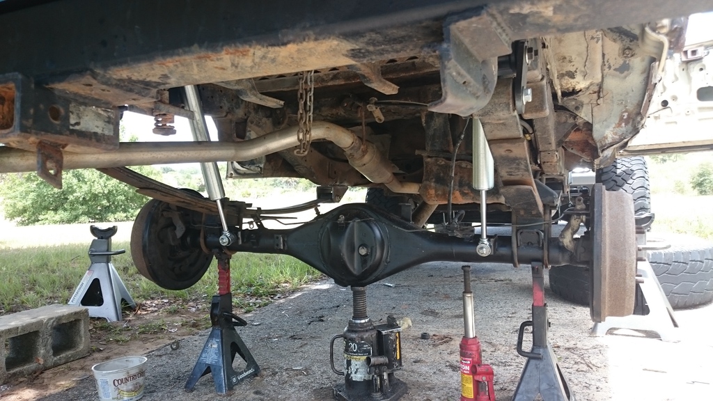

So just in case anybody comes searching for the same answer, I ended up using ford 57"Springs Sky's offroad missing link shackles and bilstein 14" 5100s and using the ford shock mounts,
Here's the links
Axle at droop

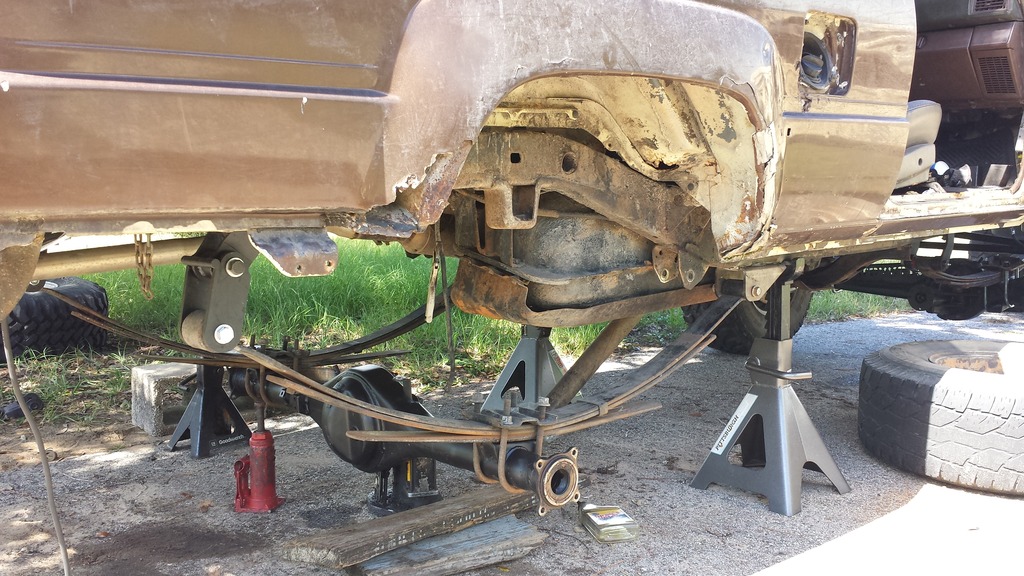

Shock hoops through the floor, cutting the floor wasn't hard, getting the stock shock mounts out was a pain!

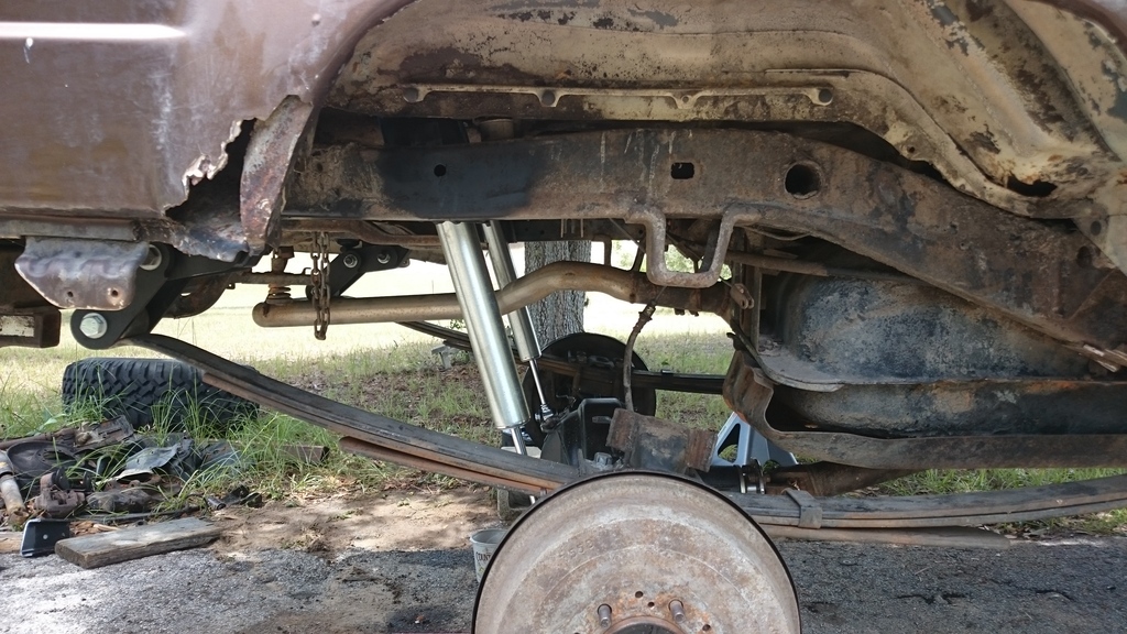

With everything in

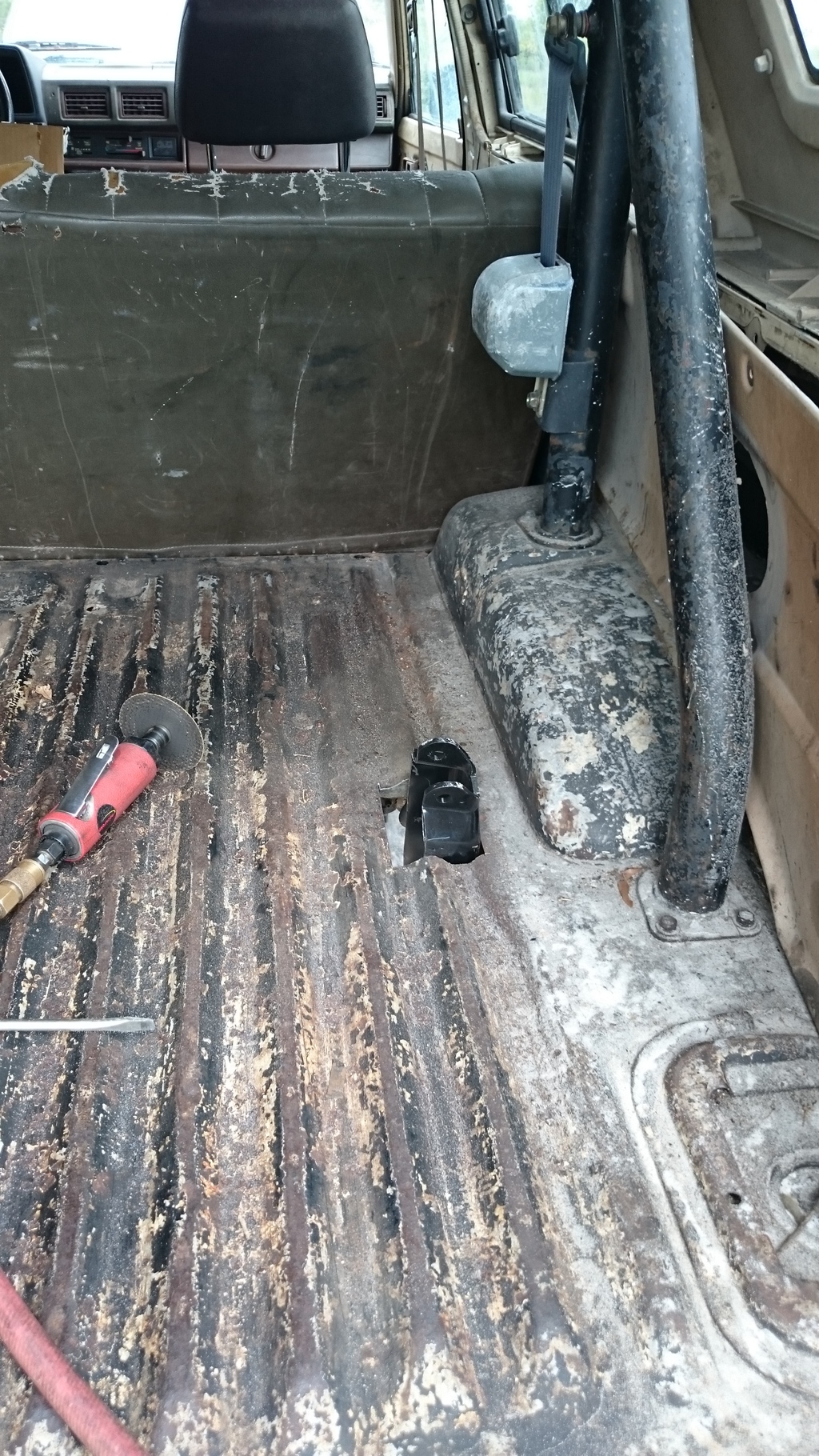

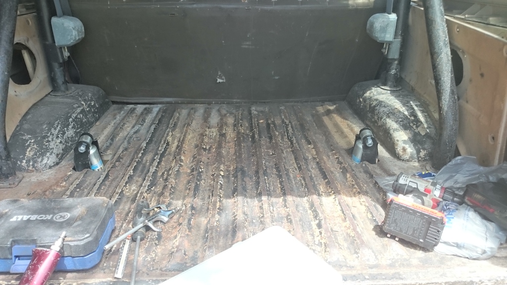

The axle side I used some FROR shock mounts, basically a bolt sticking out with a bracket that forms to the axle
