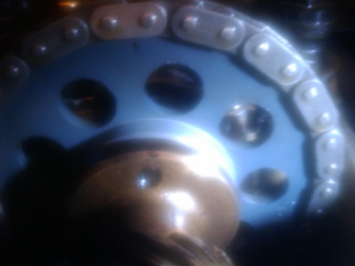

heres my cam sprocket and tdc with everything lined up , sorry its a cell phone pic. iirc the crank dimple is in the middle of the shiny link. It looks right to me but it didnt help in tightening the chain any, I am running 5w30 could this be my culprit???

that looks right but what about the bottom link as well?
And now that I am thinking about it, I never thought of this before now, but anyone know if these links are centered top and bottom, because if not I can see it being possible to put the chain on "inside out". Unless that bright link is only on one side of the link and not the other.
I kinda feel like a newb right now. lol.

you think you feel like a newb lol. nah i think its shiny on both sides. the dimple on the bottom was a little to the left if i rememeber but its been awhile

I've done many chains, but never ever thought of it being uncentered and put on "inside out" if that makes sense. But both bright links MUST line up on the top and bottom sprockets. And like I said that driver side should even when you first install it will make it a little tricky to get the upper sprocket on in most cases.
