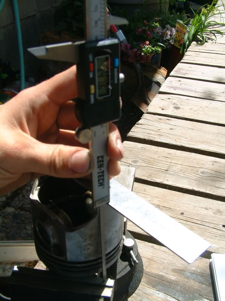

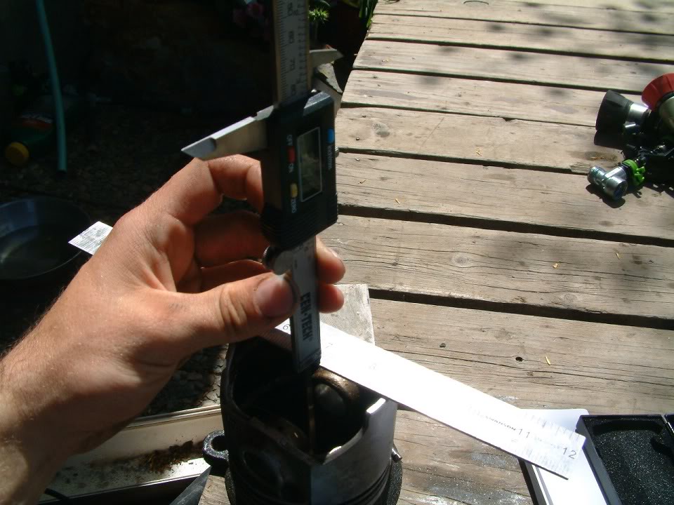

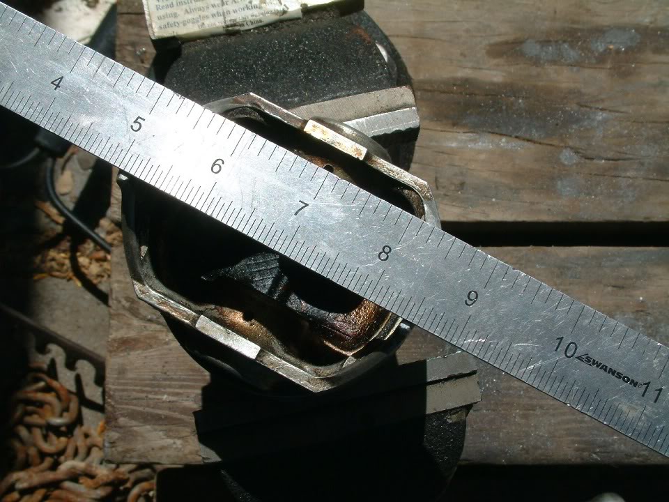

Pictures to determine the depth of the dome section (If new the box may have a cross section illustration)
You will need the pistons removed and taken to a reputable Machinist's shop.
Make sure before you go down to the shop that they have a 4 jaw lathe.
Make sure to mark the front of the piston with a punch or something, at the wrist pin boss, for installation later. Unless it has the cutout on the rim of the top ring land, the machine shop will remove the arrow that points front!
Have the machinist only remove the dome!! None of the ring land area!

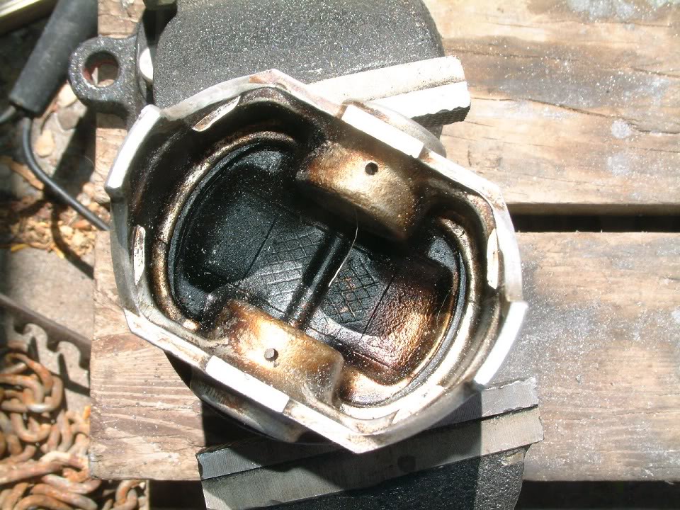

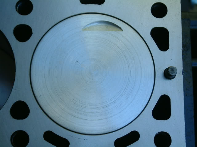

Picture of the top of the piston after machining (installed)
The valve relief's are cut in two positions. one relief in the front position of center line and one in rear position. So you have two pistons in front and two in back. the order for assembly is cyl #1 front, cyl #2 rear, cyl #3 front, cyl #4 rear. The same placement as the valves on the 22RE head. They were cut by the machine shop in standard position using a scrap 22RE piston for a guide.
This was a standard style piston with the dome on top of it, looks like a volcano.
After the machine work is done to the tops assemble the short block as normal. Everything according to the FSM. Check your deck clearance with a dial indicator. Clearance must be +.006 or less. Mine came out at -.012 to .009 between all 4 cylinders and works just fine.

How much material is left on the top of that piston specifically where the new valve notches were cut into the piston? And which timing kit? How did you correct for chain length differences. I know you mentioned the adj cam gear.

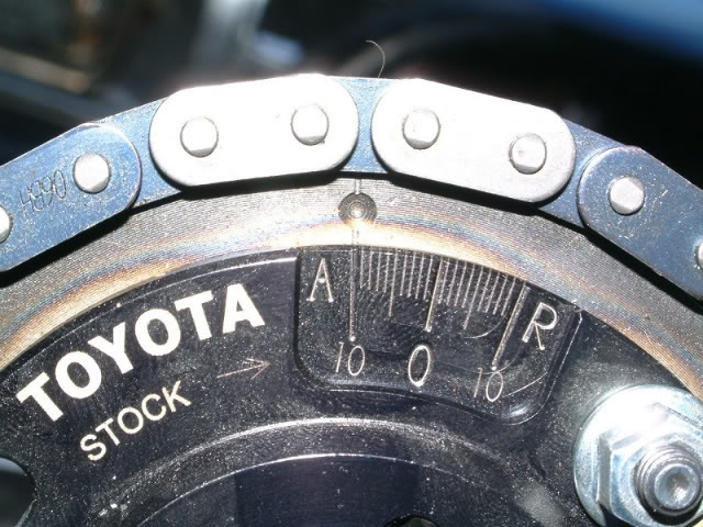

Once the short block is assembled assemble the rest of the engine with the Adjustable timing gear on the cam.
Use a degree wheel to get the cam timing right.
Picture of my timing at 1* advanced
The length difference between the 22R head and the 22RE head is where that extra 9* advance comes from, as well as .010 block decking and .010 head decking.
If you have your block decked and your head decked quite a bit you may have to put in a half link in the timing chain. the standard type chain is 06B so a half-link for that type chain would be required. I found one on amazon for less than $10. The only way to really know if you will need one or not is to assemble and check your slack. I did not use one and I have an incredible amount of slack on the passenger side. But the tensioner still has ~1/4" left before it hits the stop.
I reused the original passenger side timing guide (steel with no wear) but during installation I put the upper bolt in the far left hole to relieve more slack. And it puts more chain contact on the cam gear

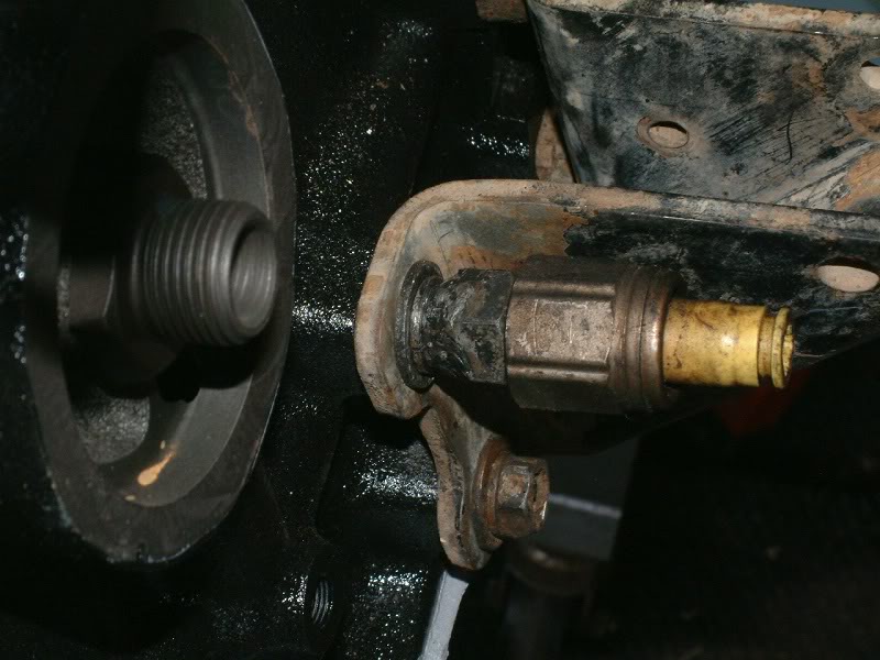

Ok next thing is to find a place to put the Knock sensor. Thanks to Marlin (over at MarlinCrawler) the solution is simple.
Since there is no place on the block to just put it in and according to LCE a relocate is required for forged pistons this is a good way to solve the problem. A 12mm X 1.25 nut welded to the engine mount bolt (make sure it had the dish in the top of the bolt) will allow the sensor to bottom out on the land not on the tip. During welding I used a engine stand bolt to make sure the threads in the nut didn't foul up. And made a good ground point for the welder

With all this advancement in the cam timing, I had to ream out my distributor on the Retard side to get it to time some what properly. My final timing for ignition came out to 13* BTDC which is good for me at high altitude and high compression. NO PINGING!! That's the important part.

The .075 was what was removed to flatten the top. Still has more then .190 in the thinnest section, right under the exhaust valve cut.
