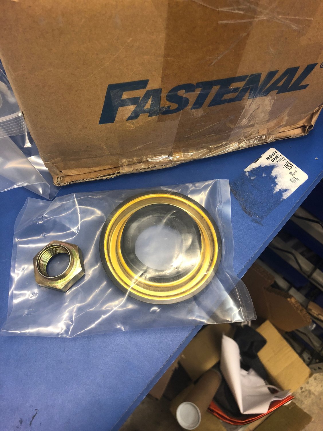

Does anyone know the pinion nut torque spec ? My rear end has been taken apart twice before as there are 2 different punch marks and also whoever did it the first time left the old pinion seal present so my pinion seal was leaking because there were two of them on the truck . I’m working on a 1986 Toyota 4Runner 5speed 4x4 100% stock
New pinion seal and pinion nut from trail gear

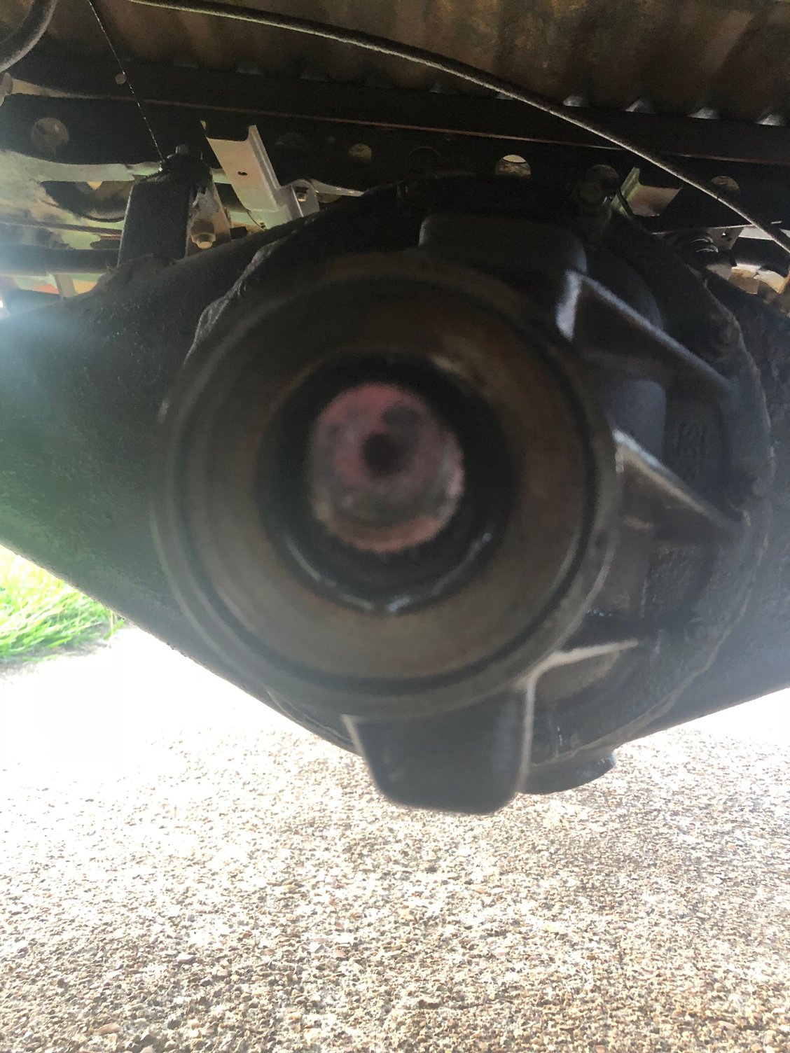

I ended up taking it to a buddy of mines’ shop , he knew exactly what to do and assured me that it’s totally fine the way we handled it . The pinion seal was definitely the issue as it was bent in the upper right quadrant . I managed to snap a pic before we threw it back together , unfortunately I didn’t get a picture of the trail gear seal because my hands were covered in wheel bearing grease as was my phone .
