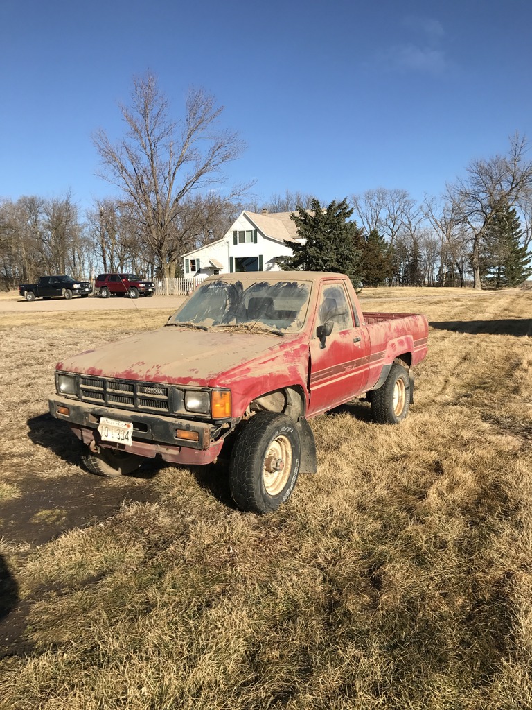

This is right after I towed it home. Dirty, but still awesome. It was sitting in a Quonset with farm equipment. Even 1 tire was still inflated from roughly 15 years ago. Look at that beautiful 4runner in the background!!

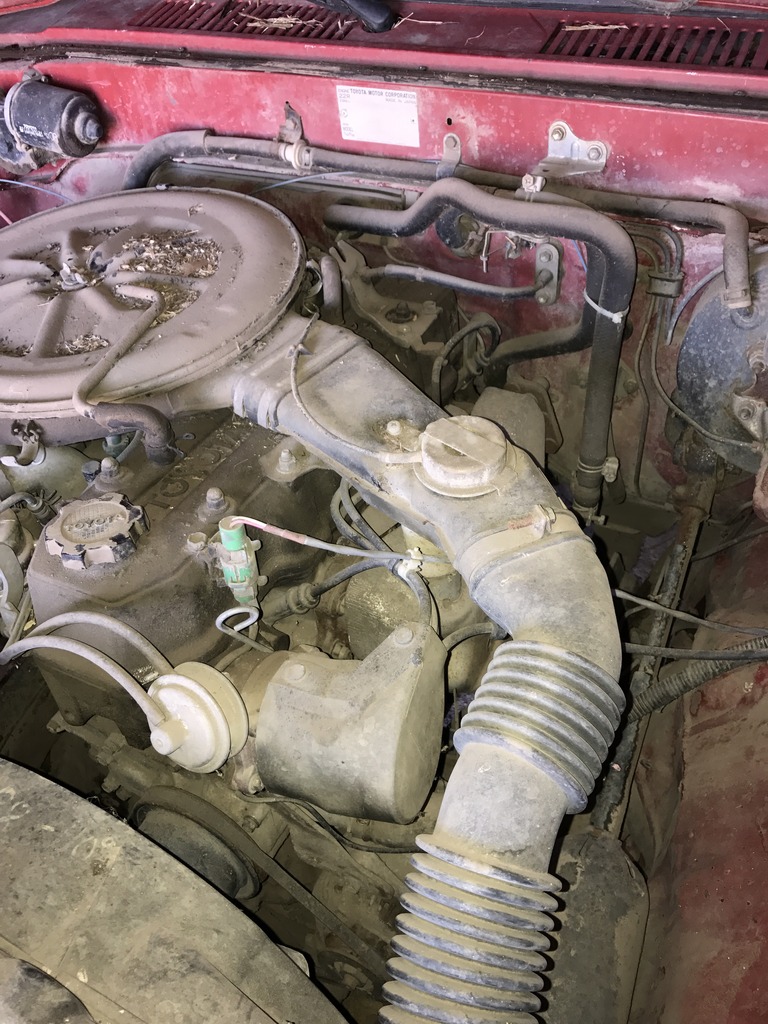

There's the 22r. I haven't owned a vehicle with a carb before and I've never rebuilt or even adjusted one. Also pulling the carb I felt like I was pulling off 100 vacuum hoses. It will be a learning experience.

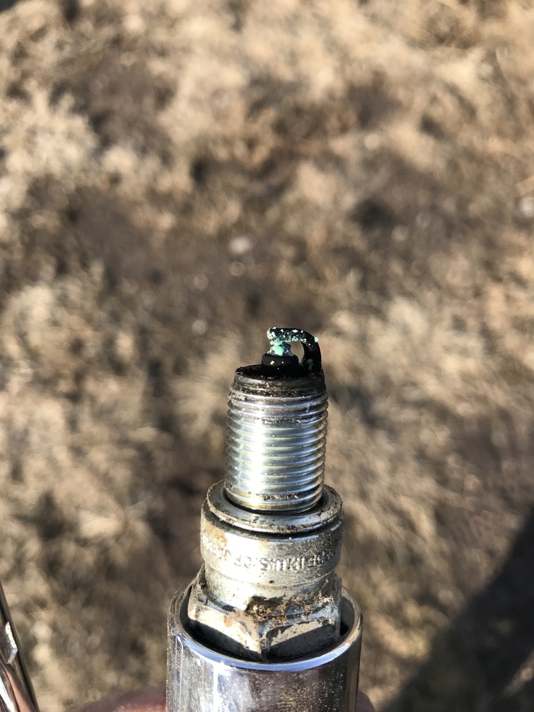

What do you think of this spark plug? What is the green stuff on the electrode. Note: I did change the coolant and it was green.

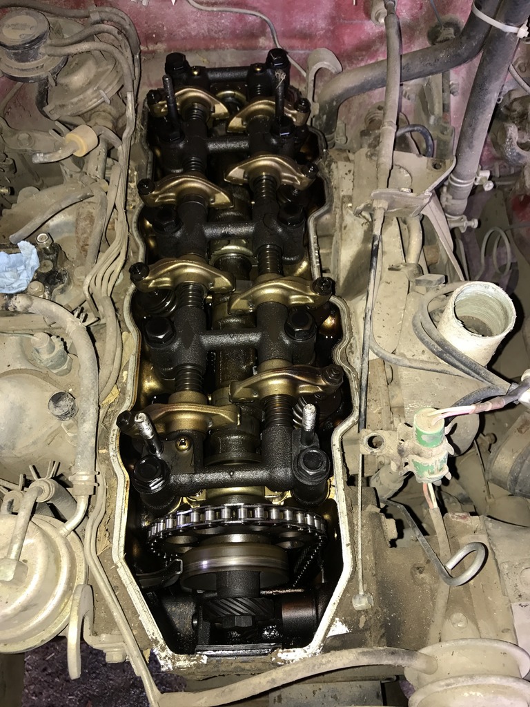

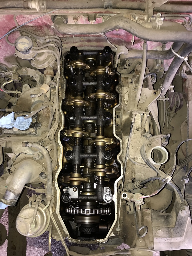

Underneath the valve covers look really clean. I was hoping if there was a head gasket failure it would show here but I don't think so.

So I was able to get the engine free to a certain extent. It's as if I can roll it clockwise or counter-clockwise a full turn until it stops. I can't hear any metal on metal contact but there's definitely something stopping the full rotation. Yes, the truck is in neutral, am I missing something here?
Everything I've seen on the internet basically says that the 22r is an interference and non-interference motor. The PO said he had it running roughly 15 years ago and didn't say anything of it coming to a screeching halt. Anyone got any ideas here? I think I am going to try pulling the valve covers tomorrow to see if anything is wrong with the timing chain. Maybe there is something with the timing chain I'm not seeing with the valve cover on it.

Likely a valve or 2 stuck open. Preventing complete rotation.

An excellent plan , but it won't likely help with any stuck valves.
Each valve should be rapped gently on the top of the spring keeper when that valve is off its cam lobe.
A brass punch is best. All valves should give a little and rebound onto their seat.
Any valve that shows gross excessive lash clearance when off its cam lobe is stuck at least partly open, and may not let the piston pass.
If the engine is cranked with the starter, that valve will be bent. Proceed with caution!!

Upon inspection underneath the valve cover, all springs look like they are fully extended. I did not, however, try to jiggle any of the rocker arms to see if there is a play in any of them. I rented a borescope from autozone last night but it was very difficult to see what was going on in there. Next time I will try it in the daylight and take the rag off of the intake plenum so hopefully it'll let some light in.
How do you give an even blow to the spring keepers with the rocker arm right in the way?

Set the crank to mid stroke, to avoid impacting a piston. Apply pressure to the rocker on top of the valve, or better slide the rocker out of the way squirt with the solvent and ATF mixture and then tap them with the brass drift.

I just had the same issue. I have a rebuilt 20/22r that had been sitting in storage for five years. I did the marvel mystery oil in the cylinders and attempted to turn the crank by hand. It would only go about 270° and then stop. I pulled the valve cover, dropped some ATF on the top of the valve springs and rotated some more. I tapped the top of the springs lightly with a small dead blow when off cam and it turns over very well now. Thanks fellas! It doesn't look like it but this motor has less than a half hour on it.
