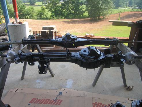

I used 2 coats of POR15 and 1 topcoat. I have read of others doing exactly the opposite. The POR15 protects the metal from rust. It doesn't need a topcoat per se but it will dull up (and I think go more toward gray) if it isn't topcoated. I used 2 coats because my primary concern was to protect the metal. Also I only put on 1 topcoat because I knew that I could always come back and lightly sand and put another topcoat on at anytime. The topcoat isn't nearly as hard as the POR15 so a light sand between cured coats works whereas I don't think it does between coats of POR15 or between POR15 and a topcoat.
I put on one coat and within less than 2 hours was able to put on the second coat. You shouldn't let it completely cure. I think the advice that I was given was it's ready for the second coat when a latex gloved finger still "sticks" to the surface but no paint sticks to the glove (if that makes sense). In other words, dry but still tacky. I followed that advice and mine came out well.
I used the same technique between the second POR15 coat and the topcoat. If you let the POR15 completely dry (like overnight) then the topcoat will not stick. You will have to use their self-etching intermediate primer first. I didn't want to use the primer so that's why I didn't let the POR15 completely cure.
Now it was very hot and humid when I painted mine so your drying time might be much longer than mine. I prepped everything and then started painting early in the morning to make sure that I could get all three coats on everything before quitting for the day. You may not be able to do that if your dry time is hours instead of 1 or 2 hours.
Always pour out just enough POR15 into a small separate container. I bought a few little plastic containers at WalMart and used those. I also used the POR15 pour spout each time which helped keep paint off the lip of the can. If you didn't buy their pour spout then you might want to dip the paint out with a plastic measuring spoon to keep the paint off the rim. Always put a layer or two of saran wrap loosely on top of the can before you put the lid back on the can. If you don't then you won't be able to open the can later if there is any paint at all on the rim. Only use brushes that you don't mind tossing. I used a new one each time. I wasn't going for a show finish so I didn't mind using cheap brushes. The POR15 is very self-leveling and looks more or less like a sprayed finish. The topcoat isn't quite as good in that regard. I think a perfect technique would be to brush on the POR15 and then spray on the topcoat. Spraying wasn't an option for me.
Here's a pic of my axles at some point during the process.

Thank you very much for the time to put that up. Your axles look sweet! Nice work. I'll be painting within the next few hours and I won't stop until the topcoat is done. I'll have pics up later on (prob when the project is done). I've gotten plenty of them throughout the process.
