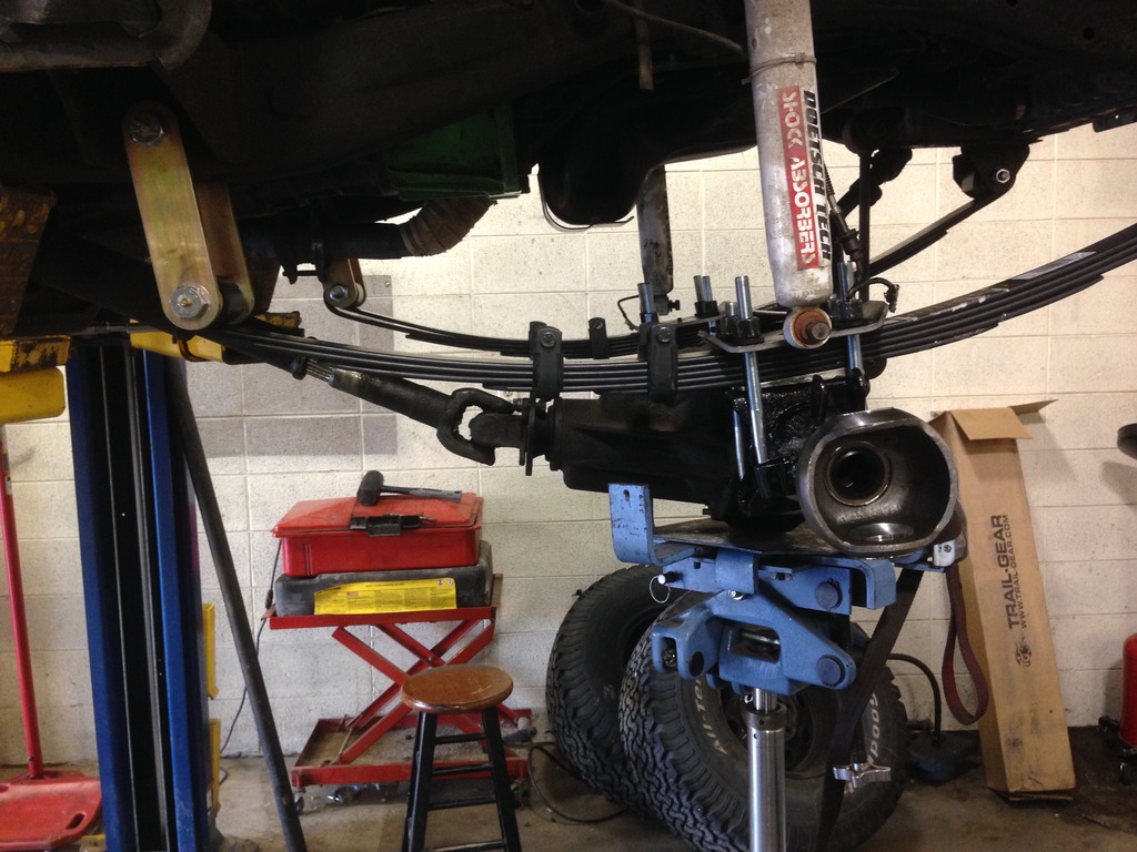

Before. The front drive shaft would not even stay in the slip yoke.

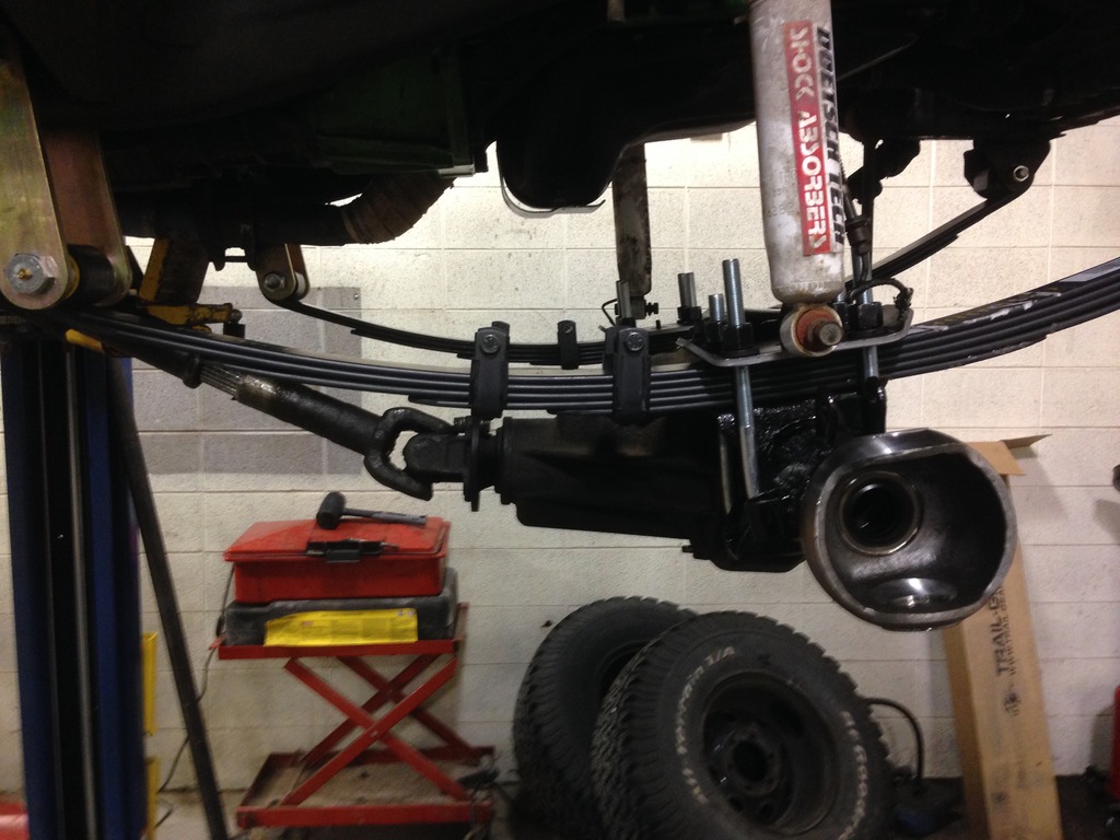

After Cant tell much from the picture. But the angle is a lot better.

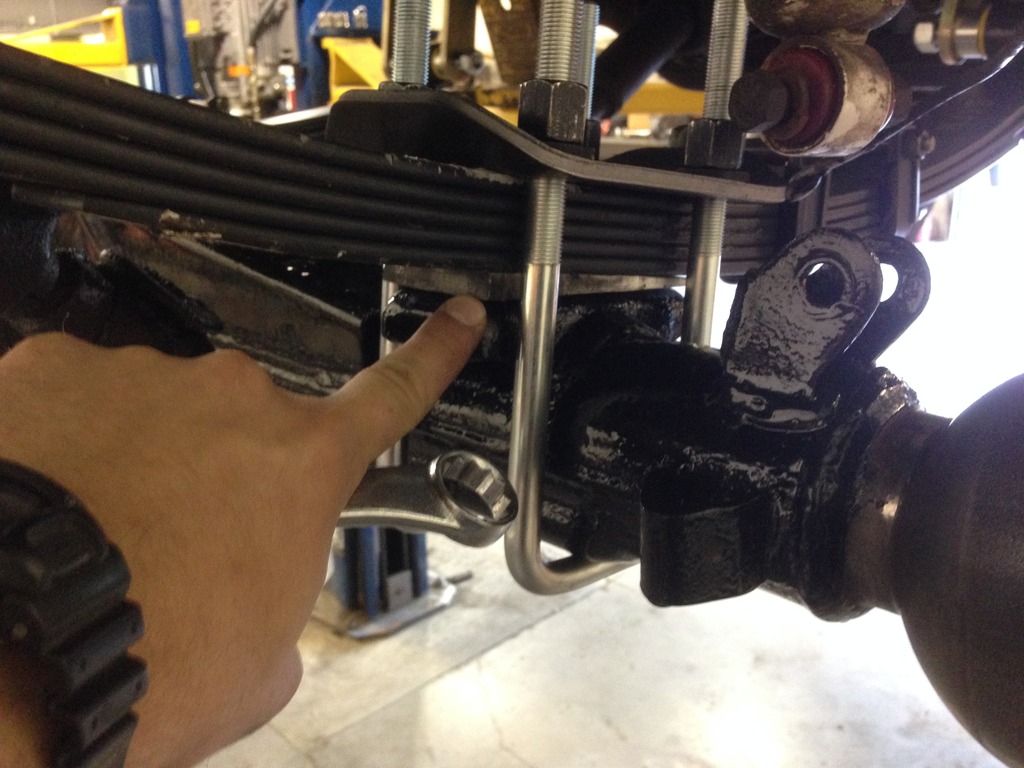

Here is the Shim.

If your front driveshaft was slipping out before the shim was inserted then you may need a longer one so you don't break it under articulation.
Maybe stating the obvious here but I see you've got square ubolts under that axle - shouldn't you be using rounded ones??? Most SAS rigs I see have rounded, unless they added some sort of flat axle brace and require squared ubolts.

I do need a longer shaft, but the angle was greater without the shims. Causing it to be a longer distance from the T-case to the 3rd. Make sense?
I am eventually going to make a square one.
I thought the same thing about the U-bolts. I was under the impression that they all should be round.
This is the TG 84-85 Ubolt flip kit. It came with 2-round, and 2- square.
I looked at a few other axles with the flip kit, and some had the square on the drivers side and some had round......
Who knows. It fits snug against the bottom as that side of the axle has a square type factory gusset on the bottom.
