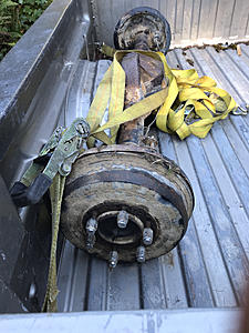

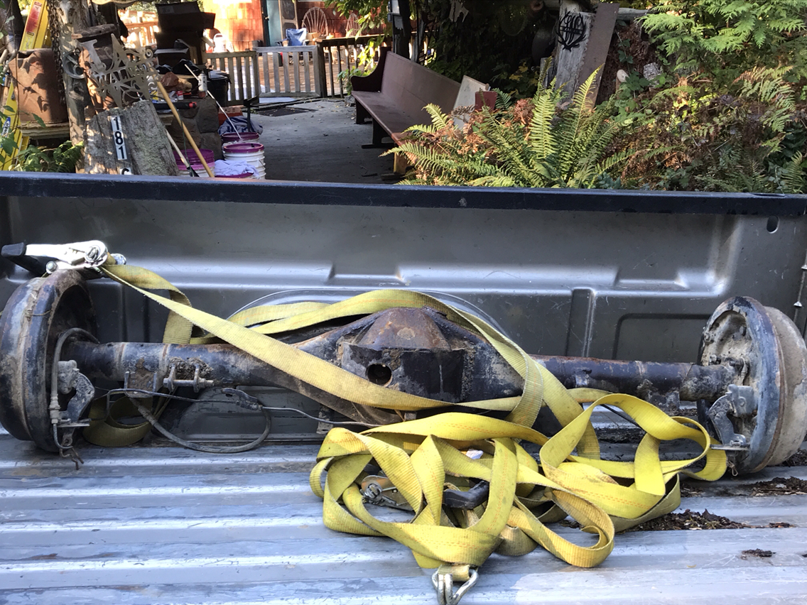

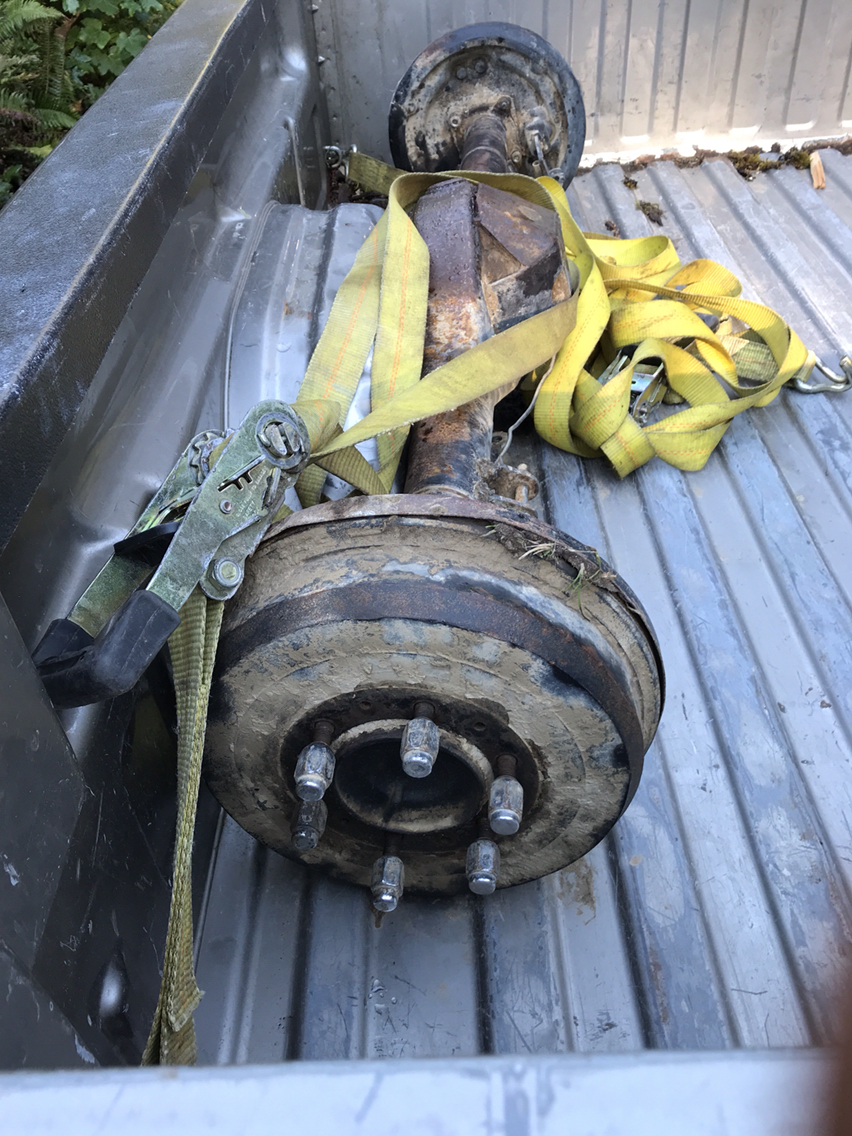

I just picked up a IFS rear end for my 85. Going to put it in when I put the OME springs on. But before then should I do the bearings? Everything looks good but... also are all IFS rear ends interchangeable part number wise or do I need to figure out what tear it came out of.

The E-brake lever is jammed going in to the passenger backing plate. I have messes with it for 3 months and short of disassembly and finding the "replacement part" it is non usable. I have used every lube I can think of and heat. I can only move it with a BFH. So I am putting a wide IFS rear end in. Figure the best time to do this is when I put my new springs on anyways. I realize I might have to make a custom E-brake cable but thats not that hard...
Also having the bigger rear brakes will be nice. Then all I have to do is the IFS hubs with V6 rotors/calipers and master cylinder
It is a V6 rear end based on the brake drum size. And the 3rd I will eventually be using are V6 3rds. Since the brakes are complete I hope it wont be that hard to figure out the replacement shoes...
