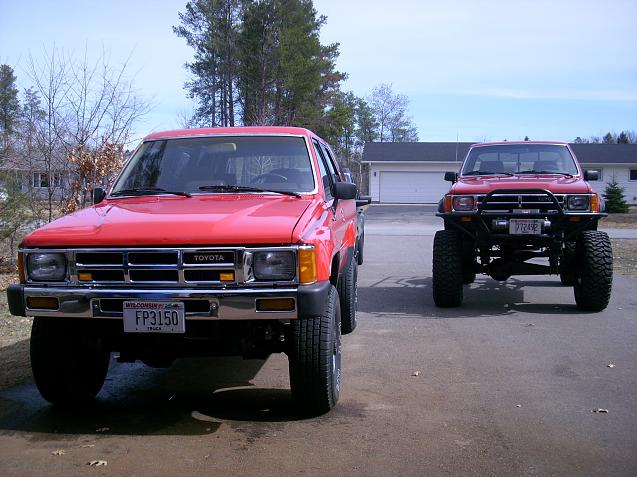

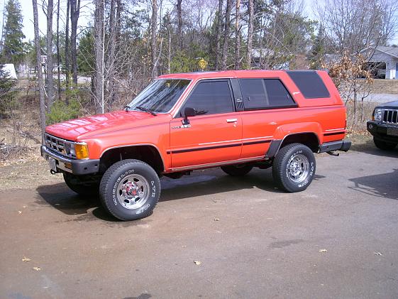

I flew down to Florida to visit my brother and picked up my "new" 4 Runner. Fully loaded with options that all work. Rebuilt motor too. Eventually it will turn into something like my sas'd 87 truck. Plane tickets (My 4 year old son and I)cost me about 130 and burned about 200 in gas driving back, so I guess I have about 2500 into it now. My only complaint is that it was repainted red (now it matches my 87) but it used to be toyota's 2 tone white and gold. I was bummed, but hey, it has no rust and it runs like it should. If any one needs motor pics of wiring/egr or vacuum layouts, let me know its all there.

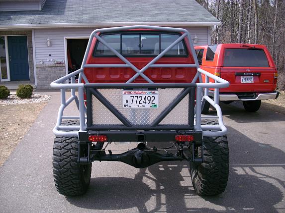

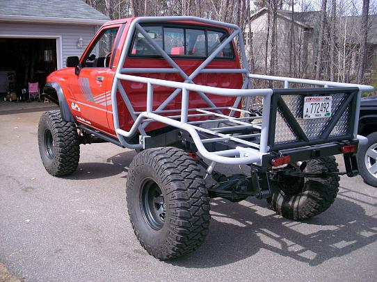

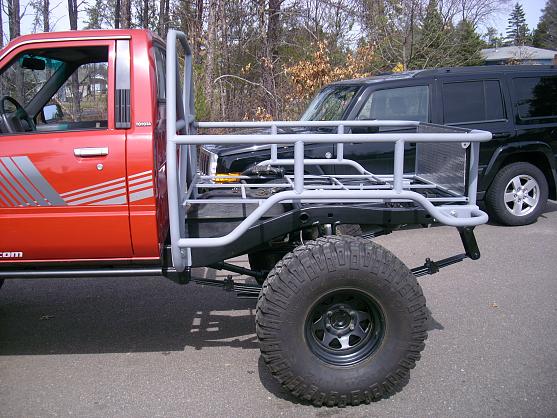

Heres a couple of pics of the bed on the 87. I welded it to the frame originally but decided to cut it off and build brackets to bolt it on with 5/8 hardware. I sleeved the frame too. On the fuel tank side, I welded a plate to the outside of the frame and welded a 5/8 nut to the inside to the plate so that corner is just bolted to the "nut plate". I had it sand blasted at work and acid etch primed. My buddy is going to line-x it and the diamond plate will go back on. I'm curious to see how the line-x holds up to trees and rock, but he offered to do it for free so we'll give it a try.

The truck bed pics. The tail lights go in the rear corners of the diamond plate body panels. The whole damn this is diamond plate. The floor and wheelwells too.

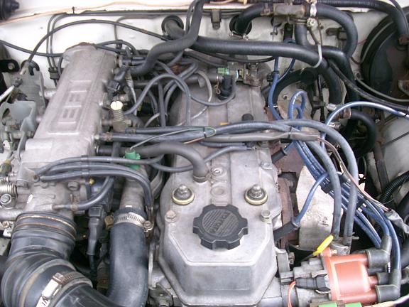

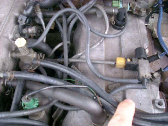

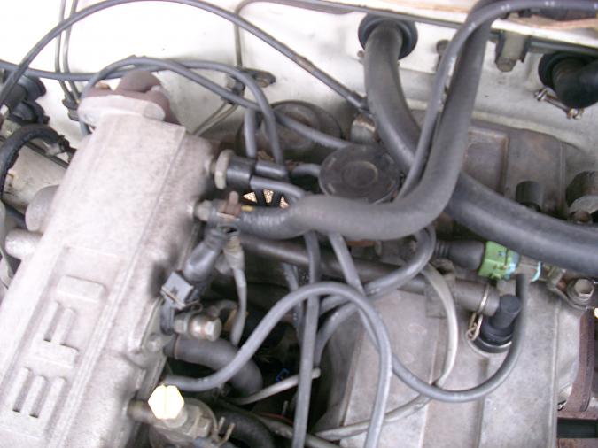

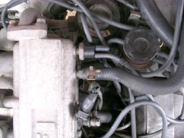

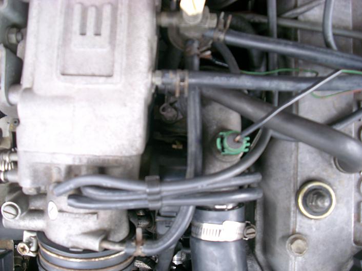

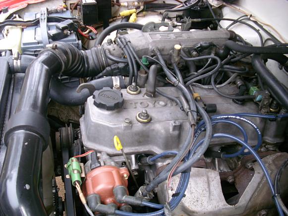

hey if you have time you should post up some pics of your vacuum line layouts and the motor.also nice buy for 2,500 mine was 2,000 and not in that good of shape

Here you go.
Attached Thumbnails The new toy.  85 4Runner SR5.-1985-vacuum-line-motor-pics-001.jpg   The new toy.  85 4Runner SR5.-1985-vacuum-line-motor-pics-003.jpg   The new toy.  85 4Runner SR5.-1985-vacuum-line-motor-pics-006.jpg

A few more.
Attached Thumbnails The new toy.  85 4Runner SR5.-1985-vacuum-line-motor-pics-009.jpg   The new toy.  85 4Runner SR5.-1985-vacuum-line-motor-pics-007.jpg   The new toy.  85 4Runner SR5.-1985-vacuum-line-motor-pics-010.jpg
