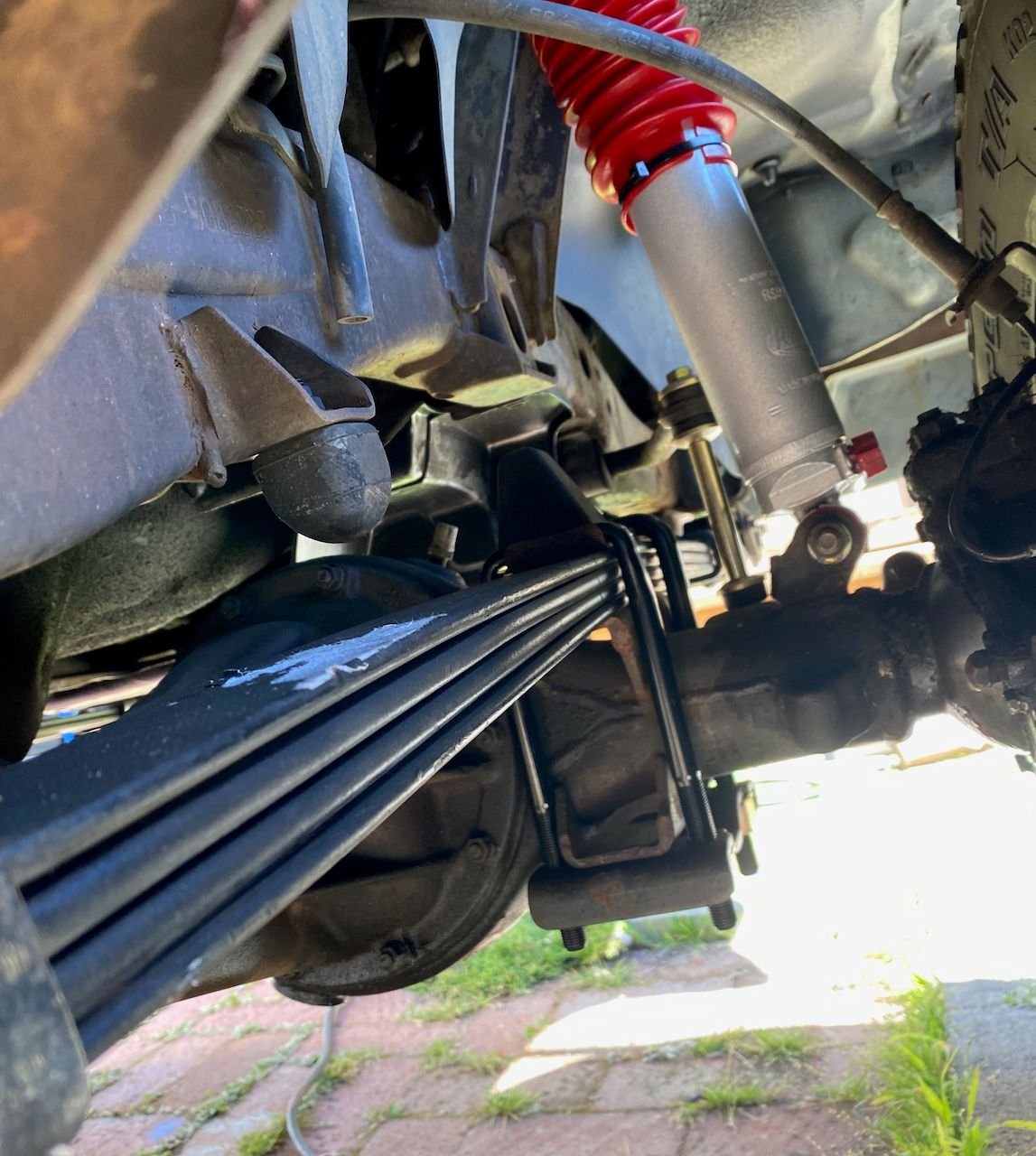

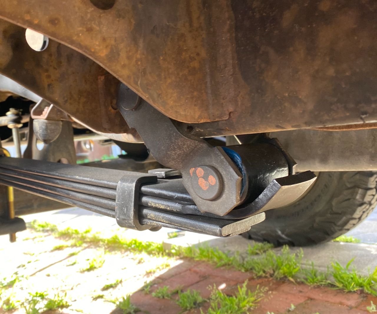

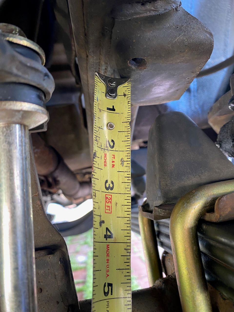

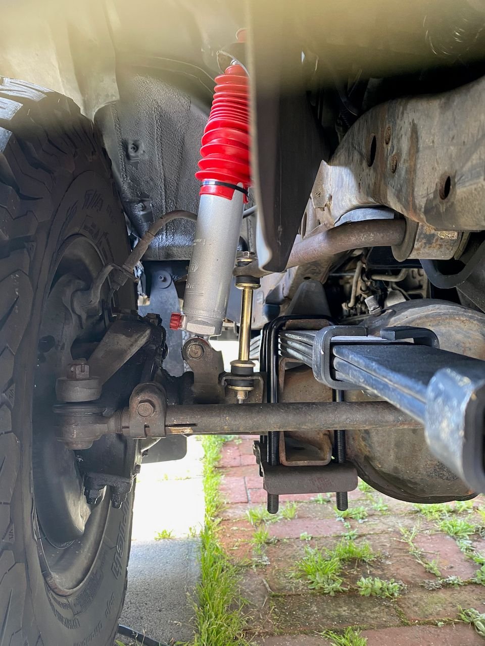

Look at these pictures, as I'm new to this Hilux. My 1985 4x4 extra-cab is stock and has no after market accessories. New LC Engineering springs installed over the weekend and they just seem wrong. why, 1" of bump stop clearance, shackles are riding on frame, and springs have a reverse curve.
passenger side, drivers side is thee same.

After talking to Alcan Springs tech, I know the frame setting on the shackle to be wrong. Waiting on LC Engineering to reply on a refund or replacement. Personally thinking I'd hate doing a R&R with the same outcome, so I'm leaning toward a refund.

i can't imagine what would cause that... wrong springs for the truck? missing a leaf? improper manufacturing? they are alcan? what did the alcan rep blame it on?

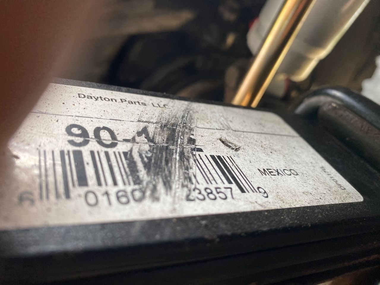

Springs are not Alcan. LCE had them drop shipped from Dayton LLC and looks like they were made in Mexico.
here is the tag on them

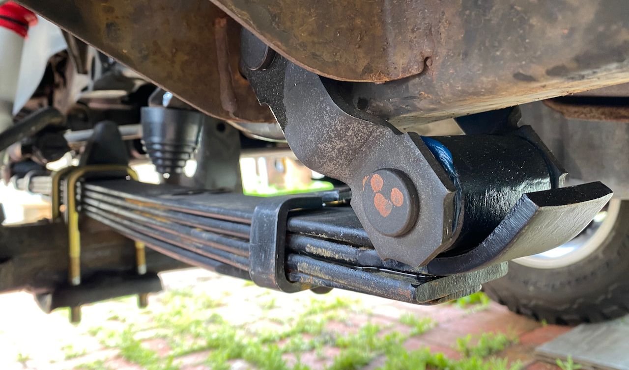

When you get your refund I would use that money and take the new springs to a spring shop and have them worked on. I did a similar thing on my Suburban, I had another leaf added and had them re-arced. They still lay flat, but lifted the truck about 2-3 inches. No
w there not bent over backwards

I was told by Sky's Off-road Design, an extended shackle like their 2" longer Boomarang might flatten out my reverse curved springs. Looks like you have extended shackles so it might work.

It's not going to flatten out the spring. Spring will still be bent backwards....all it will do is lift the truck 1''. Point I was trying to make is I installed 40 year old factory springs and they are not bent backwards like your brand new ones. To do the conversion I built a front x-member that is 1'' thick before the hanger was installed, so to get the correct geometry so the spring is level I had to use the lifter shackle

I ordered set pair of front springs from Alcan, they are 4/5 weeks out. So now having my old leaf springs and these new JUNK LC Engineering/Dayton Parts springs I thought I had nothing to lose.Get some service out of them until new springs arrive, add a leaf and see what happens. A fare amount of work and the added leaf gave a 2" increase at the bump stops and a 1/2" clearance between frame and shackle. That is until I drove 50+ miles during which the two main leaves negative arched more. Both spring packs collapsed down to 1" bump stop clearance and the frame was riding on the shackle again. Metal must have not been tempered to spring.

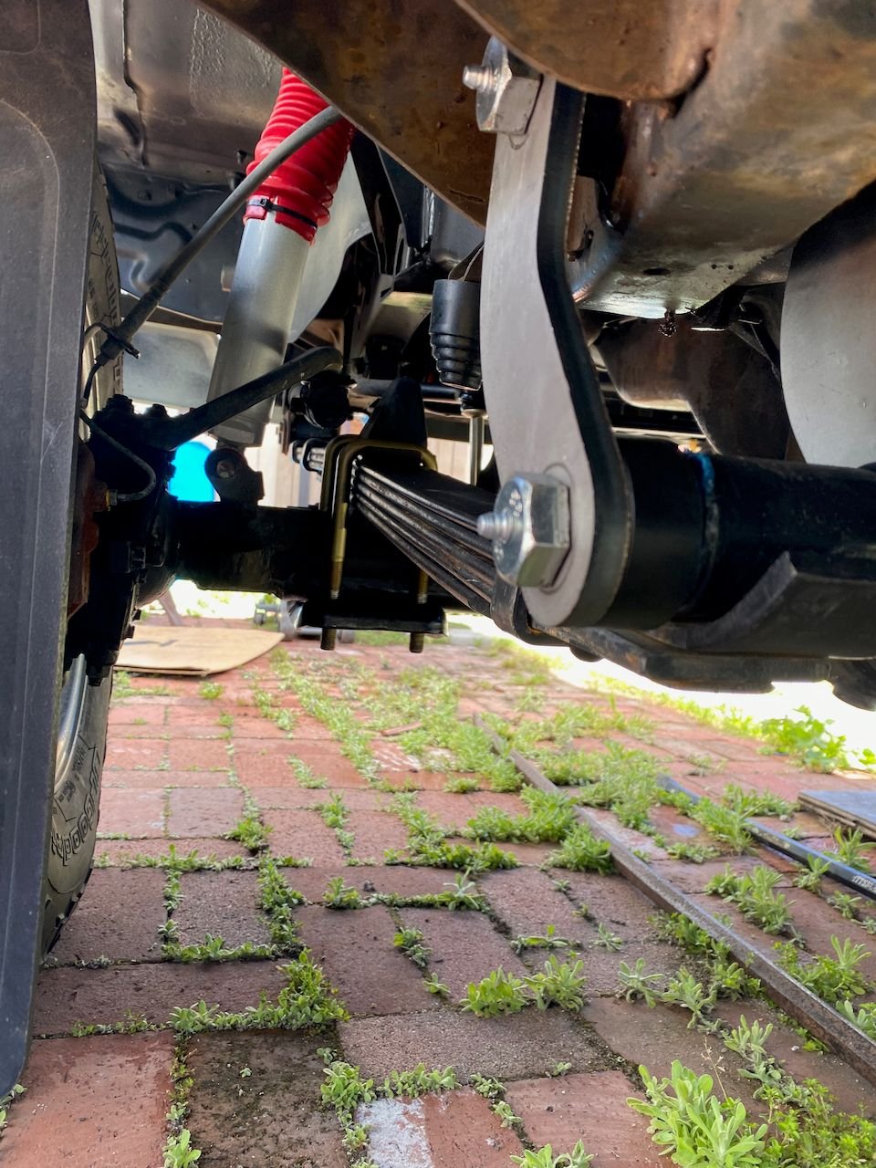

Finally got my refund. Also got the Boomerang shackles installed and the ride is much improved
Once the Alcan Springs arrive/installed I shouldn't need these lift shackles.But for now and the next month or so these shackles are worth every penny IMHO and that's all that counts.
