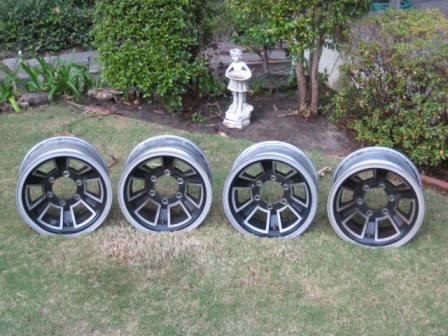

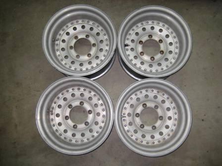

We like the Centerlines and they are period correct, for the most part, but the truck came with some Superior Industries Magnus wheels. The tires were thrashed 31x10.50R15. When we stepped up to a 32x11.50R15 the sidewall of the tire didn't have clearance. The Centerlines are a 15x8 w/ 3.5" backspace the Magnus wheels are 15x8 with a 4" backspace. I have been kicking around the idea of mounting the Magnus rims on my 1986. I have heard the Magnus rims are the rims many race teams used back in the 80's. They remind me of the rims from a 1960's Dodge Charger, like the ones on the General Lee.
