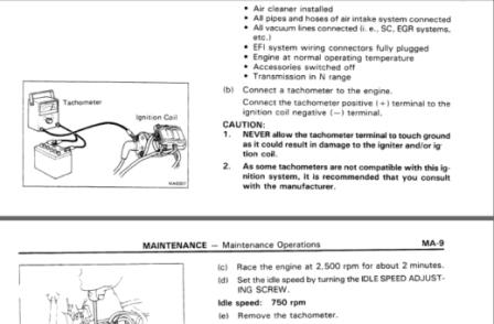

I just turned the idle screw down a little and it fixed the idle issue with the brake... However the tach doesn't work and I can't get our old school engine analyzer working bc idk where the green wire should go, I'm used to working on chevy small blocks where it goes on the coil itself
Old 09-14-2012, 04:06 AM
Crtzlow's Avatar
Join Date: Jul 2008
Location: Southwest, MS
Posts: 82
Received 0 Likes on 0 Posts
Hook the tach up to battery as normal and attach to the coil at the (-) negative post.
If you don't already have the FSM it is very helpful. You can find it here:
http://www.ncttora.com/fsm/index.html

I dont recall my coil having a terminal on it. Do all of them have a terminal on them? Ive been wrong before though.
Old 09-14-2012, 09:26 AM
Crtzlow's Avatar
Join Date: Jul 2008
Posts: 82
The coil should have a cover over it. Unplug the plug wire and the cover comes off to where you can get to the terminals.
