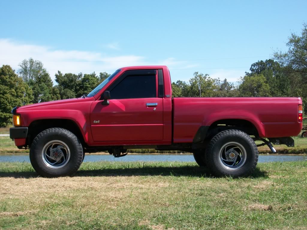

my front leaf springs look flat or almost have a negative arch to them. Im wanting to do about a 3-4 inch lift, nothing to extreme, just like a basic lift kit. Im not sure what brand to go with but ive been looking and reading all over this place for info on whats the best bang for the buck.

Pretty typical for 25 year old leaf springs.

You basically have 3 options on the springs, one is a bolt on set using some name brand, off-the-shelf springs (Rancho, ProComp, SuperLift, etc.). The second option is one of the more specialized spring kits that may require some welding or other modifications. The third option is get some springs custom built to fit your truck and lift needs.

Do new leaf springs sag down this much, even ones that are stock height? And how much extras are needed with like the 3-4" kits that come with front and rear leaf springs and shocks. would i need to do anything with the brake lines and steering componets?

Don't recall how the new springs looked, but they are likely flat maybe a little reverse arc, can't have a lot because the stock front leaves don't really have any arch to them:
- http://www.4crawler.com/4x4/4R_suspension.shtml
3.5" lift spring above, stock spring below:
You can read the above page for what needs to be done with a 3"-4" lift.
