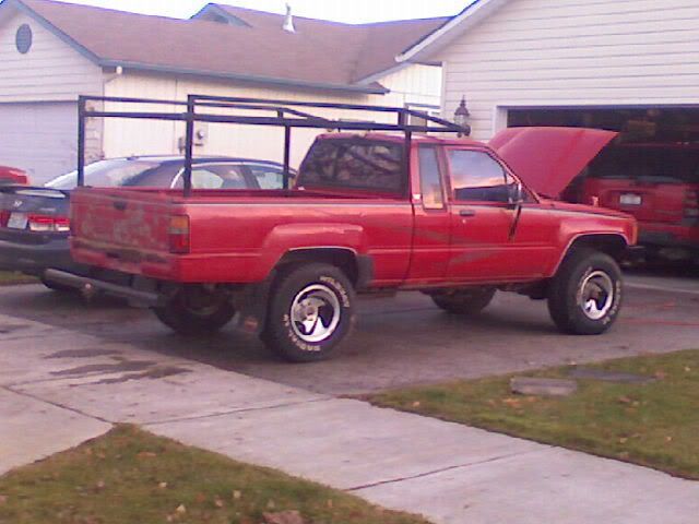

Pic of the truck:

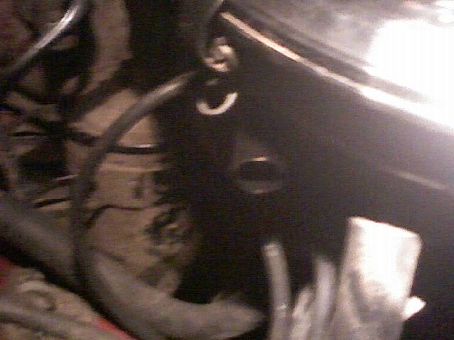

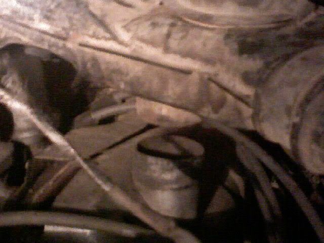

There are some hoses/connections that appear to be missing: Any ideas on these, if you can't see them let me know and I will try and direct you in the pictures as best as possible.
Sorry about the quality, all i had was a flash light and my phone

first pic has to do with smog..second pic is just an air vent type thing to help cool the exhaust manifold..and i cant see anything in the 3rd pic..lol

The third picture, it seems there is a place where a hose would fit over at the bottom of the black box. Maybe not, just seemed like it. I don't know what that thing is honestly.
