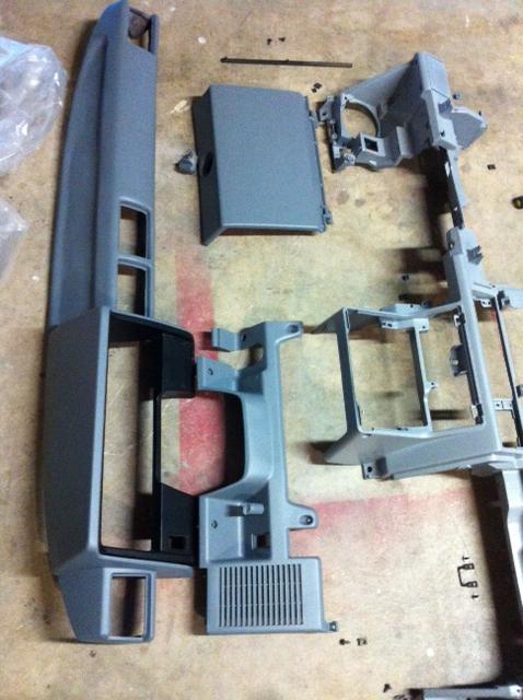

Hello so I got tired of my faded blue interior and took it all apart today cleaned it up and primer it.. Now I was looking for a dark grey matte or satin but cant find any.
So i need someones else's opinion because this light grey is kinda growing on me...
Light Grey
OR
Dark Grey

Here it is placed together and strangely the first can of primer was darker than the second....

I would say darker.
Old Feb 9, 2013 | 07:28 PM
Roark's Avatar
Joined: Jan 2011
Posts: 1,051
From: Memphis, TN
Definitely darker. The dark grey looks good with anything.

darker colors will hide more dirt and show less wear and tear on the inside. Lighter colors will almost amplify the wear and tear on the interior. So what do you plan on doing with the truck?? Also the darker color will absorb more heat and make the inside hotter. I had a flat black truck with black interior... The summer time was almost unbearable....
Old Feb 10, 2013 | 07:52 AM
MATTSRED's Avatar
Joined: Oct 2008
Posts: 137
From: OREGON
Well thanks for replies i'm gonna go with dark grey because of the fact that lighter will show more dirt and imperfections... Should be done later today maybe ill post some pictures up.

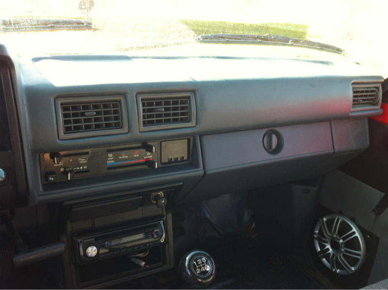

Sorry never looked back on this but yea I think it looks a million times better than what it did....
Just remember light coats and for the best results I removed it all.
Attached Thumbnails Interior color opinion needed!-image-692551118.jpg   Interior color opinion needed!-image-712765033.jpg
Old Mar 10, 2013 | 03:55 PM
HunterRunner0122's Avatar
Joined: Mar 2012
Posts: 53
From: Ringgold, GA
That looks awesome! I'm for sure doing that when it gets warmer! What products did u use?
Old Mar 10, 2013 | 06:03 PM
MATTSRED's Avatar
Joined: Oct 2008
Posts: 137
From: OREGON
Cleaned them really good.
I used almost 2 cans of primer (that bonds to plastic) Couple coats each.
Then got a couple cans of Dark Grey Vinyl spray paint at autozone about $7 each.
And that was it!
