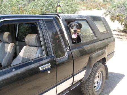

One of the reasons i went after a 4runner shell is because of their strength, I even stood on top of the shell (I weigh 190) & it had very little flex & weight was concentrated. Heres a picture of the overhang I'm talking about/

So just to clarify, you're wanting opinions on which dimensions would best utilize the space the shell offers?
If that's the case - I would have it cover the shell minus about 2-3" on each side (for aesthetics).
This will of course be dependant on the availability of such a rack.
Then, for the overhang - if you're planning on putting a lot of weight on the front part of the rack then I would limit the overhang to about 4-5 inches for stability.
If you're not going to have a whole lot of weight up there then you could extend it out as far as you wanted and just put light things up front and heavy in the rear (which is the best way to do it anyway).
Did that make any sense?
