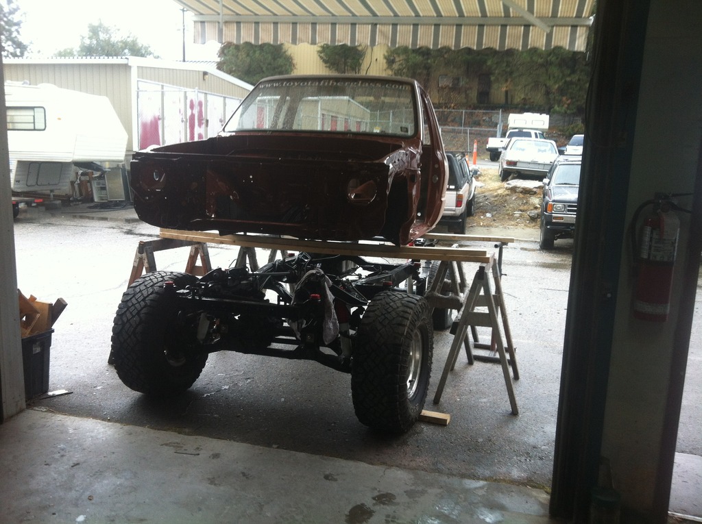

no problem ... it can be done by yourself .. infact , I did on this one .. no fancy lifts or forklifts , or 10 guys .. just me .

Thats great, I was wondering how i was gonna do it
Thank you. did you write up how you did it? Or are you the incredible hulk? LOL!!!! Thathelps alot
