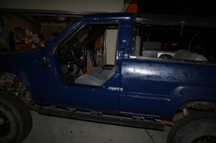

Doors cut down to desired design...
Form card board to the shape you need and cover in duct tape...
I out-lined a rough edging on the door so that I could trace it onto the fiberglass later...
Fiberglass being laid...

Pics
Here they are, one is trimmed up and the other is still the way it came off the card board...
On the door...
Old 12-13-2008, 12:40 PM
Newb's Avatar
Join Date: Mar 2006
Location: Duncannon, PA
Posts: 115
Received 0 Likes on 0 Posts
Supplies
All painted up...

Thanks... I could have spent alot more time on them but I personally don't care to much about the looks. I smoothed them out a little with bondo but they are deff. still on the ruff side. They should serve their purpose well though...
I added some simple sliding latches to the outside of the door and mounted the mirrors. It's not the flashiest of setups but I didn't feel like trying to use the orignal guts to come up with something else.
