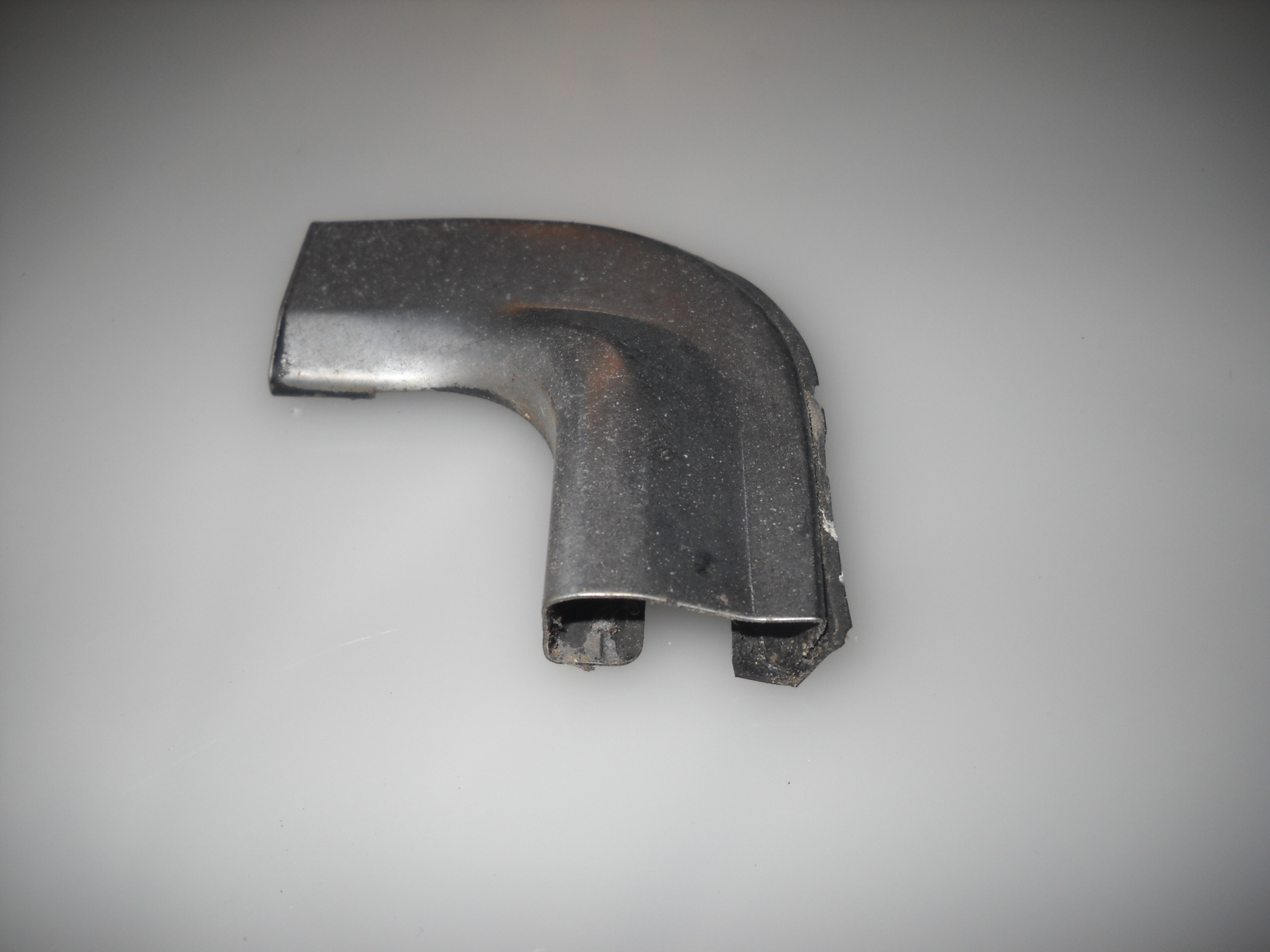

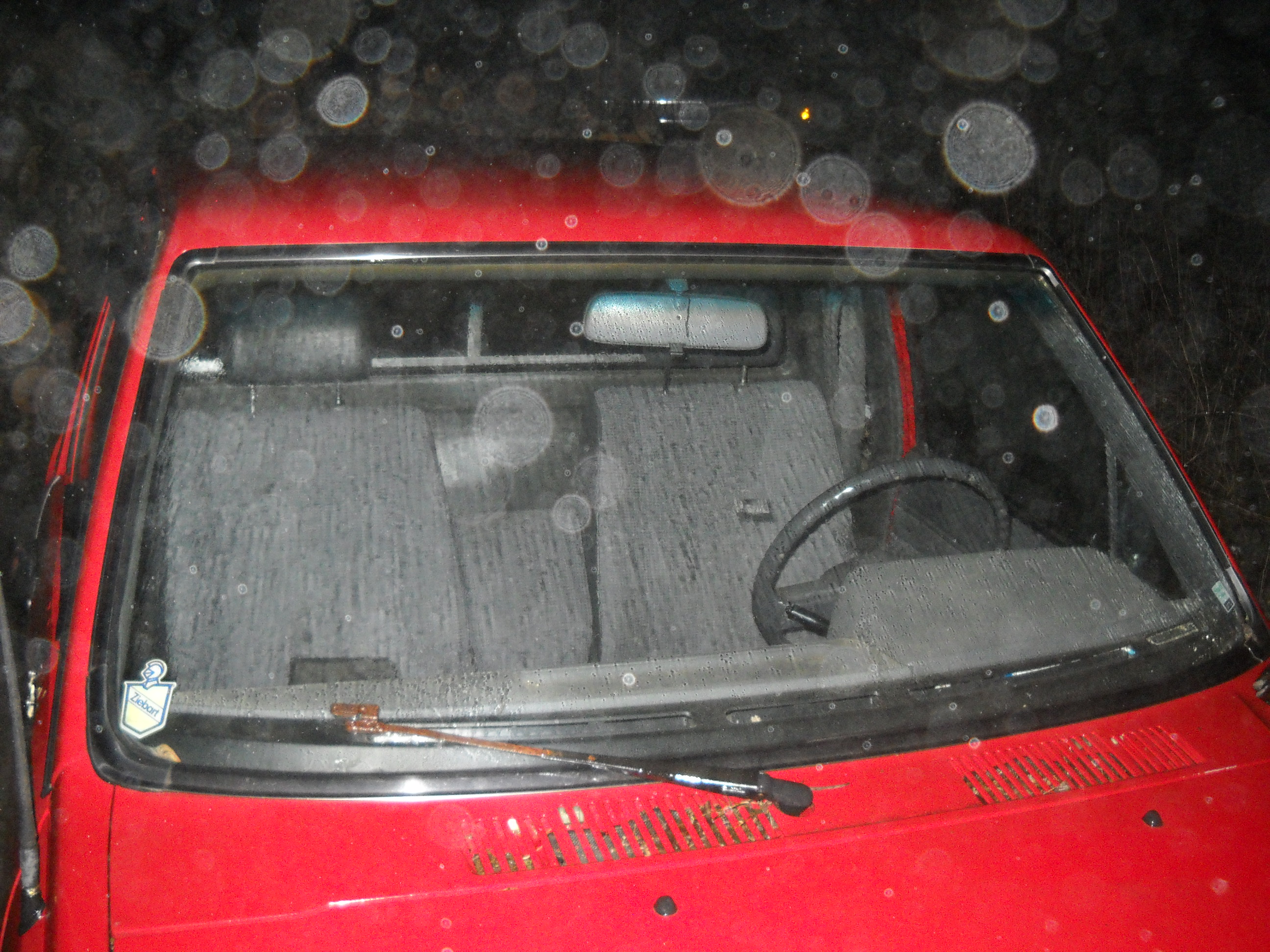

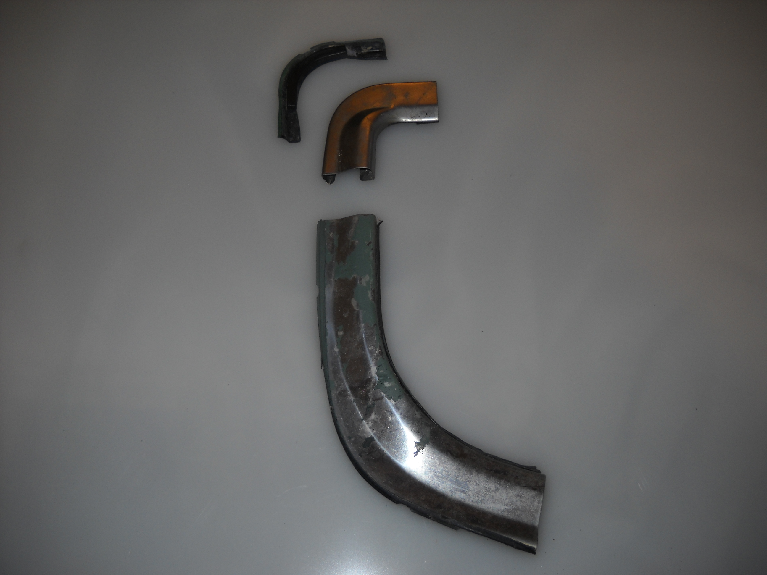

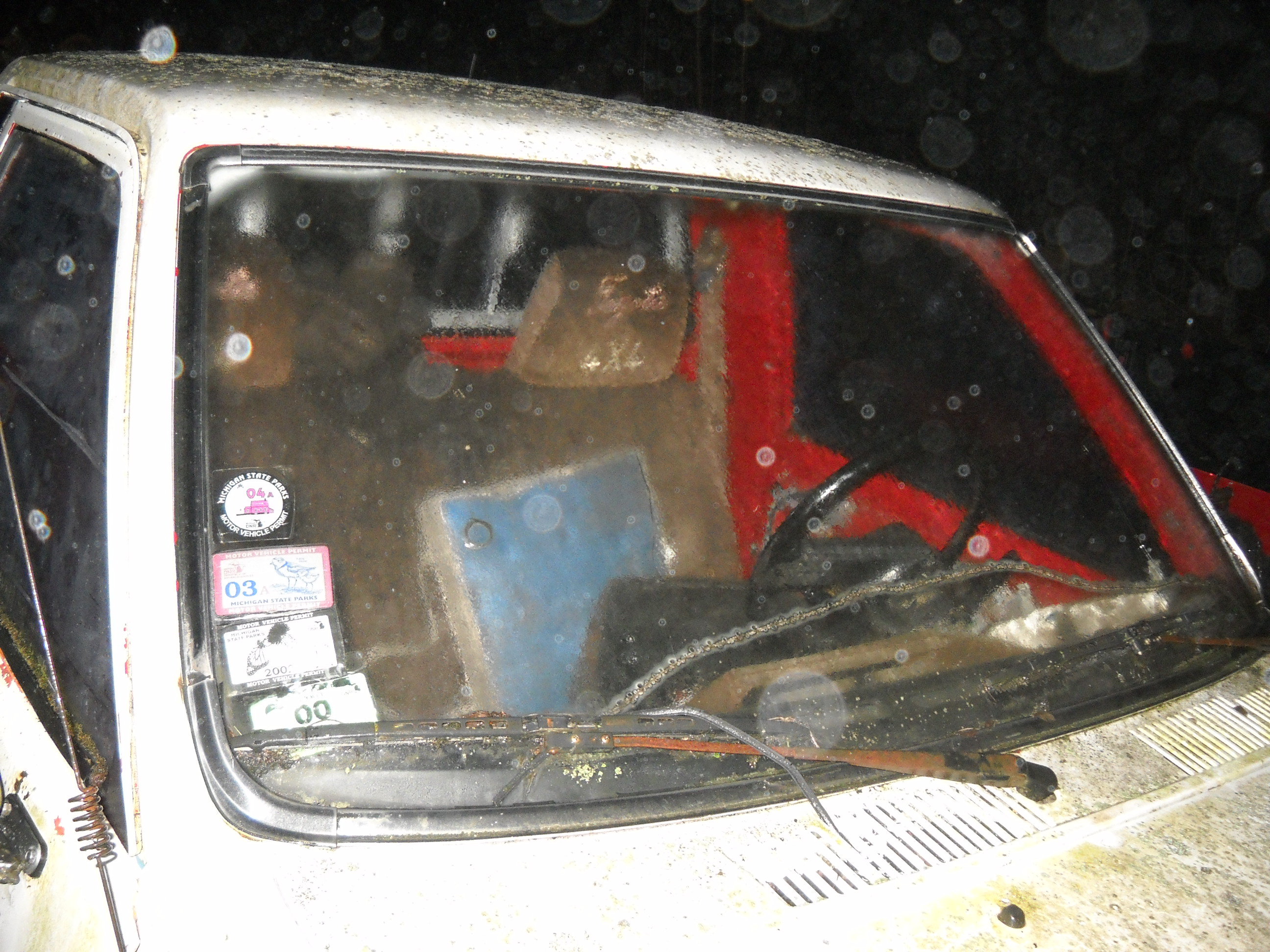

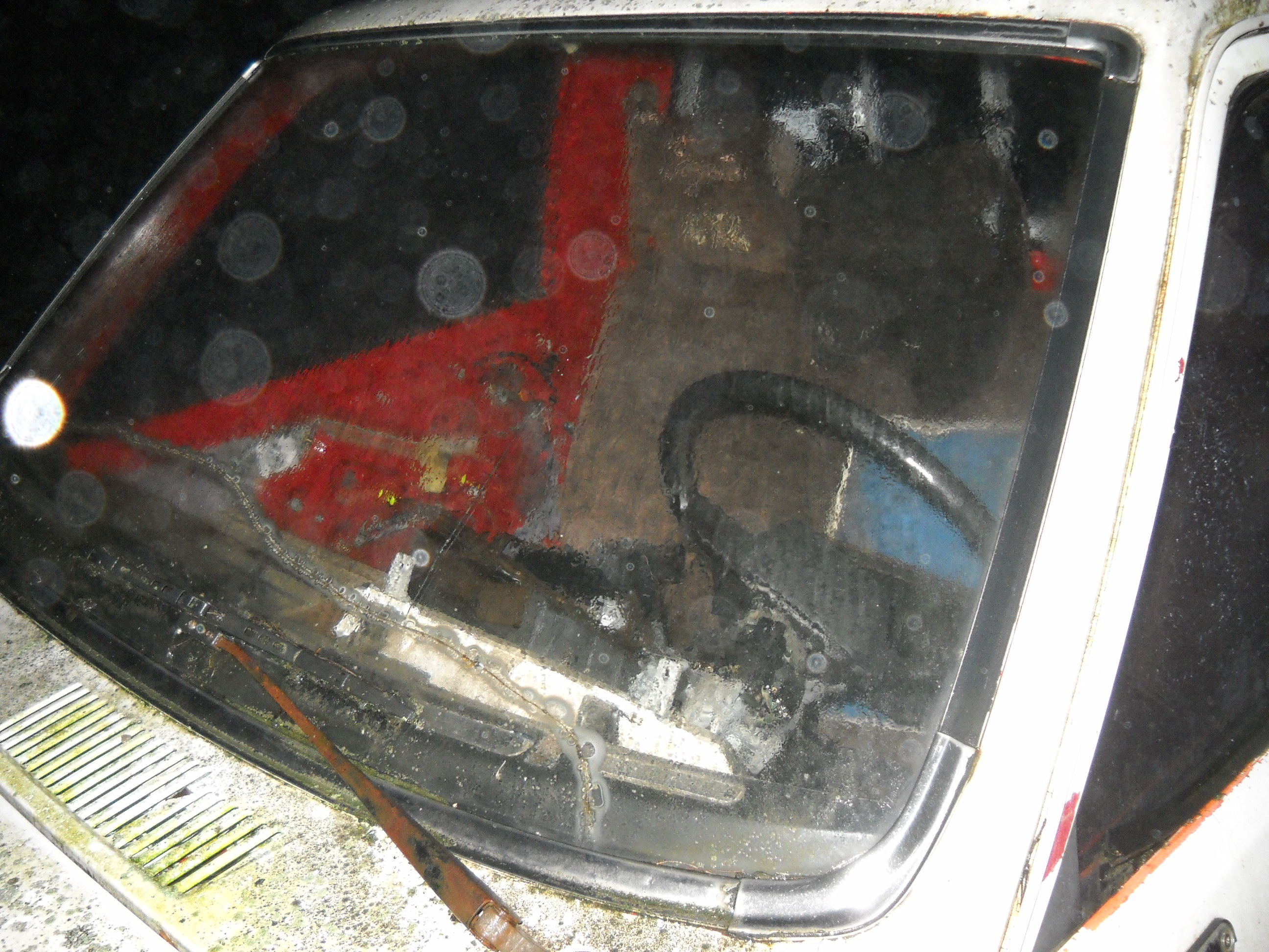

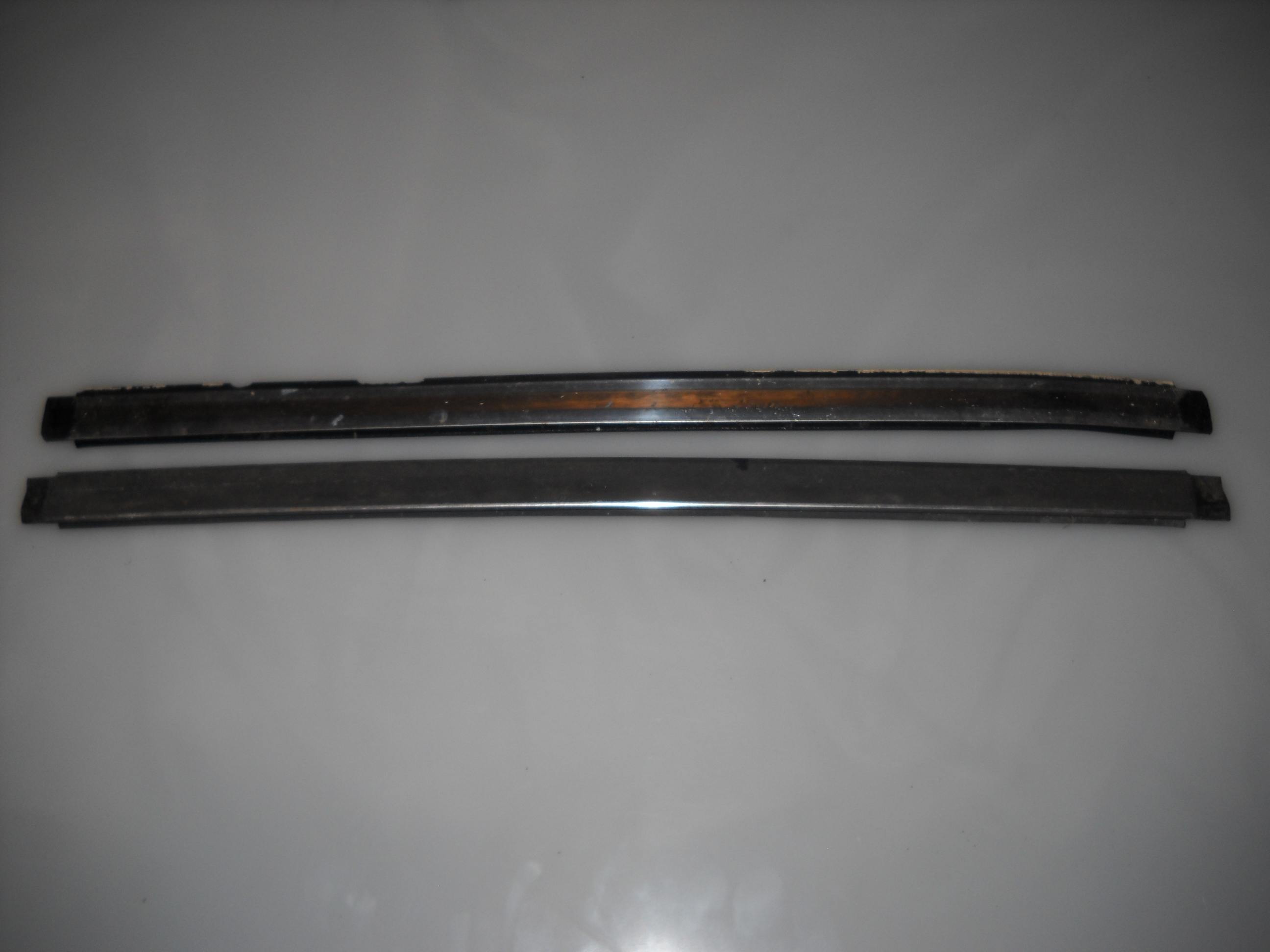

Camera wasn't too happy taking it out in the rain lol, focus is a little off on some of the pics. Anyway, first pic is driver's side upper corner, 2nd pick is passenger side corners, and last pic is the passenger side uprights (both are factory black, one just has the paint pealed off most of it, chrome one appears to have a slight bend on the right side too). Do you need the clips for the side trim L5wolvesf? Last pics of the trucks were my attempt at getting "ok" pics in the dark and mist lol. White/red truck was a base model, so orig black trim with paint pealing off and the all red truck actually had the chrome package so it's oem chrome trim which looked to be in great shape when I checked it out. I'll shoot you both pms, just can't send photos in pms sadly.

PM replied to and paid for trim piece. Thank you

Hey ATC got the trim piece just now. Looks/fits great - many thanks. XLNT doing business with you.
