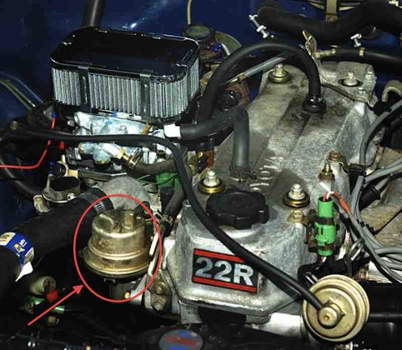

could the mechanical fuel pump that is attached to the head be leaking into it and therefore mixing with the oil

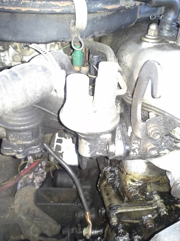

That could very well be because you gotta pump the hell outta the gas to start it. Its got a fuel pump on it I've never seen on a Toyota so is this stock?Name:  20130423_182533_zpsfabb346c.jpg

yeah, stock mechanical fuel pump on a 22r
its like about $89.37 from toyota online for the fuel pump
part number 23100-39336
but I would call toyota and give them your vin # to be sure that's the right one, and prob get the gaskets to

this is common in mechanical fuel pumps. my 87 dodge did the same thing when i first got it. it was hard to start after it sat a while. the diaphragm that separates the gas from the oil gets small holes in it.
make sure you clean the surfaces well with carb cleaner and to change your oil
and if it isnt that....when was the last time you changed the fuel pump anyway?
