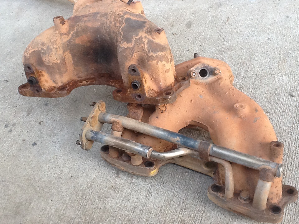

Answered my own question
Sooooo....upon further investigation, I found that they are not totally compatible.
Even if I drilled out a center hole (and with my luck it'd probably break) the air tube ports are different. Found this little gem at the pick n pull for $37 bucks. Trucks odometer read 134xxx something so hopefully I'll get a few miles on it before it cracks like a few I've had in the past.
Thanks for the replies. All imput helps.
