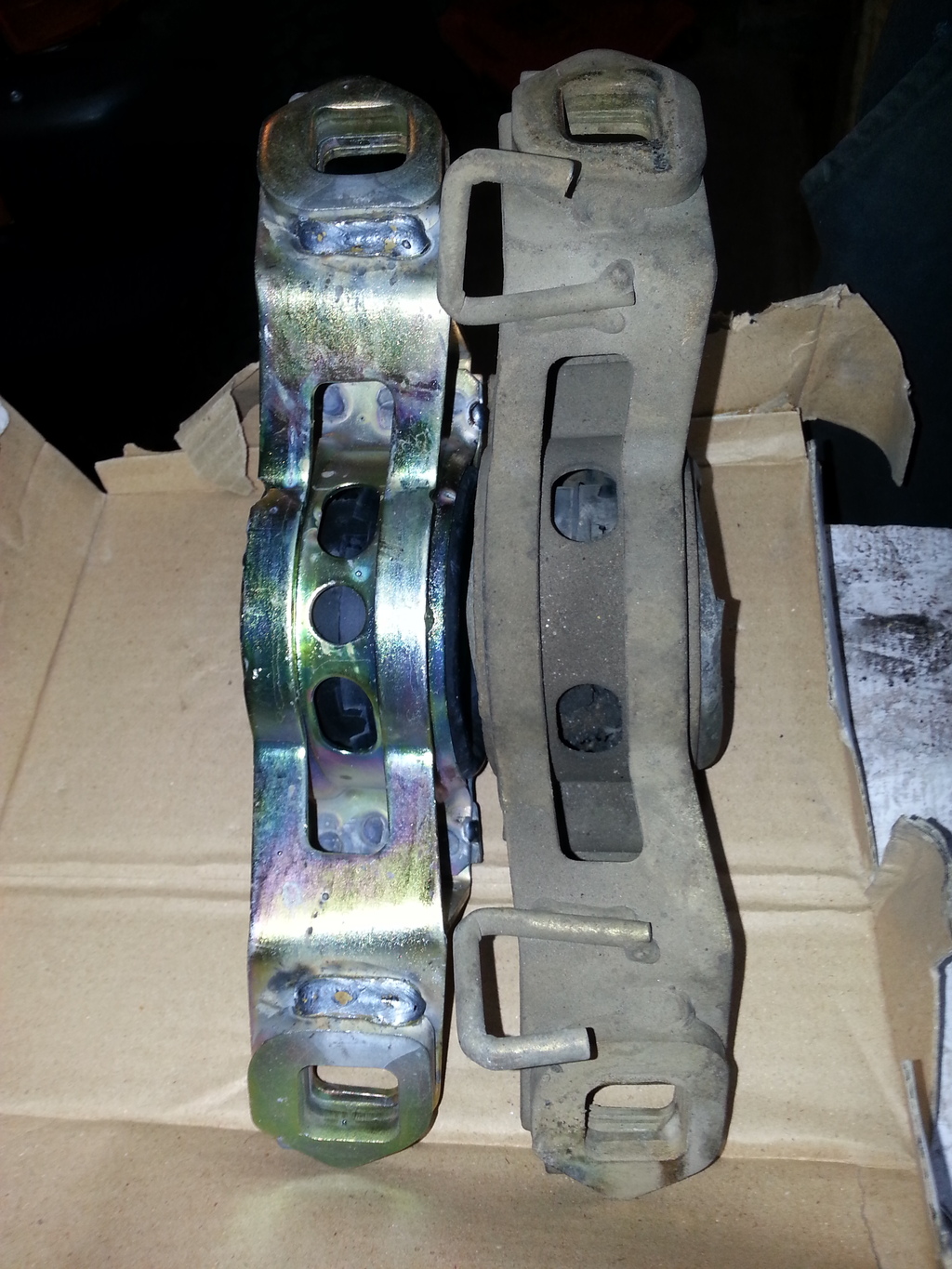

Resurrecting this thread - carrier bearings are now available for $22 on eBay, and so just to see how long one lasts/be a guinea pig, I bought two. Installing the 1st one today. I don't cheap out on parts, but I just had to try a bearing for $210 less than Toyota wants
I've read on pirate that any 2nd gen standard cab long bed 1-piece rear driveshaft will work as a substitute. Wonder if others know about the veracity of this.

$22 center support bearing
Looks pretty good at first. Looking more closely, the welds are not as good as those on the 6-7 year old bearing - there is as much - or more - material welded as on the old one, but the welds are not done as well. The angles are the same. Metal thickness is the same. The bearing race is just the way it should be - not too tight or loose.
"Matchmark all flanges." It all went on smoothly and spins very well. Torqued the (old/miraculously saved) 24 mm nut to 134 ft lbs, loosened, torqued to 51 ft lbs, and staked the nut per the manual. That nut is supposed to be replaced: we'll see. 54 ft lbs on the driveshaft bolts. 27 ft. lbs. on the 2 bearing mounts.

FYI my $27 rockauto el cheapo center support carrier bearing has about 10k miles and is all good so far.
Main issue replacing these things is to mark the splines before you remove the old one or the drive shaft will be "out of phase".
