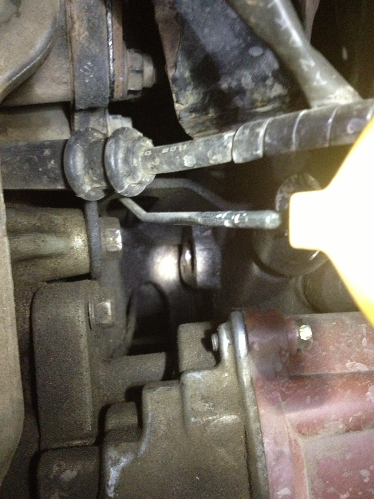

So I'm leaking what I'm 99%sure is ATF from the power steering pump but I can't tell 100% with the pump in the truck. So I was Hoping someone who has been here before can help me. The leak looks like it's coming from a plug hole where the spot of the light is and the leak is really worse then it looks lol.

Yes. Order a rebuild kit from autozone. It's about 15 bucks. I believe there is an o ring on the shaft that runs through that bore its leaking from

Thanks that's what I was looking for just making sure since I can't see in that hole from any angle while its on the truck

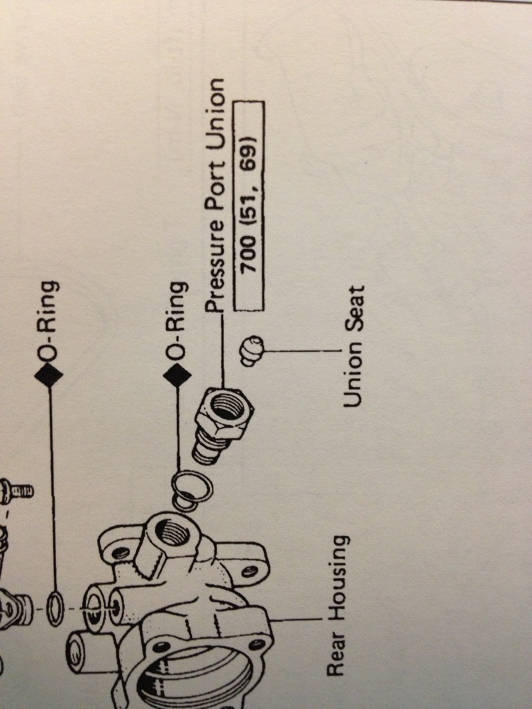

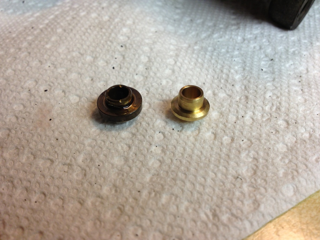

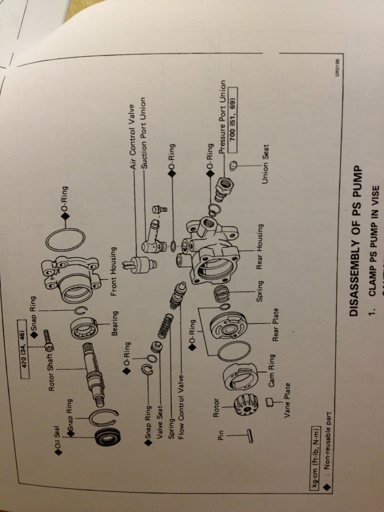

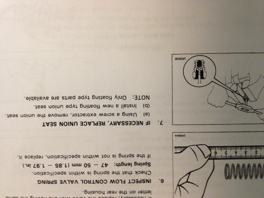

Also the brass piece that comes in everyone's kit is the union fitting. Well I removed my old one and my new one is a much different size and in the fsm it says only "floating" replacements are available does this mean it just sits in there like that? Kinda seems easy to loose that way when changing out high pressure power steering line .
